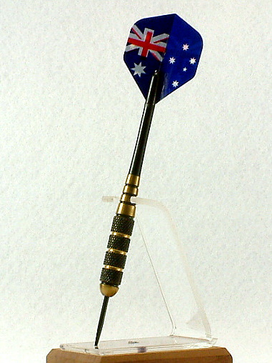

Brad,
I have followed with great interest your pen making using Alumium and I fully appreciate how you have succeeded so far your design is unusual however the way you went. I can tell you by happenstance how I came up with my brass knurled pen made from three competition Darts and with your approval enclose a pic as I dont know how to do this on a pm. I also fitted two brass tubes for accuracy of fit since yes I do not have a set of reamers. I made this for a Dart player to mark his score cards. To follow up9 please show a brass knurled one) and yes the coincidence re spacing etc is uncanny.
Kind regards Peter.

Jeff,
Many thanks for taking the time to post, constructive critisism is always welcome :smile: I'm inclined to agree with you, with regards to the black & gold + the aluminium, prehaps this would look alot nicer if i were to anodise the aluminium black to tie the colours in? Everyone's thoughts on this would be most welcome.
With regards to the prominant centre band, I prefer that on the americana pen, due to the top piece being significantly larger than the bottom, with the centre band over lapping the bottom. I guess thats down to personal preference. one of the good things with pens, it would take quite a few million pens to cater for all
Peter
Now thats an impressive set of darts and a very nice pen :smile: , again, it leads me with more temptation to anodise mine, so thanks for sharing the images they are most welcome.
