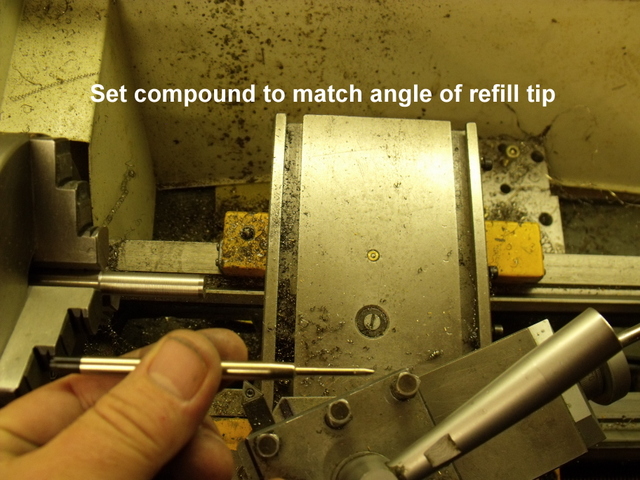

For a really long taper, turning off center is a solution. For something the size of a pen front section, just setting an angle on the compound is a whole lot easier. That way you don't have to monkey with the tailstock (which is not a precision adjustment on the "value priced" chinese metal lathes).

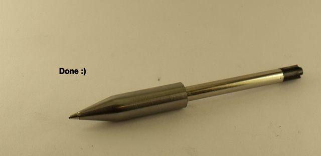

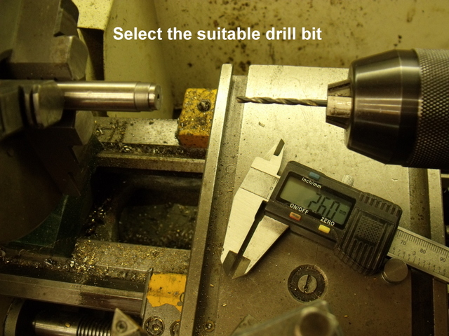

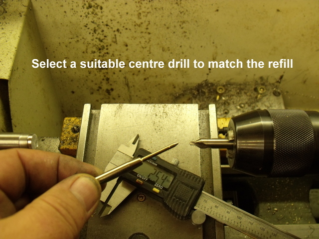

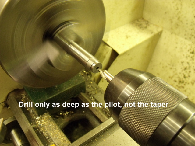

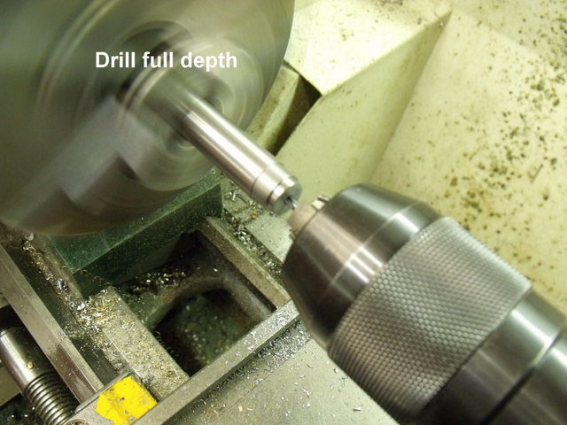

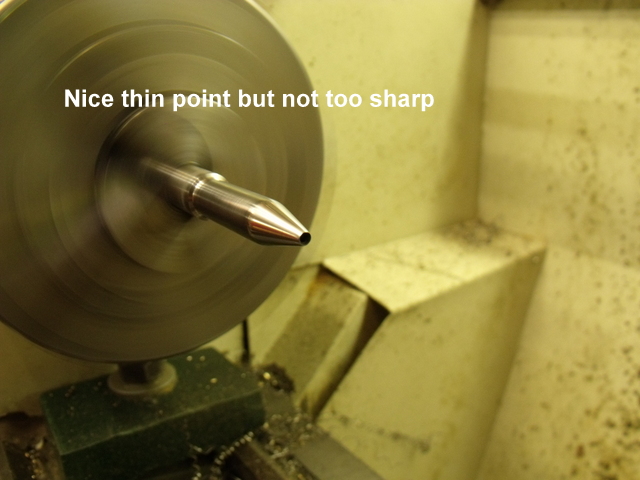

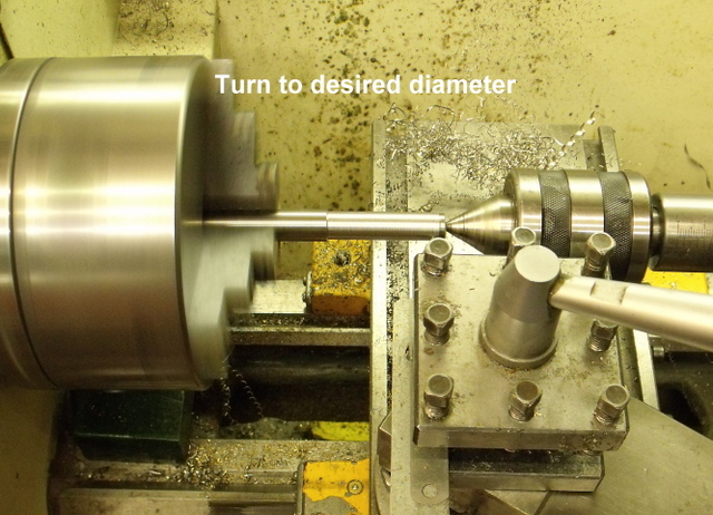

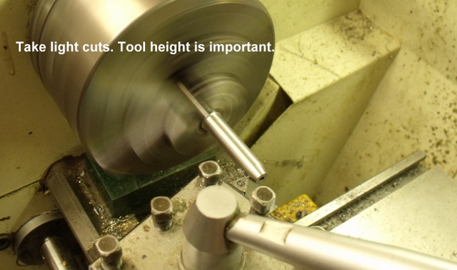

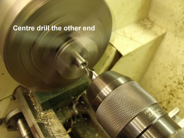

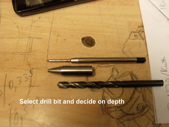

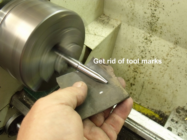

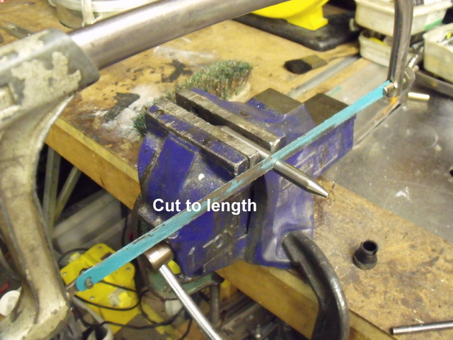

As promised, here's a set of quick and dirty pics. I just did these in a piece of stainless. Don't be scared of stainless. It's beautifull to work with once you show it who's boss!!:wink:
Once you get into it, you will spend more time selecting drill bits and deciding on drill depth. Here I only used two drill bits but normally would use at least 4. You may aslo want to include threads etc, but that is a seperate subject.
One of the most important things about cutting tapers is that the tool height MUST be correct. :wink:
Have a go and have fun !!:biggrin:

Ray, it is a 60deg cutter but not specifically a thread cutter. I find these are great for quick rough cutting. When I want a better finish, I prefer using a fresh HSS tool.

Russ, you shouldn't waste the ink :biggrin: If you can understand the process then you are more than halfway there. It isn't difficult, you can make it more and more complex as you progress though, but that is what makes it enjoyable.:biggrin:
Skiprat are you matching the angle of the tip of the refill.
I try to. I just eyeball it though. I also try and make the refill protrude so that the angles line up too.
