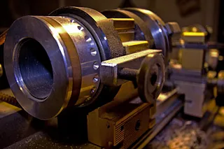

Only advantage a Taig lathe is if you buy one with the big bore spindle . which is 13/8 ID.
And the indexer .

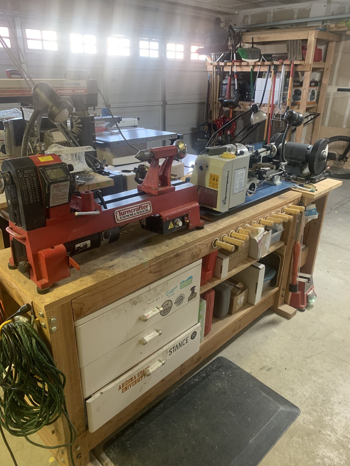

I did much research on metal lathes when I was in the market for one, and decided to go with the LMS 7350. I considered some larger lathes but the footprint of the LMS 7350 suited me best (see the photo). While the LMS was not the cheapest, I found it to be the best value. There were three intangibles that confirmed my decision:
1) Little Machine Shop's customer service. I have always been able to call them a talk with an actual employee who is knowledgeable about metal lathes. They have helped me through some issues and provided good advice. They also made followup phone calls back to me.
2) The carry all the parts for their machines which can easily be ordered should you need to replace one. I have heard this can be an issue with other brands of lathes.
3) There are several Youtube videos by Frank Hoose on setting up and using the LMS 7350. Frank is an experienced machinist and gave the LMS 7350 a good review.
You will still have to regularly maintain your lathe which in my opinion should be done anyway (take care of your equipment and it will take care of you.) I have seen some negative comments on the LMS machines from folks who prefer to avoid the maintenance portion. Just want a plug and play.

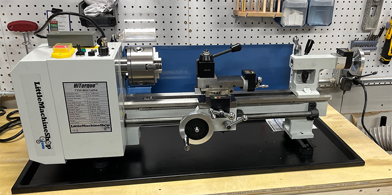

I finally received my LMS lathe yesterday and got it cleaned, set up, and working on alignment. So far, so good. I am not experiencing any of the slop I was reading about with the 7x lathes. All of the wheels/knobs are very tight, and I feel I need to do something to them to make them move a little smoother. I hope using the lathe will loosen everything up a bit, so they run a little smoother.
I am hoping to get some input on cutters. I purchased a set of 3 indexable cutters (product link) that came with an accessory package.
It also came with a cutoff blade and a 3/8 indexable boring bar. Any cutters that others would recommend?
I ordered a collet chuck for this lathe since my Beall will not work. Unfortunately, I ordered a 3-inch chuck by mistake and need to return it for the 4-inch chuck. Since I am doing this part over, is getting a 4-jaw chuck over a collet chuck beneficial? Or will both be necessary for different circumstances? I will only use this lathe for kitless and some minor metal turning for pen parts.
Anything else that is seen as necessary tooling that I may need? It seems the live center from my wood lathe fits in the tailstock and works fine. Same with my neilsniche tap and die holders I use with my wood lathe.
