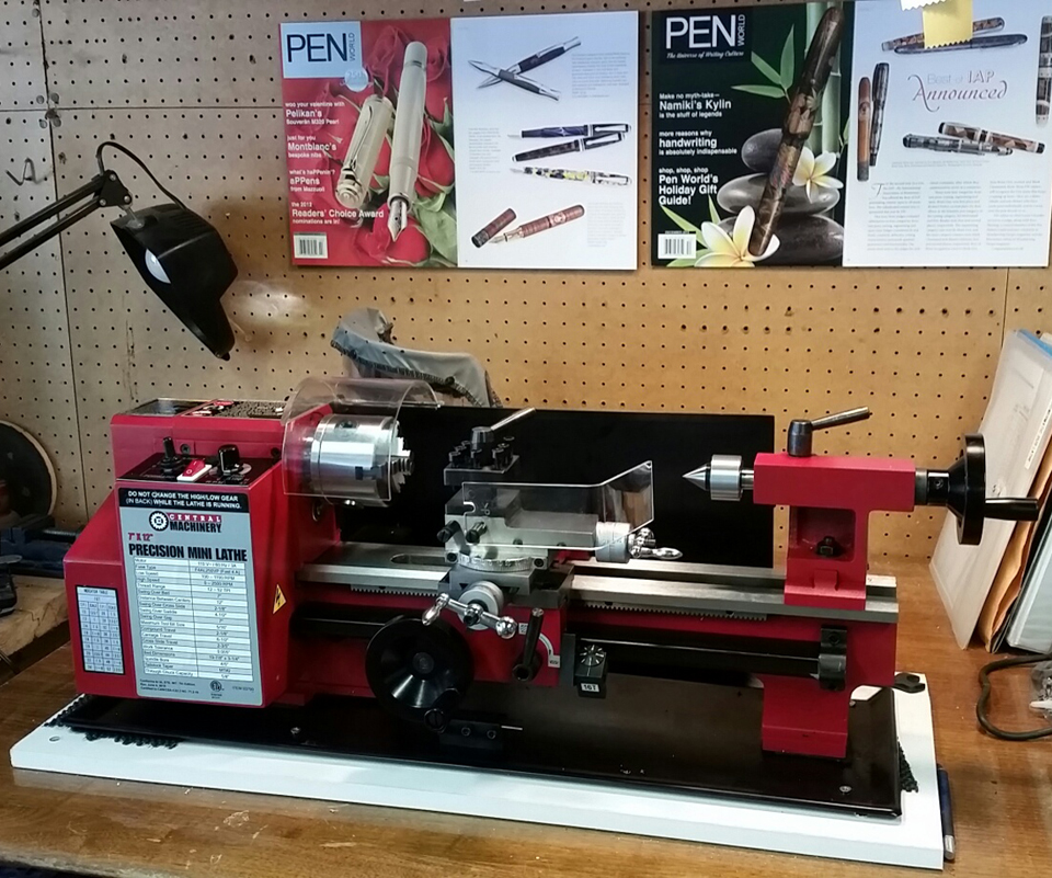

Well, I've taken the plunge.
I jumped at the HF 7 x 12 which was on sale and then had a 20% coupon.

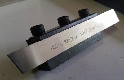

I have an HSS 1/16 cut off (see photo) - so I'm hoping that will be adequate

The 1/16 is .0625,it will work just wastes more material. That may or may not be a problem, depends on how much stock you have to work with. The delrin die holder was from George Butcher. The boring tool you will need to make accurate holes to thread. Not every tap has an exact match of a drill bit. Plus drill bits can wander and make larger holes than expected and be off center. I take it you have a center drill already as well.

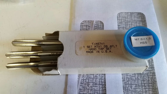

Taps and Dies I currently have:
M12 x .8 set // M10 x .5, .75, 1 sets // M9 x .5, .75, 1 sets // M8 x .5, .75, 1 sets
M7 x 1 set (see photo) (why did I buy these??)
M6.4 x 0.6 // M7.9 x 0.6 (I don't even know what these are for anymore) Nib section?
Recently purchased M9.4 x .5 with 7.4 x .5 for #6 Meister Nib fitting

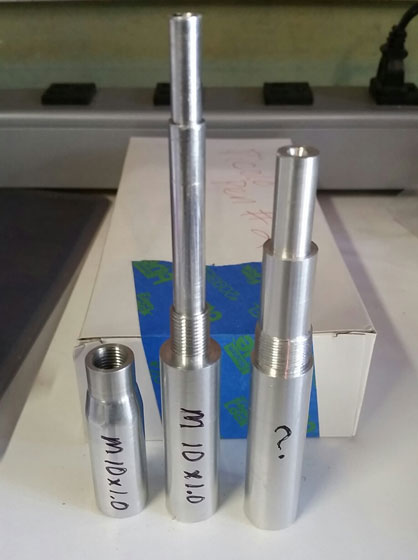

One set of M10 x 1.0 aluminum mandrels. (see photo) I assume the largest mandrel on the right is to hold a cap, but I don't have a tap for that thread size. (??)
The post replies are extremely helpful. Thank you very much!
Your taps and dies look good. I think the 6.4 is for Sierra transmissions.
Making your own aluminum mandrels with your taps and dies is a great project to get comfortable with the process. (Mine have a male end and a female end.) Then you'll be certain that they will work perfectly with your tools.

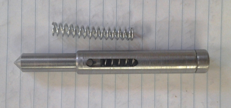

I also got a tap guide to keep things going straight and steady. Not vital, but nice to have:
Tap Guide, 2MT Short 3104 - LittleMachineShop.com

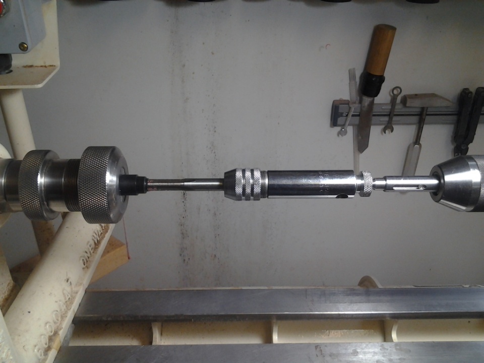

Not to derail too much but what exactly is a tap guide used for or how is it used? I've always just chucked the tap in a jacobs chuck and that's all I need to keep it straight and true. Looking at tap guide, I have no idea how it would be used.
Martin, your tap/die sets look good for most common sizes. You may find you need a few specialty sizes for various nib housings or transmissions, etc... but for the most part what you have is about spot on for the accepted normal. 9 or 10 for the grip section to body, 12 for the cap and 7 or 8 for any finials.
Carl, the point is spring loaded and fits into the back of the tap. As you advance the tap, it keeps a steady pressure on the tap, keeping going in a straight line. It gives you about an inch of travel.
When I hold the tap in the jacobs chuck, as I advance the tap, it pulls the jacobs chuck out of the morse taper. That causes the tap to go off center. I can compensate by stopping the process and advancing the tail stock, but I already have my hands full holding onto the tap and turning the headstock.

This is a tap guide that a friend made for me. It fits into adrill chuck and has a 1" throw. The back of it unscrews so that I can put in a heavier spring when I'm threading harder materials.
It works fantastic for me.

  • A Taper tap will have about 12-15 threads that are tapered and these are good for starting an thread and doing thru holes in hard metals.
  • A Plug tap has about 6-8 threads that are tapesed and are good general purpose taps.
  • A Bottoming taper has only 2 or 3 tapered threads and is used for threading to the bottom of a blind hole where a threaded part will go in the hole.
We are getting quite a vocabulary lesson in this thread :smile:
Thanks for this explanation. It helps me understand the set of taps that I have.:biggrin:
Where is the best place to get aluminum for making mandrels?
I honestly don't know what the function of the tap guide is. (to guide the tap dummy!:rolleyes: But I will look it up. I'm visual - so I can't see it in my brain yet. :confused:
The tap guide supports the back of the tap or tap handle, depending on how you use it. Sometaps have a dimple in the back that the tap guide fits in.
The front of the tap is supported by what ever it is your trying to tap and the tap guide the back, it also keeps it in alignment from left to right so it taps straight in. The spring keeps pressure forward on the tap so it doesnt hang loose as it threads into the material and to keep moving the tap forward so it doesnt strip out the threads its making.

Here is a quick pic of my guide. The guide applies pressure through the spring, automaticly advancing the tap. I grasp the tap holder in one hand and manually turn the lathe with the other. I can cut with and back out the tap simply by turn the lathes handwheel.
The guide keeps the tap aligned nd a contant pressure. I love it.

+1 for the LMS tap guide. Also, the spring loaded pin is reversible. There is a set screw on the back side holding the pin and spring in place. Back it out, remove the spring flip the pin over to expose a countersink and reassemble. Some small taps have a cone shaped end instead of the c'sink.
Get a die holder too, it's like the tap guide, it mounts into the tail stock and holds dies.
