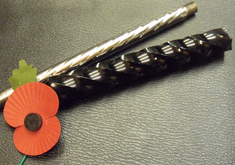

I've just cut a six sided spiral blank with a pitch of 108mm.
I'll post a pic here in a few minutes, if I may. You cannot do that with a fix gear lathe.:biggrin:

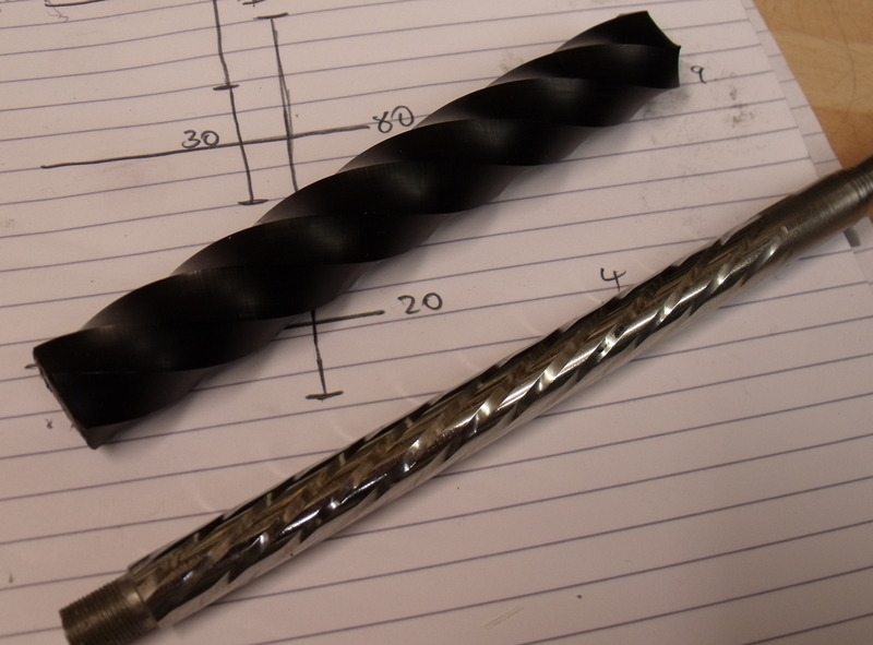

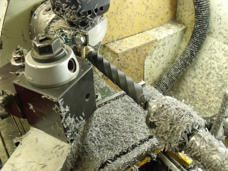

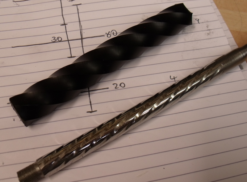

First off.... guess who now has to vacuum the house because he forgot to brush off the router waste from his clothing when he went inside to get his laptop and camera cable.......:redface:
Here are a couple of pics I just took. The black PR blank has six helixes ( before someone smarter points out that they are not spirals :wink: ) and with playing with the gears and adding one more, I managed to get it so that by cranking the leadscrew 36 times, it rotates the lathe spindle once.
Leadscrew is 3mm pitch, so 36 x 3mm = 108 mm
The stainless rod has 12 helixes with about the same pitch that I did some time back. I used a dremel with one of those mini cut off discs.
The PR is of course right handed and the steel is left handed.
Indexing is accomplished by disengaging the half nuts, rotating the leadscrew by 6 turns ( or 3 for the SS one ) then re-engaging the half nuts.
Of course...all of this MUST be done with the lathe unplugged. :wink:

Sheesh .... what an unconventionally messy little rodent ...
First, he goes and pollutes the perfectly nice thread on the internets ... then he goes and pollutes the house and gets the missus all riled up about the mess on her carpet ...
Naughty little rodent!
But nice work on those rods! :)
How you gonna polish them?

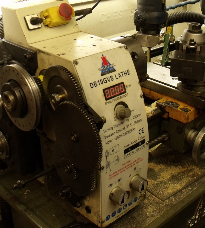

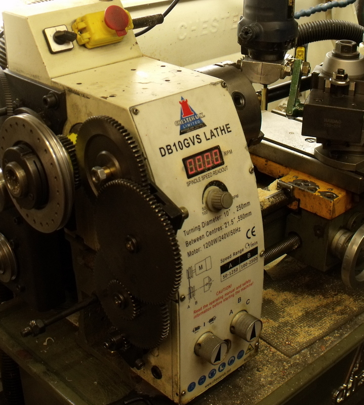

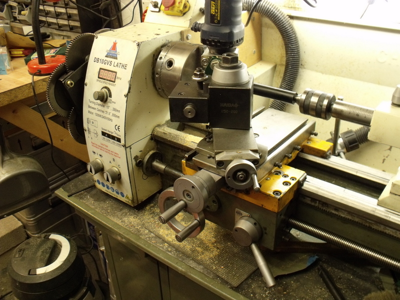

Perry,
Notice the nice quick change tool post on Skip's lathe:wink:
And Skip, that's a sweet indexing ring on the back of your spindle. I never noticed that before.
Of course those helixes are great!
Mike
Although Skip is absolutely correct about gears over a gear box, most of us wont go that far. We use the gear box to do thread pitches that are convenient and pretty much standardized for our pen making, .75..8,1 mm pitches. They pretty much cover what we do. In fact a lot of us will use a tap and die set on the metal lathe because the work involved in the set up to cut the threads is greater than grabbing a std size tap and die and making it work.
When setting up for threading on the lathe even with a gear box you may have to change your drive gear set up. Depends on the pitch you want to use and whether or not you have a metric or imperial (inch) lead screw. You have to put the outside or inside thread cutting tool on. Thats simple enough if you have a qtcp and the tool holders set up. You have to make sure your tool is square to the work, not hard but another place to err in. You have to be able to stop the lathe or turn the headstock by hand if you dont want to run into a shoulder at the end of the threads. I have a foot brake on mine that I can stop it with so I can control the end of the thread. If your only threading a 4mm or .160 long thread thats not a lot of time to react under power. Thats why even with a metal lathe alot of us still use tap and dies. Few of us will be able to make stuff like Skip does and the gear box is a great option for most of us that will never be more than home hobbyists that want to make a few parts and get on with making pens. If you do find your level is approaching that level you can always buy a bigger better lathe with gears. Its ok to have more than one lathe. :biggrin: Even a metal one. :biggrin:
Greg, with a decent router bit or Dremel cutting disc spinning at warp factor 5, they really don't take much sanding and polishing. I didn't sand either of these but put them on a buffer for less than a minute. You can still see the router markers but it really is easy to get rid of them by hand sanding.
Mike, I got the QCTP from Charlie ( New London 88 ) a few years ago. I love it but I made sure that my old manual tool post can be fitted in seconds. I cut and threaded the QCTP bolt to fit over the existing bolt.
I did the indexing on the spindle pulley ages ago ( 24 Indents ) because the stupid spindle final gear has a pretty useless 40 tooth gear. On my bucket list is to make a 48 tooth gear to swap it with. :biggrin:
