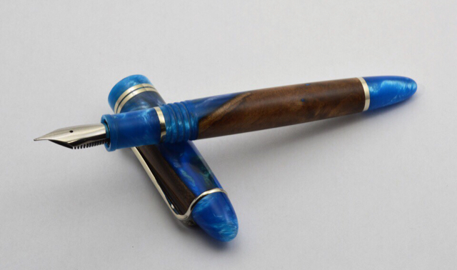

Here's a pic i saved.
The maker referred to by Patrick is jalbert.

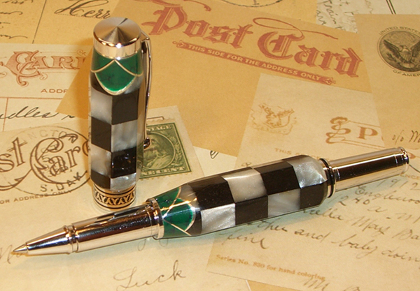

The picture attached is one of the last pens I made years ago. The scallops are sterling silver and jade and the body is ebony and Mother-Of-Pearl acrylic. I made it a heptagon (7-sides) because the guy I made it for wanted no doubt that it was one-of-a-kind.
When I spend this kind of time to make a pen, I don't want to be limited by anything, including sizes or crappy components. I'm a true pen lover (I own Pelikans, Parkers, and etc that cost me a fortune). I quit making pens because I was just so frustrated. I never made pens that truly measured up to the works of art I wanted to make.

I use mostly unbranded Jowo #6 nib units, but use a tap to cut the threads inside the grip for the nib unit. I have cut them using the lathe in certain scenarios where the hole for the nib unit is stopped and the tap would bottom out, but in general it's easier just to use a tap for that part. All of my other threading though (cap threads, grip threads, finials, etc) are done on the lathe.
As someone posted earlier in this thread, I have begun to gravitate away from the triple start threads for the cap threads, and use a square form thread instead. I've found it ideal because as it's one start, facets or grain will align perfectly every time the pen is capped, as opposed to 1/n chance of alignment with multi start threads.

PatrickR posted a photo of a beautiful piece of yours that seems to have the "square form thread" you are referring to. Is that correct? Surely that is more coarse than 12 TPI? How do you cut those?
Yep, that one is an example of one that has a square thread so the grain lines up. It's 12 tpi. If I remember correctly, it uncapped with about 1.5 turns. Most of the fountain pen community I've dealt with likes the turn count somewhere between one and two turns. Of course TPI isn't the only determinant of the number of turns. You can always cut some of the threads away inside the cap if you want to reduce the number of turns. I cut the threads with internal/external tools that I ground myself.
Wow, now I remember why I loved this site so much! You folks are just brilliant!! So, you have a single start thread that is secure and aesthetic because of it's wide, square profile. You are correct about the number of turns. 1.5 is about perfect for me. My favorite Pelikan has 3/4 and that simply isn't enough. I lost two shirts to it and finally stopped carrying it when it stained my car seat and a pair of jeans. I just checked my most prized Pelikan, which is like-new and it has about 7/8's of a turn. I'm sure that's what my favorite had at the start of it's life, but a decade of use wore it down to a scant 3/4. 1 full turn is minimum. I'm going to do some experimenting!
