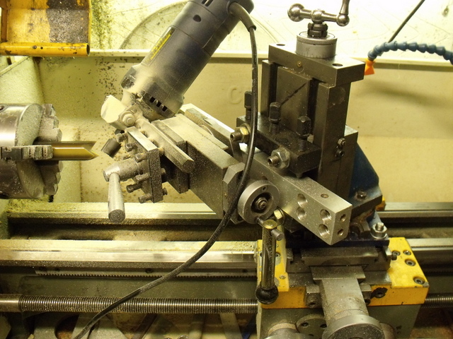

Here is a pic of mine about to start with a HB360 blank. It has a router mounted on the topslide, which is mounted on a piece of ally bar, that is held in a vertical slide. I eventually had to remove the tailstock even though it is a 21incher:rolleyes:
