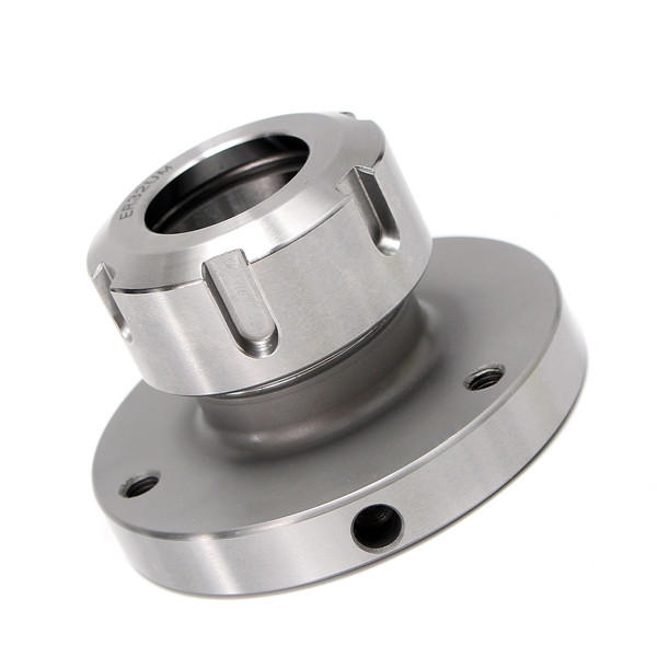

I've been turning with a 7x10 HF mini metal lathe for almost 4 years. Paid under $400 with a sale and coupons. My impressions: it is really a 7 x 8" lathe but I've been able to make it work for pens. The 3" 3 jaw chuck can be modified to pass up to 3/4" material through the headstock. I bored mine to 0.730" just short of the maximum. I turn my blanks round between centers to 0.73" and then hold recessed in the chuck to drill. This leaves plenty of room to drill on the short lathe bed. The motor isn't very strong but strong enough for hobby work, you just make lighter depth of cuts. I've turned aluminum, brass, copper, 300 series stainless steel, 440C stainless steel, O1 tools steel (annealed), and Stainless steel Damascus that was partially hardened requiring carbide for drilling and turning. All without any major issues. Go slow, use the right bit material and grind profiles, and the proper cutting fluid. I have some titanium and bronze to truly test this little lathe in the coming months.
A quick change tool post is a great add mostly allowing you to adjust tool cutting height without shims or grinding. HSS bits are a big help for better finishes on metals and a necessity for wood and plastics.
A recent modification was to add a ER32 collet chuck that gives me more length to work and the ability to pass 20mm (0.787")diameter material through the headstock. The collet chuck bolts to the spindle just like the standard 3" chuck. I've not used my 3 jaw chuck since getting the collets. It only takes a minute more to swap the collet than to mount in the old chuck. They hold more securely and accurately without damaging what they are holding.
