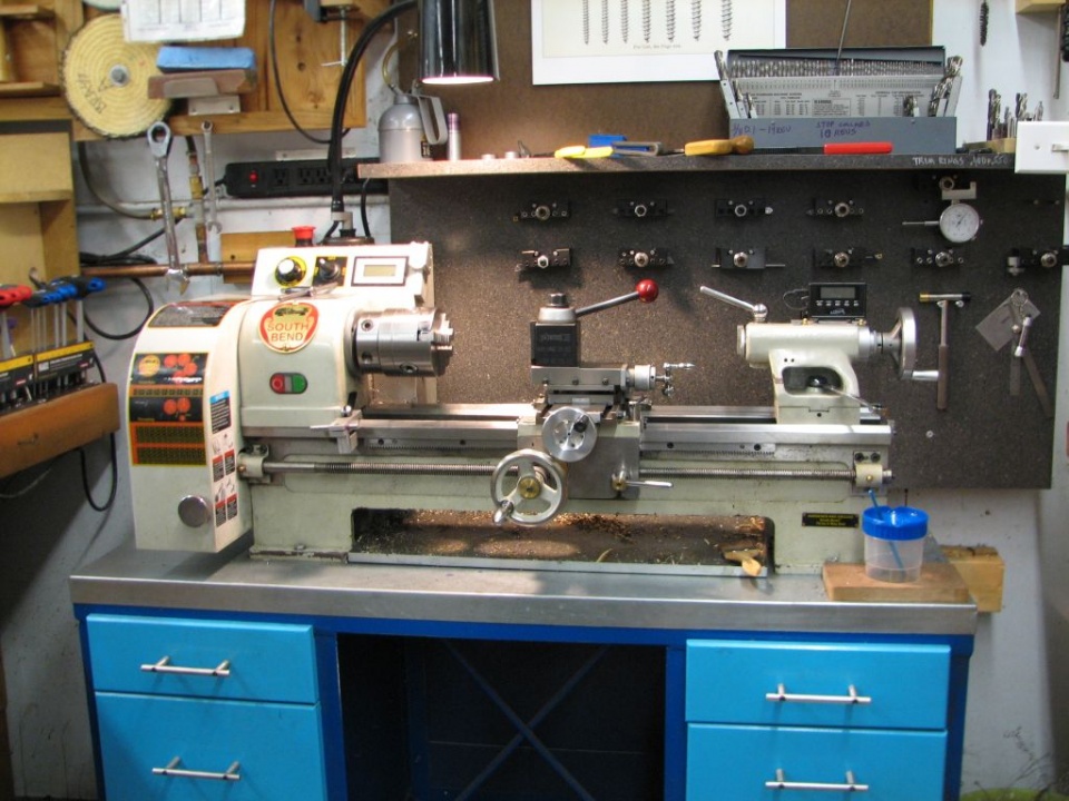

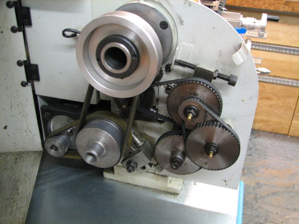

I've had the SB 1018 for 3 years now and I love it.....for what it is.
It's NOT for someone who wants to do a lot of threading, you have to change belts AND pulleys and it's a real pita!
It's also slow, the MAX feed rate is .005" per rev., that's a SUPER FINE finish rate on a big lathe.
The upside is it's accurate and it has a D1-3 spindle which makes changing chucks SUPER easy, about 30 seconds is all it takes.
I bought it because it has a 1" thru bore and a variable speed, I need the 1" bore for making 1" tool posts and the variable speed is, well..HEAVEN!
Here's a couple photos....
