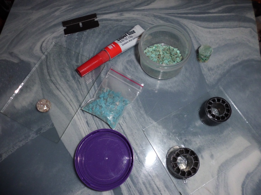

Second turquoise run ... open container has the crushed Kingman's Mine turquoise... finished blank to the right. The little baggie contains the Sleeping Beauty Mine turquoise that I'll be using for this run.
Bottom right are the 2 remaining molds ... the other 3 were destroyed as I unmolded the blanks.
Top left is my tools for cleaning the glass "trays"... just a razor blade. The molds are sealed on the bottom with a layer of hot glue. The cleaned tray on the left next to the CA tube has half a blank on it made from the crushed abalone shell. The other half is on the lathe.

attachment.php
Sleeping Beauty turquoise loaded up in both molds ... finished abalone shell blank in between. Remainder of Sleeping Beauty turquoise in the baggie to the left. I estimate I could make 2 more molds this size with what I have left in the bag.
Time to soak both blanks in CA and let em cure ...

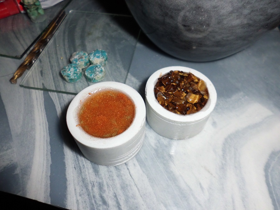

Still messing around with CA for the casting medium.
I've found that if I wish to mix pearl ex powders with my Harbor Freight CA, I need to add the CA first, then the powder, and then mix.
These are my new molds.... I went to Home Depot and grabbed a whole 10-foot stick of the 1.5" square vinyl sill material ... I have other uses for it that I bought it for, this is just some leftover pieces that I am working on my lathe for various miscellaneous projects.
They seem to be made with some kind of fiber fill or air bubbled process ... they don't appear to be pure PVC, like what I get from the water pipes. Not liking it for the lathe all that much, but it may work for what I'm trying to do ...
CA doesn't stick very well to PVC, so I'm hoping this stuff releases easily. After turning the section round, I drilled into the center with a 1" Forster bit. I then continued through to the other side with a 1/2" drill bit. I then made a plug by turning the same material to 9/16" thickness and tapering it down to just under 1/2". I fine tuned the plugs on my sander so that they would be nice and tight and level with the rest of the mold bottom. I also had made sure to go in with a square faced chisel and made the bottom level. This gives me a "knockout" hole and plug to use to get my blank out of the mold. I am hoping that this method will be reliable and reusable for some time, though I am planning smaller ones as well.
Top left in background, you can see the 4 prepped Sleeping Beauty turquoise blanks. Top right in background, my marble mortar and pestle.
Mold on left contains: Kingman's turquoise with pearl ex gold (I overfilled with CA intentionally, wanted plenty in there to mix with the pearl ex).
Mold on right contains: mix of gold pearl ex powder in the bottom, for hiding the bottom of the blank, and crushed Tigereye stone in the top, no pearl ex in top.
