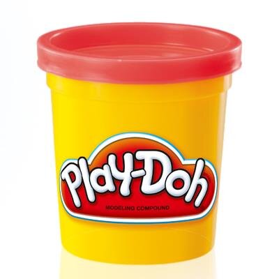

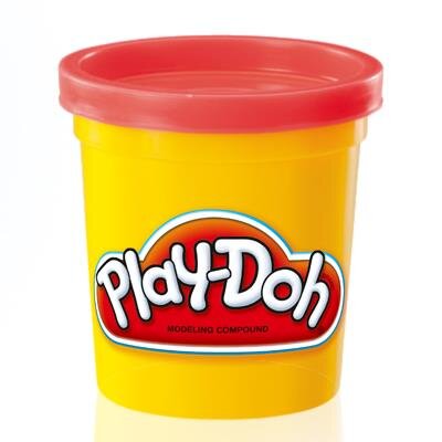

Before glueing in tubes I plug the ends of the tubes with play doh; polk a small hole on one end. Any glue/epoxy that ends up in the tube I clean out with a drum sanding attachment on a Drexel.

Never have that problem using Play Doh.
Les

Anyone used modeling clay or Play-Doh? You could wipe out the tube with a foam make-up swab. Acetone might cause some problems, though. Cotton swabs would leave fuzzies.
