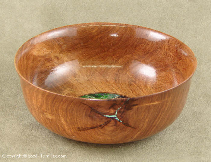

Side view with a crack filled with turquoise embossing powder and CA

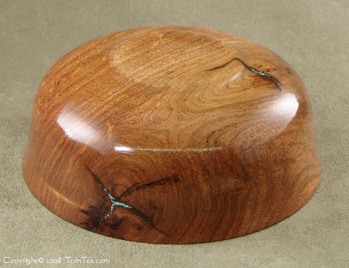

Bottom view

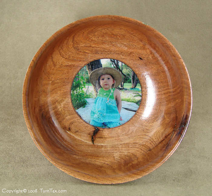

Now for the Twist!!
I turned the bowl to finished size and then turned a recess in the bottom. I carefully cut out the picture and used CA to adhere it to the bowl. I then took the bowl off the chuck and filled the bottom of the bowl with clear Alumilite and put in my pressure pot. Once cured, I put it back on the lathe and turned until all the Alumilite was gone from the bottom except a layer over the picture circle only.
The finish is not absolutely perfect since it is a CA finish and CA is REAL HARD to do on a bowl. I used CA because on bowls it makes a completely impervious and durable finish that you can actually use without damage to the finish or the wood.
Thanks for looking and for any comments, good or bad!
