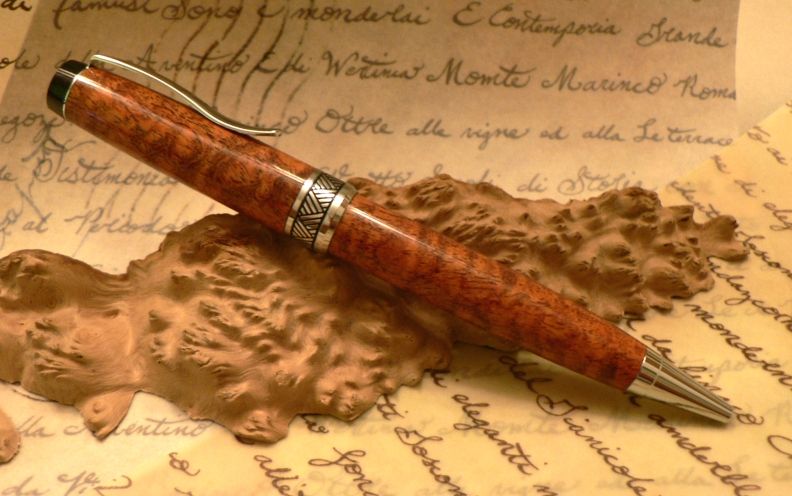

I've had good success with both CA or lacquer
Here is a curly mesquite finished with CA. I assure you, this quickie pic doesn't do the pen justice. I am still experimenting with my picture taking and I am in a hurry to go out...this pen will be given a way in a few minutes.

Paco, I've turned my share of Mesquite (being a native Texican I love the stuff!) and like James, I've used a variety of finishes with it. My preference is CA or lacquer. Yes, it does leave the pen with a plastic feel, but many of my customers prefer that over the patina that will come from a friction finish. Mesquite is also hard enough just to polish out on it's own and cover with a good coat of TSW (preferred) or Ren Wax. Just make sure the buyer knows that it needs to be waxed about once a month unless they want it the eventual grey patina that will come with Mesquite. And yes, the beautiful red grain will grey over time. Just not as quickly as some that turn. It's still too early for me to know if CA or lacquer will prevent or further retard this process, but I'm hopeful.

<br />Thank for the additional info Billy. I was unaware of Mesquites tendency to go gray.
ALL wood will eventually turn gray. Some just get there faster than others [;)]
