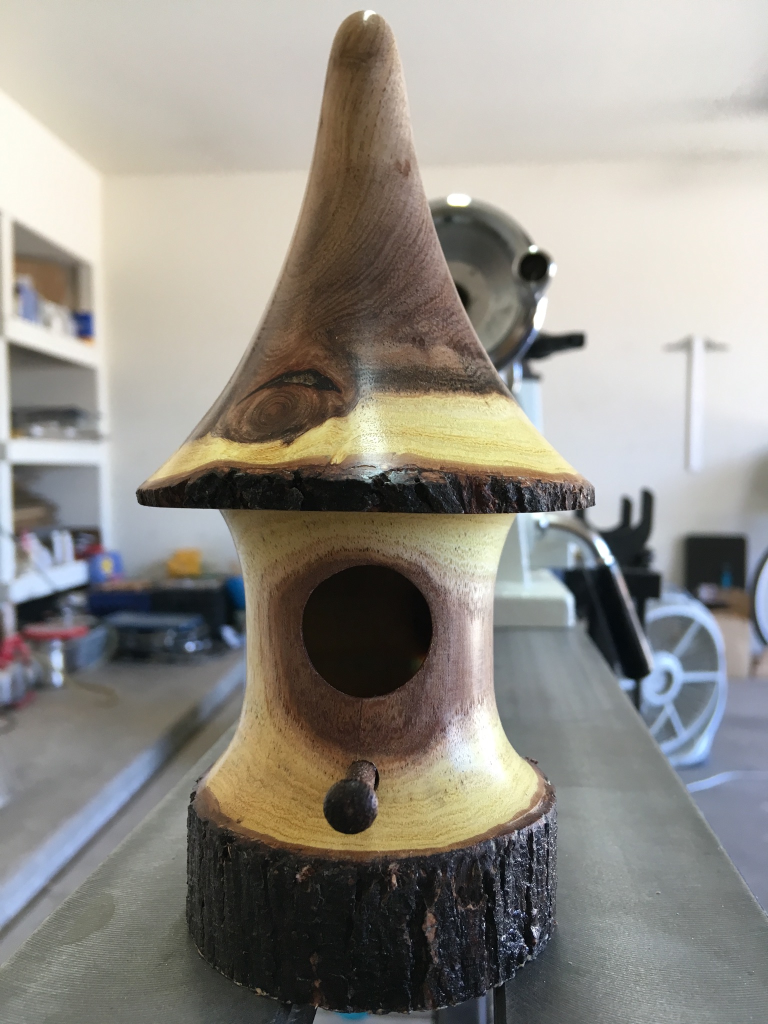

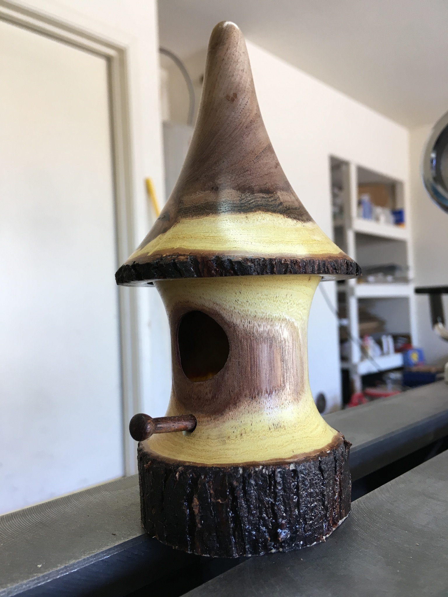

My first birdhouse and it was a comedy of errors, which means I learned a lot. The next should be much better. Stands about 6.5" tall and the widest point which is the base of the roof is around 3.25" or so. I drilled the top so I can hang it in my palm tree which may or may not happen. Even with all the mistakes I'm satisfied with the result, and it was a lot of fun to make which is what really matters.

Thank you, and give it a try! These are actually pretty common and IMO are just a variation of a lidded box. If you make a small one you can just drill the body with a forstner bit and not have to mess around with hollowing it.
Very nice. I like the colors and the natural bark edges. Yes, these little buggers have a few steps that are easy to mess up.

Thanks Mark. The most important thing I learned is to take notes when watching a video of how to make something instead of relying on memory...
Now what was I doing?
I agree with Mark as I have made bird house for some time, and natural edge one can be a pain, by the way great job.
Thank you! I like the natural edge look but it was a little more difficult than expected. The bark wouldn't stay on the first two bodies.

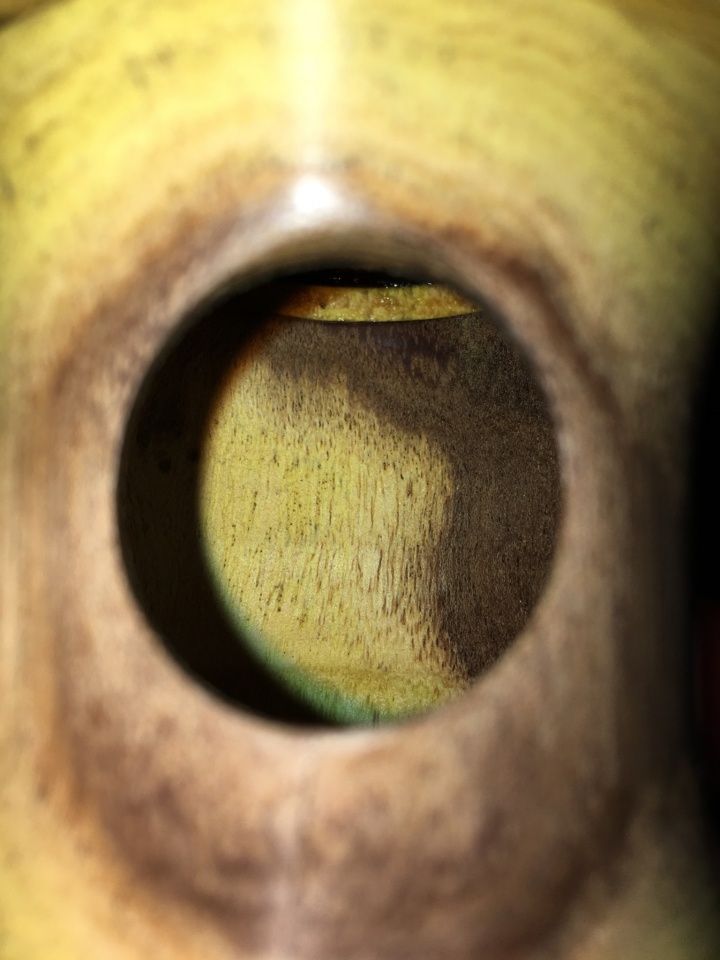

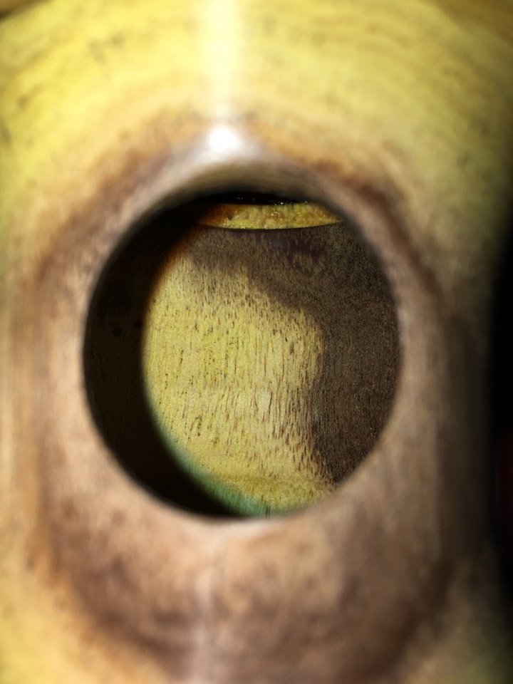

Very nicely done, Jay !!! . BTW, could we see inside, please :biggrin:
Would kinda like to know the square footage !
Thanks Mal. I drilled it with a 1" forstner then hollowed the rest with a sorby hollower. Sanded to 400 but I realized after taking this I forgot to put any oil on the inside! One more lesson learned. I estimate it to be about 8.8 cubic inches interior living space. Comfy for a finch or spacious for a hummingbird.

Thanks Steve. Mike Peace has a few videos and definitely explains the process better than I ever could. The main problem I had was that I drilled the hole for the perch where it curves, that proved to be a huge mistake. I made a nice perch that was beaded where it butted against the house which caused it to stick up at about a 45 degree angle! Turned a plain one, reamed the hole - too large as you can see in the pics - and chose to live with it. The one thing I did different is Imused my chuck for everything instead of a jam chuck. Me and jam chucks have never got along...
