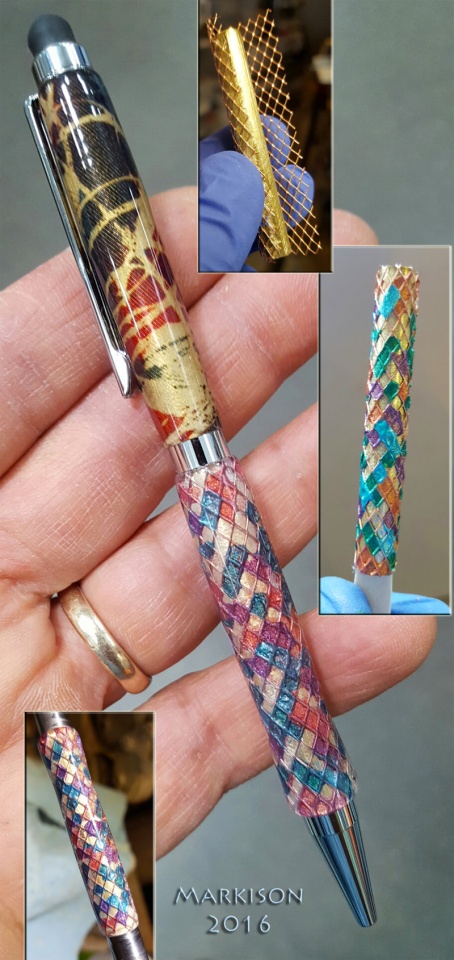

This is an experimental pen - top is Batik (wax resist hand-dyed 8mm Habotai silk) and the bottom is copper mesh with pearlescent acrylic paint. Not a good color match, but does relate the Batik "color cells" to the mesh-delimited color diamonds (for future experiments). The technical challenge was to very quickly wrap the copper mesh around the well-sanded CA coated brass tube, quick CA accelerator spray, then release quickly to avoid spending the day picking glove fragments out of the mesh. Painting was simple - dowel to stabilize the tube, colored with Jacquard Lumiere pearlescent acrylics. Next step was tube-in pressure casting with PR, followed by careful turning (more fun ahead, can foresee some interesting cloisonne-style enameling-like possibilities):

The "mosaic" mesh look is simply fantastic. Are you sure that you're not a creative mad scientist rather than a surgeon? Your work is so varied and inspirational as you really present some very creative challenges. Please continue to share your work with us.
I have long been designing a type of "stained glass" pen blank in my mind. This is inspiring. Not quite what I had envisioned but it is close.
Love that idea! Looks great!

Nice looking pen! In fact - I purchased that same mesh material from the hobby store just last week and soon came the same issue - getting it glued around the tube lol.
My plans are bit different than yours, but I like your idea! really cool.

My plan for the next copper mesh wrap is to cut the mesh rectangle, then CA glue an edge onto the alcohol ink-painted tube (setting the glue quickly with a tiny bit of Insta-set accelerator on a sheet of non-stick parchment paper); then wrap & glue the remainder of the mesh around the tube; paint the mesh interstices with dimensional acrylic or tinted PR; then cast with a tube-in mold, etc.
