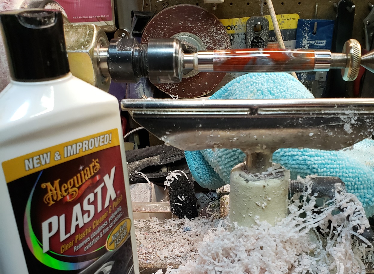

If anyone uses any of the meguires along with buffing wheels...how do you go about it...put polish on the pen or on the wheel ? Or ?
I put together a three stage 8" wheels setup using Tonys library tutorial..I haven't been real pleased with the plastic polish blocks caswell sells..p22 I think, they have been out of the other one for a while , I had good results with plastx but I want to use my buffing system I built

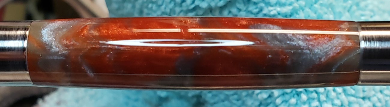

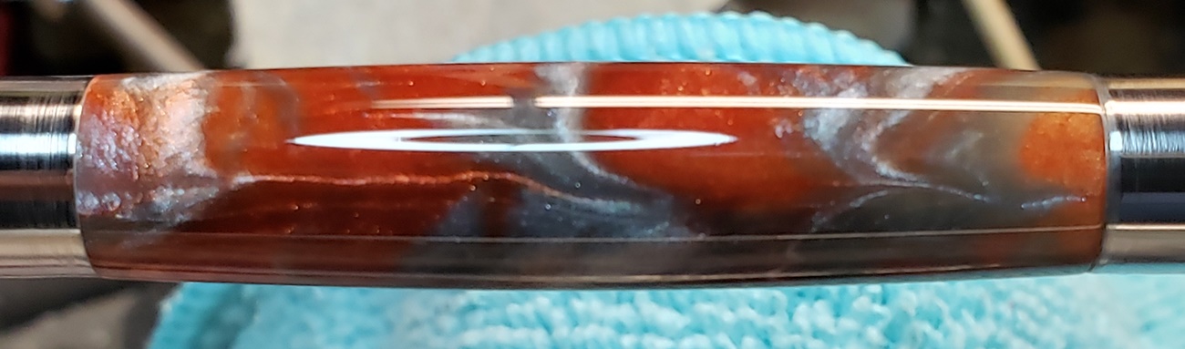

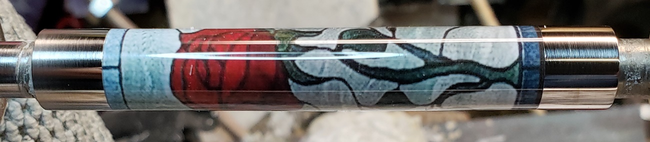

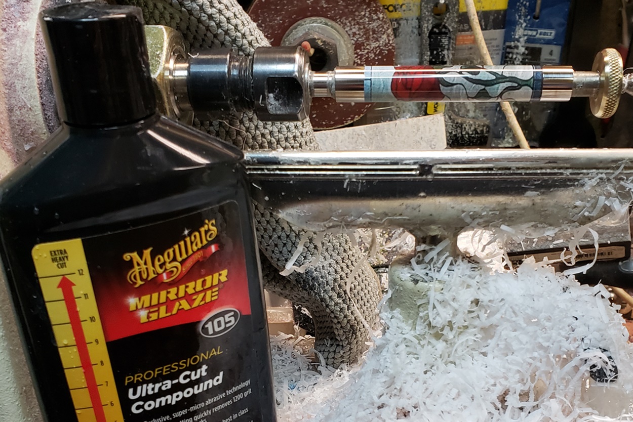

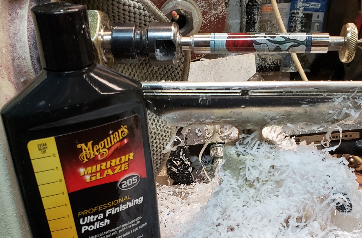

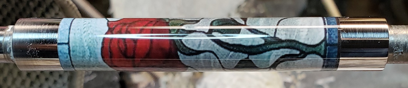

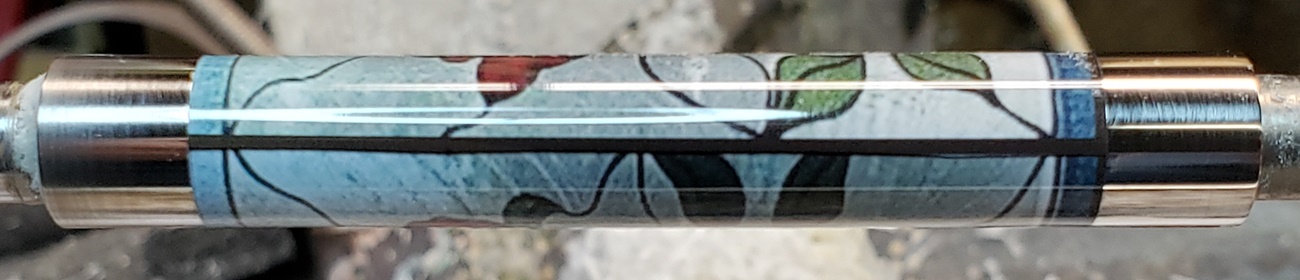

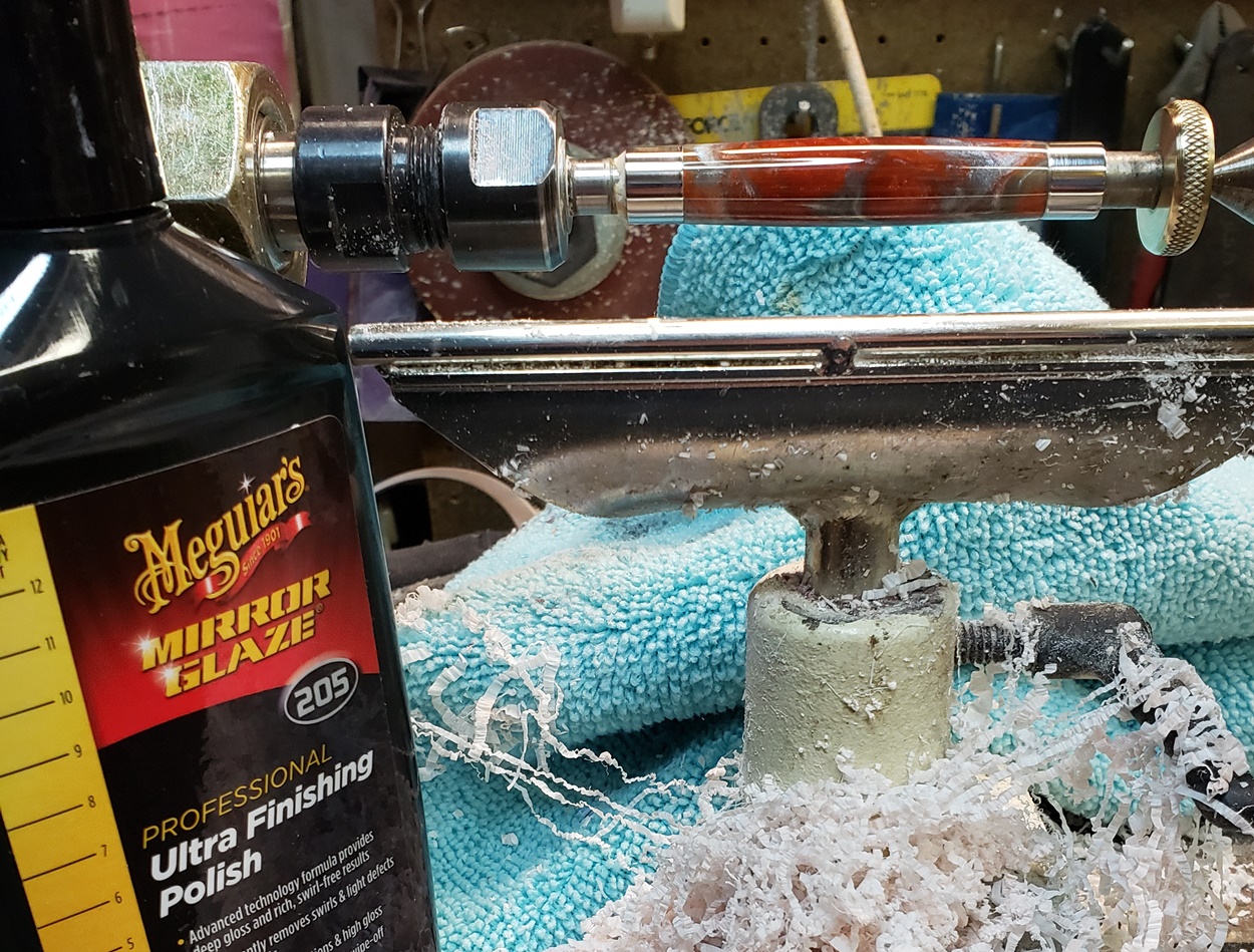

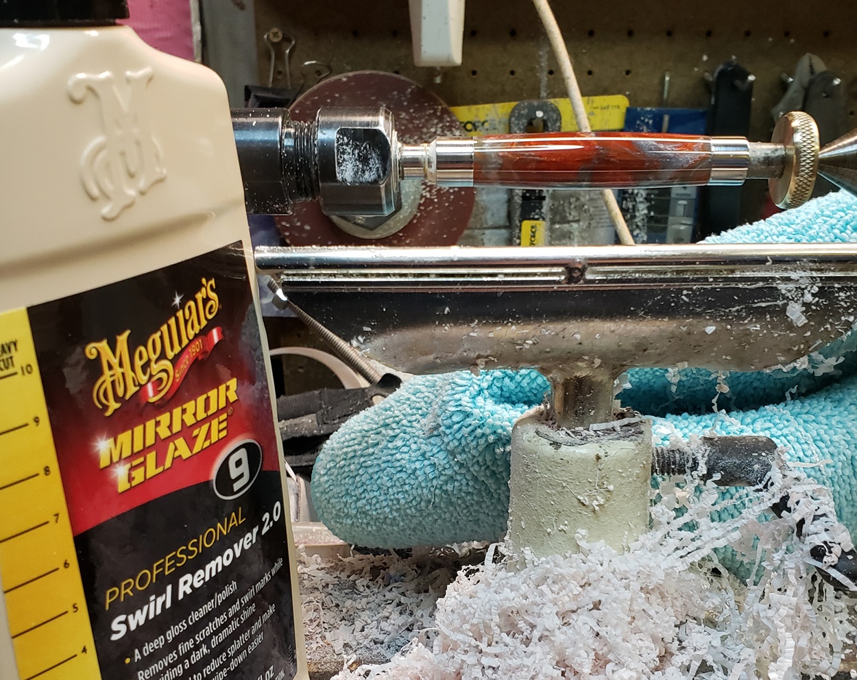

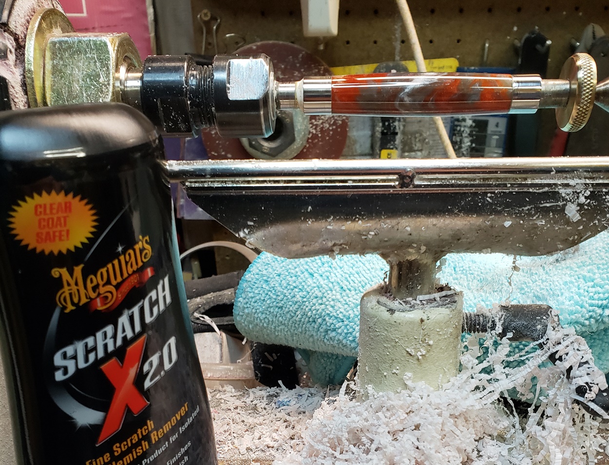

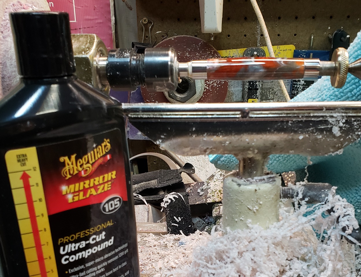

I tried the Meguiar's recipe on a new blank today. First, I used all six grades of 3M Tri-M-Ite polishing paper. I think I like it better than Micro Mesh.
Then all five of the Meguiar's polishes. I can't see much difference. I think I agree with TonyL, 105 followed by 205 would have been enough. I also think the preparation before the polish (Tri-M-Ite) is the most important step.

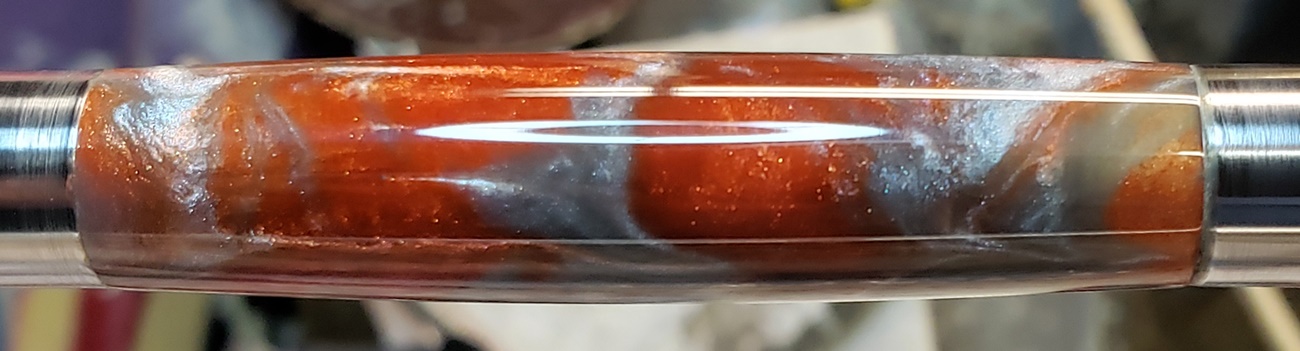

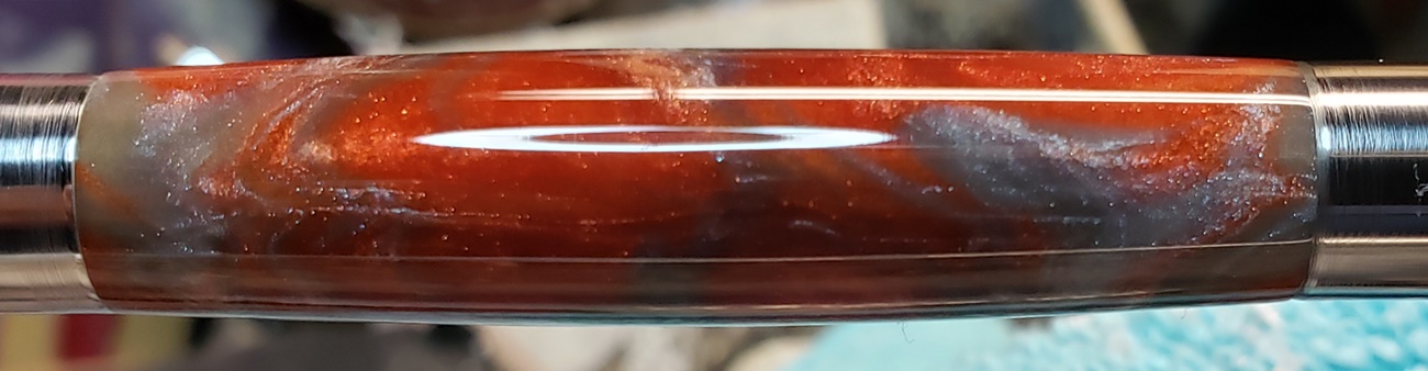

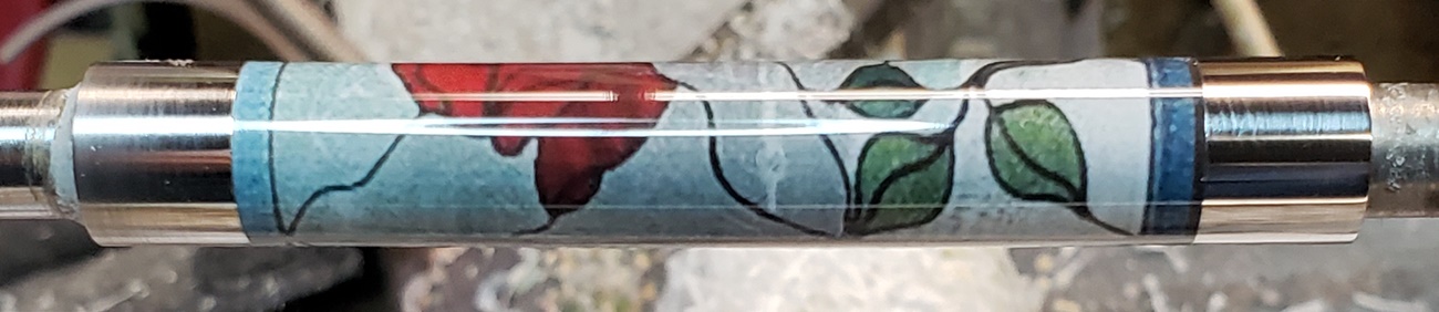

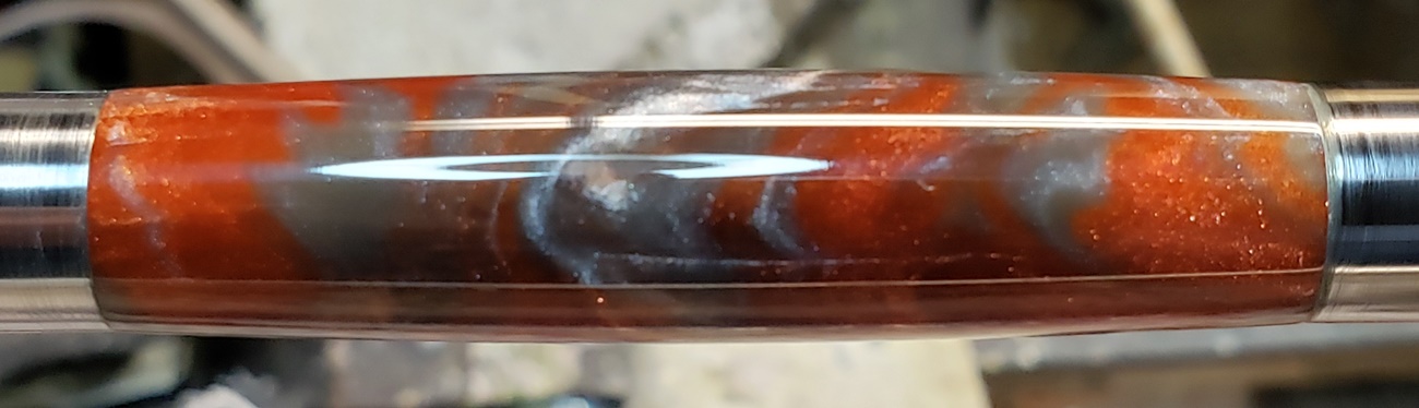

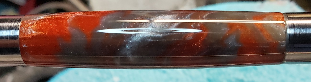

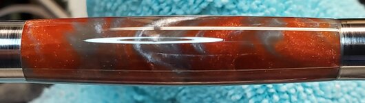

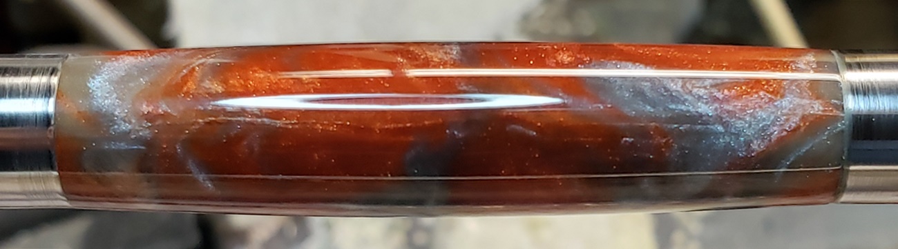

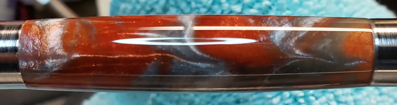

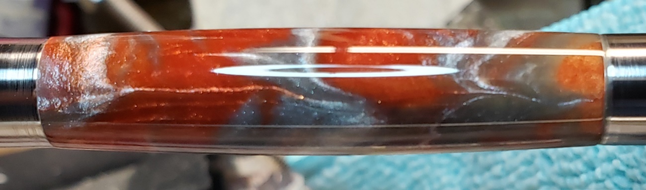

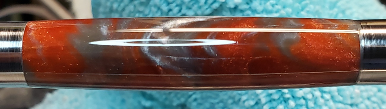

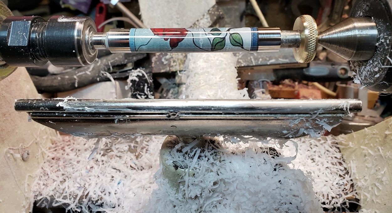

I just finished this one. I used 220, 320, and 400 grit wet; all six grades of 3M Tri-M-Ite polishing paper; then Meguiar's 105 and 205. I can still see a very few micro scratches in the closeups, but not with my eyes. I might go back and hit it with all five Meguiar's products just to see if there's a noticeable difference. Yes, I'm anal. LOL

Nice job on the finish. I don't see any scratches even on the closeups. I do see a bit of debris on one of the pictures but that was it. My feeling is if you can't see the scratches with the naked eye probably no one else can. either But....you have to be satisfied with your work.
Yes, I'm happy with how it turned out. At this point, it's just curiosity. I want to see if there's a difference, or if I can get away with only using 105 and 205.
