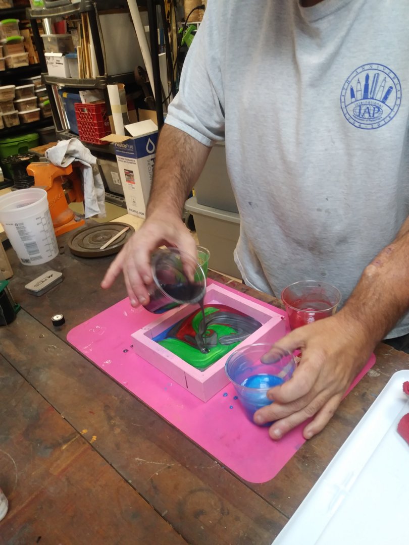

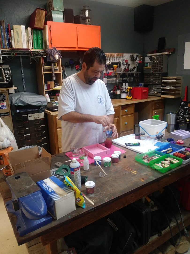

Despite non stop rain, we had a few show up for the meetup. Mike Drake was gracious enough to let us use his shop. We had an in depth conversation on Resins. And we mixed up a 4 color PR pour. Chuck also demo'd water slide decals. Afterwards we ordered some Pizza and told a few lies 😀 it was a very fun meeting. And im looking forward to the next one.

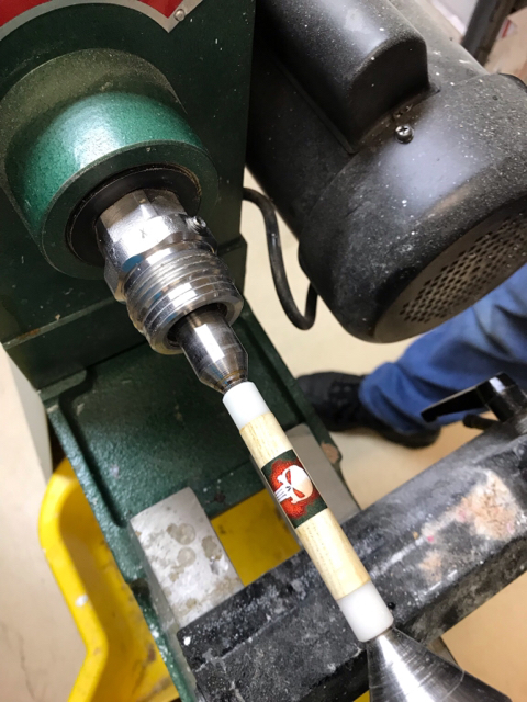

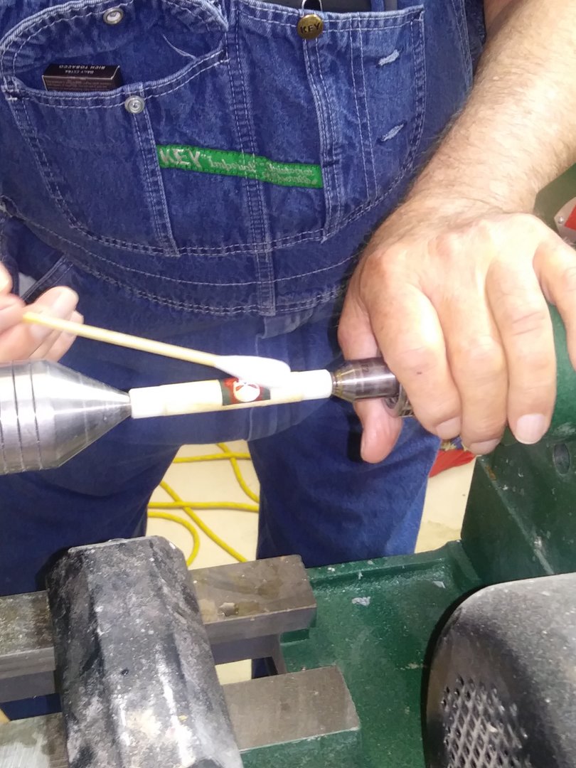

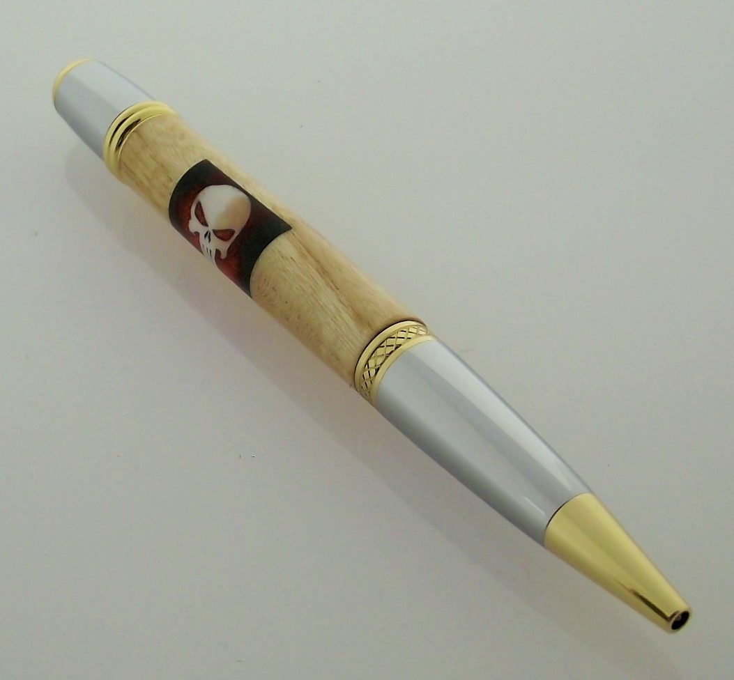

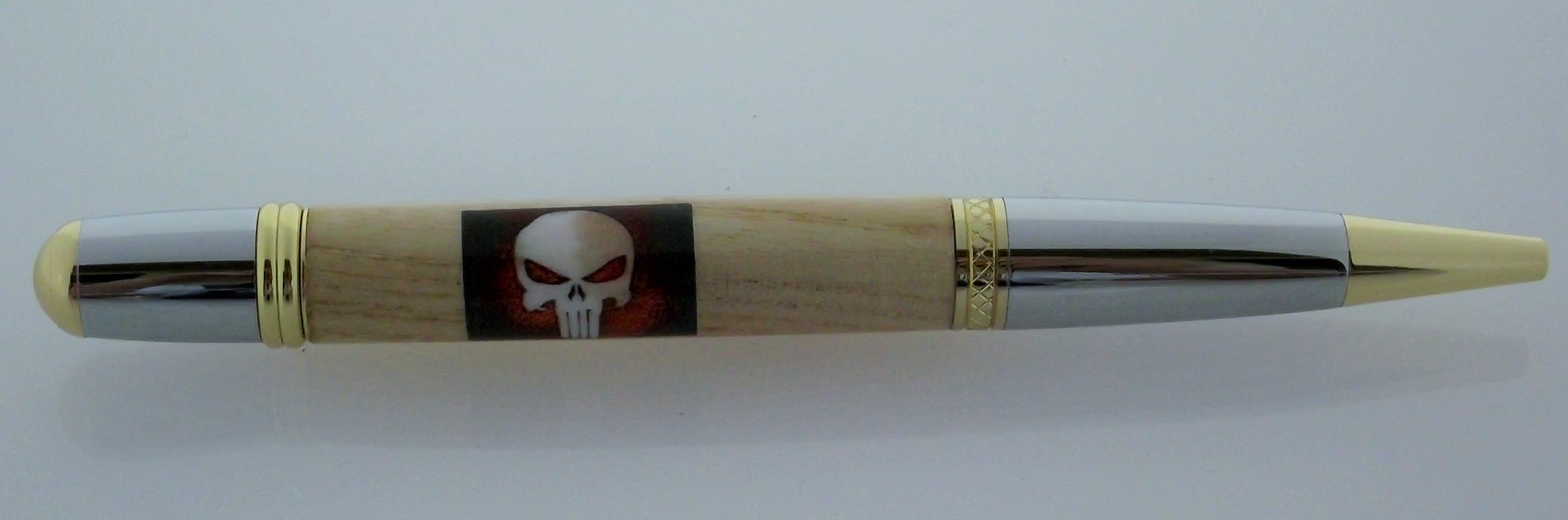

A close trim on the water slide decal

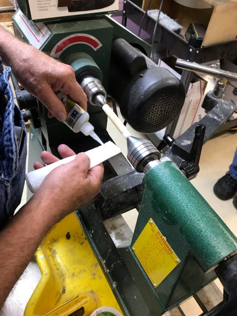

Chuck putting on base layer of thin CA for decal.

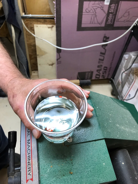

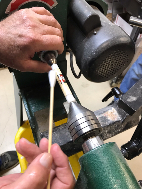

About 6 seconds in the water
Getting bubbles out with a cotton swab
Decal on the maple blank

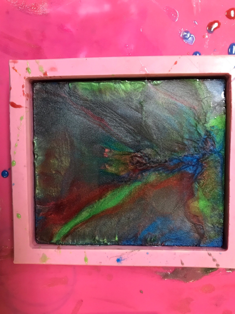

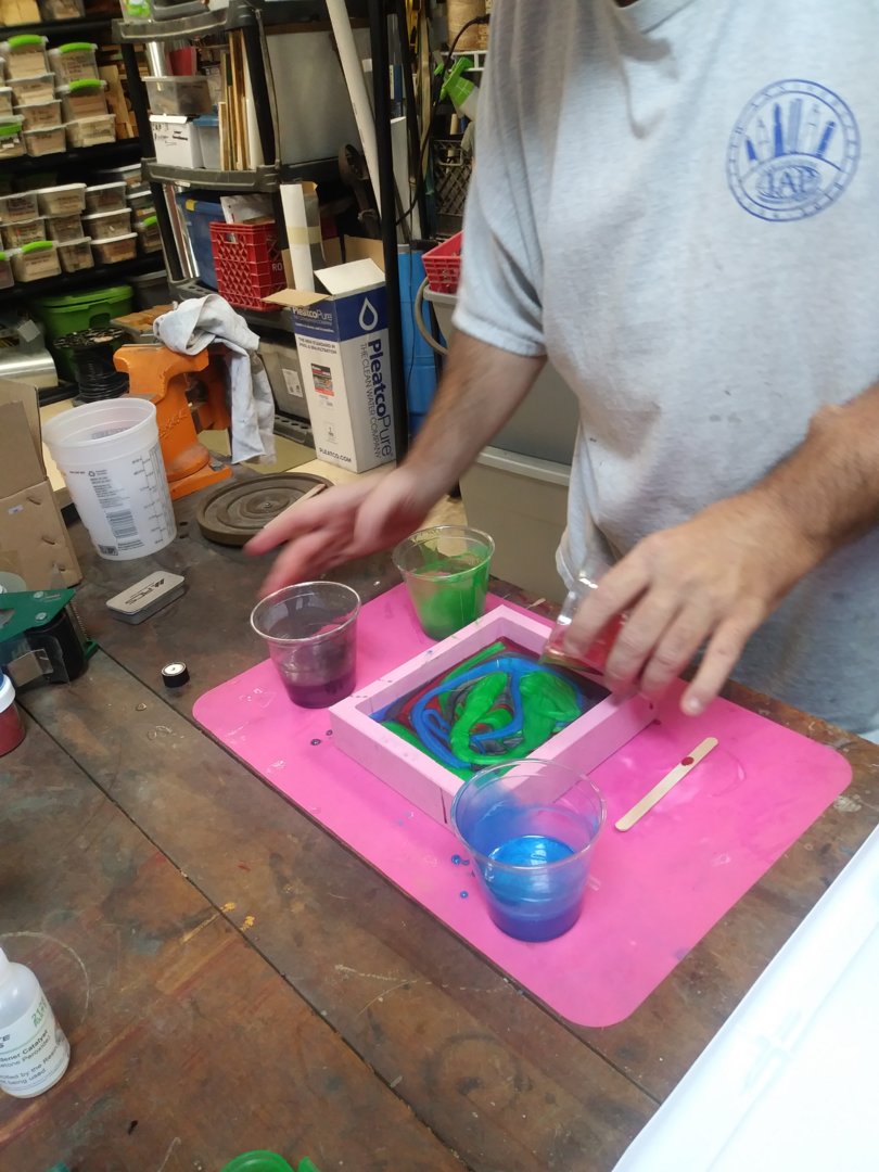

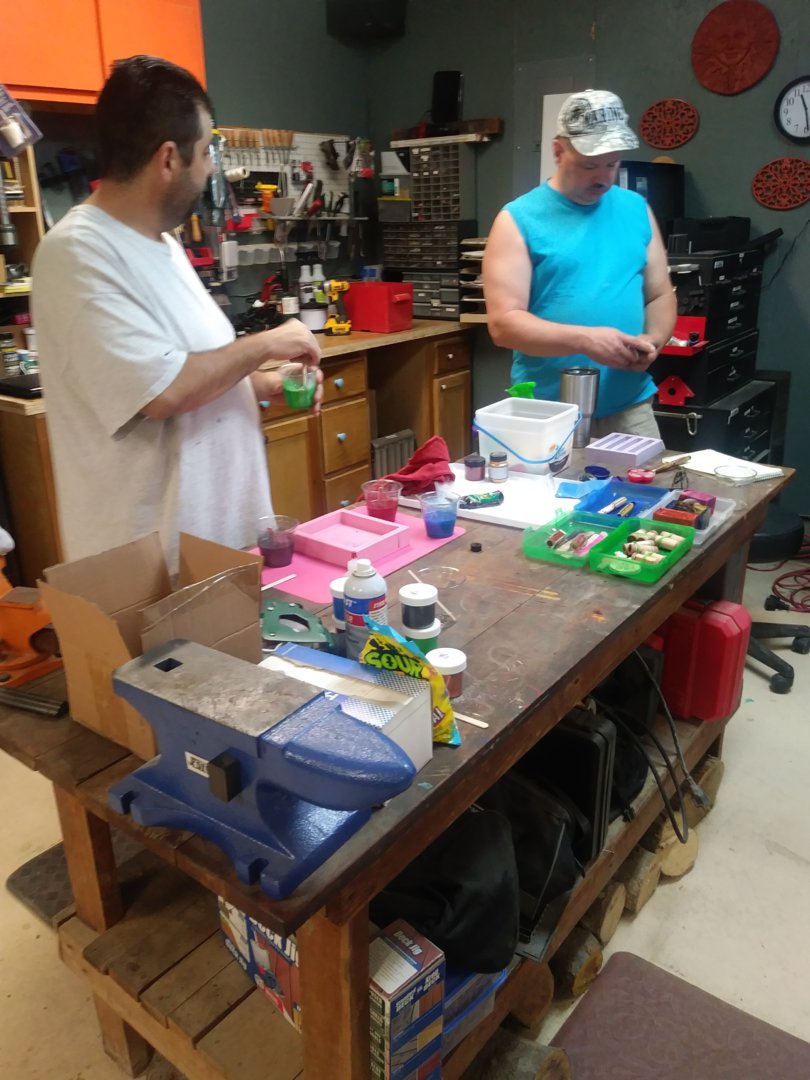

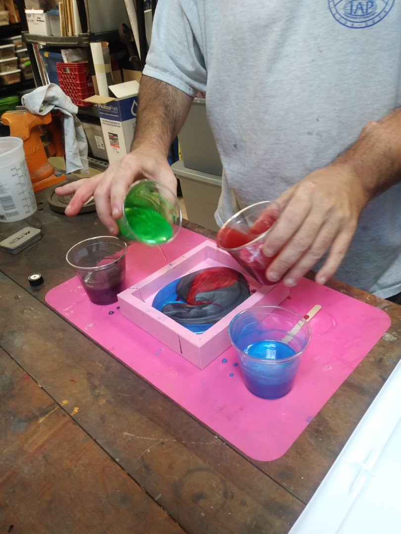

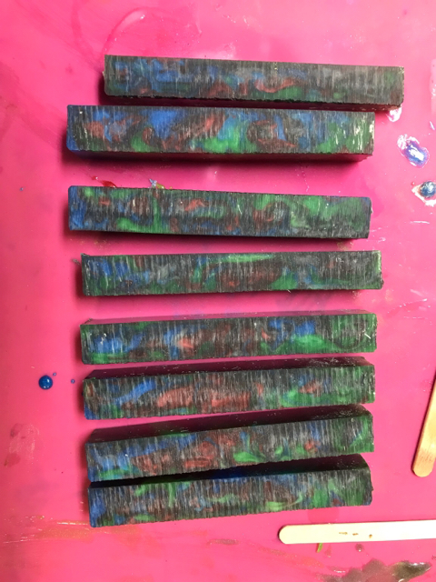

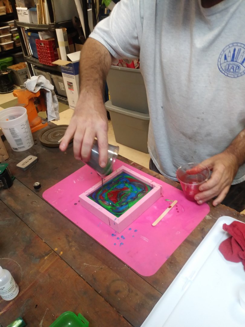

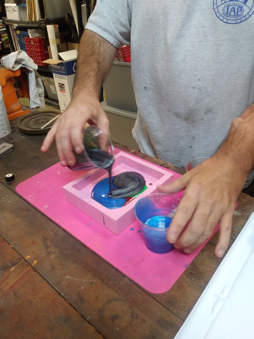

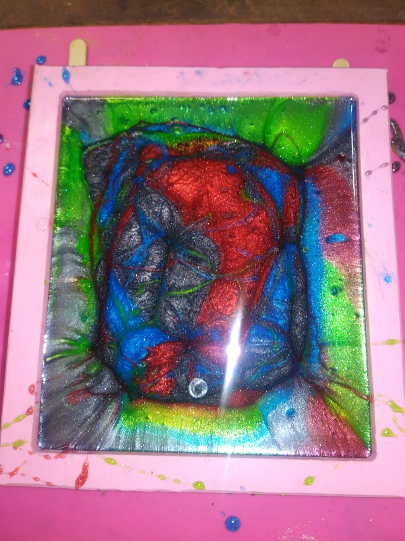

The end result of the 4 color PR pour

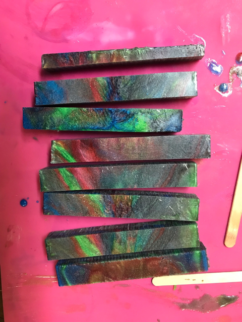

Cut blanks
Side view, was a nice mix
We knew the pour was a little short and the mold was not level on the mechanical work bench vs the casting bench, but we ended up with 6 blanks at .7x.74 and one a little less at .65x.74. All are 5" long. I will reach out to each person who attended and send you a blank to make a pen with and post a photo of.
