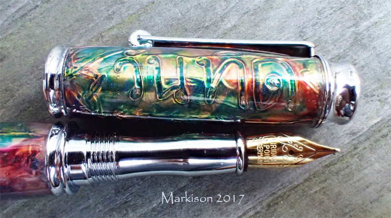

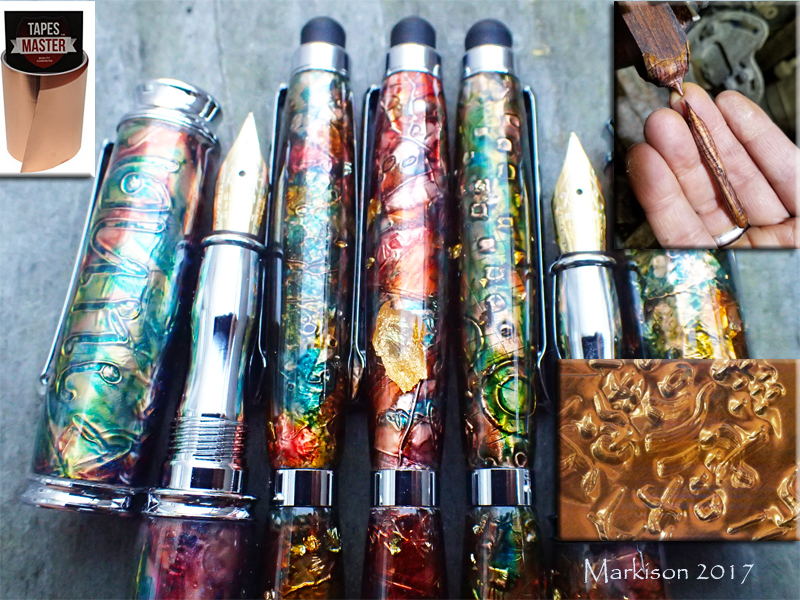

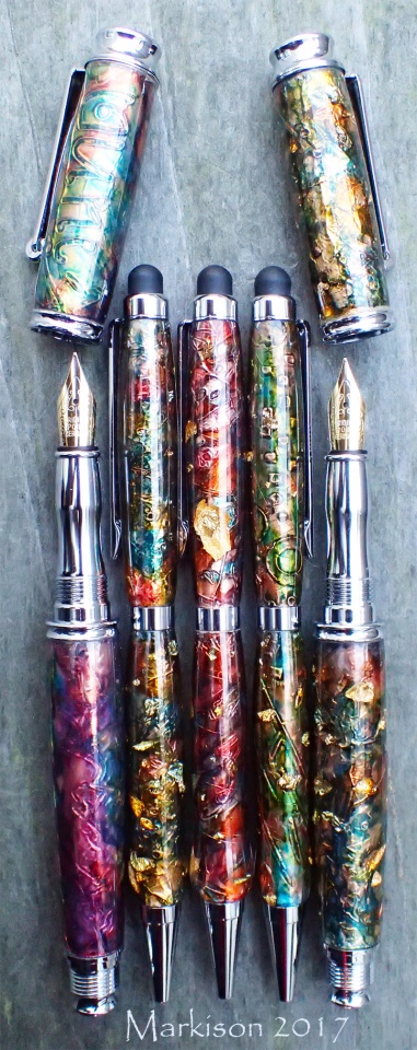

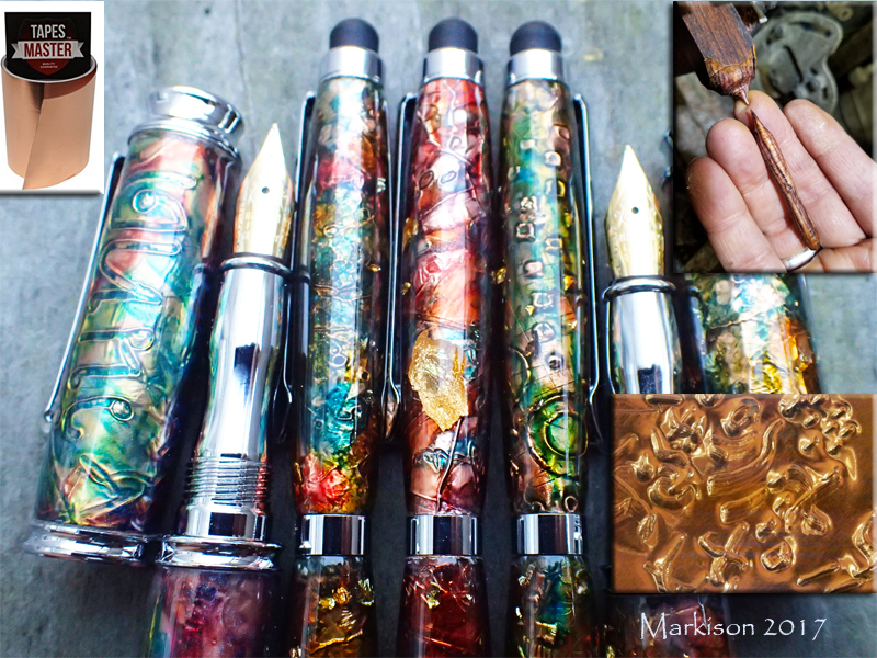

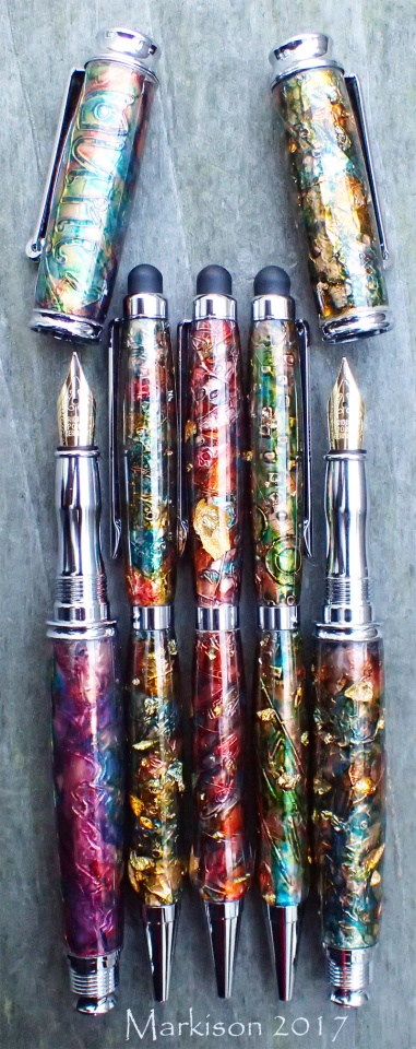

I was using some adhesive conductive copper foil to reduce the 60hz hum in the guts of a lap steel guitar - tiny light bulb went on.
Why not tool some copper foil with a little turned cocobolo stylus, alcohol ink it, adhere it to the brass tubes, seal with Createx Gloss Top Coat, PR cast tube-in with some flakes, then turn/finish as usual?
No one else was in the shop to just say no (and this is often the case).

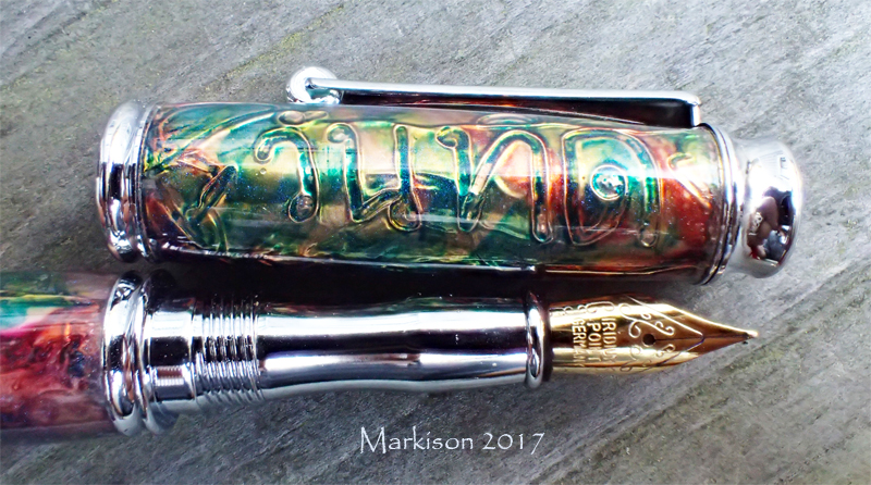

Mom is on the left - and has "Beautiful Day" calligraphed on her top barrel in Thai language.
The kids speak some sort of abstract abstract language that I can't decipher, and Dad is non-verbal (too much shop time):

I may have popped open a tiny can of infinity - will keep you posted.

Hey, Bob !!!! . What will be next ? . Who knows, eh ????
These are highly creative and very attractive !!!!
I wonder what the thickness of the Cu foil is ? . Any special technique to deal with the wrap-around seam ?
Is the foil wide enough to get you all the way around the brass tube ?
Thanks again for sharing your very interesting ideas !!

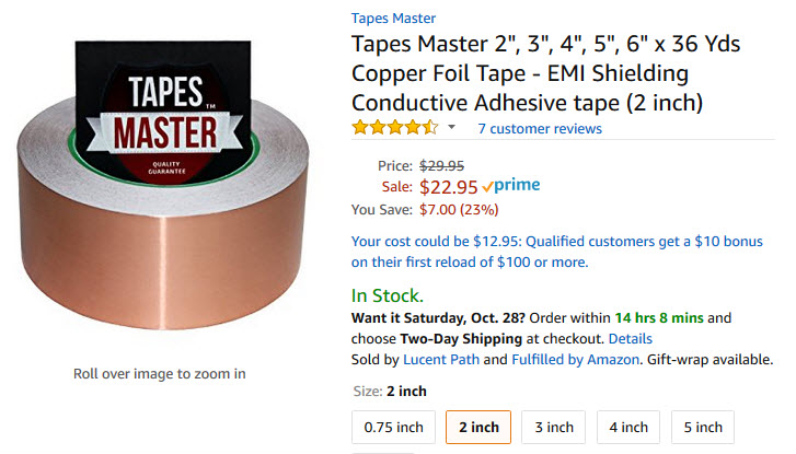

Here is the Tapes Master self adhesive tape - using 2" wide:
attachment.php
Technical Data:
Color: Copper
Carrier: Copper Foil
Adhesive: Conductive Acrylic Adhesive
Carrier Thickness (mm):0.025
Total Thickness (mm):0.06 ± 0.005
Appearance:Excellent, no oxidation
Initial Tack(Steel Ball) (#): 11
Resistance(ohm/in2):0.05
Holding Power(1kg/inch): >1140
180Peeling Strength: >8 N/25.4mm
Application Temperature: -20~120 Celsius
Storage Condition:20 Celsius, 65% RHH
36 yards of the 2" will yield 600+ slimlines - not bad!

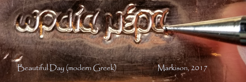

I do the tooling with hand-turned hardwood scribes (styluses) or tiny ball point scribes - carefully working either side to regulate the level of relief - similar to chasing and repousse in metalsmithing.

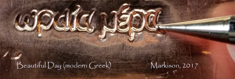

This foil tools like butter - ideal for figurative imagery, abstracts, and for my (current obsession with international) calligraphy, eg.
"Beautiful Day" in modern Greek:
attachment.php

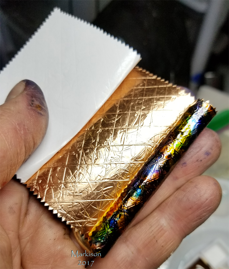

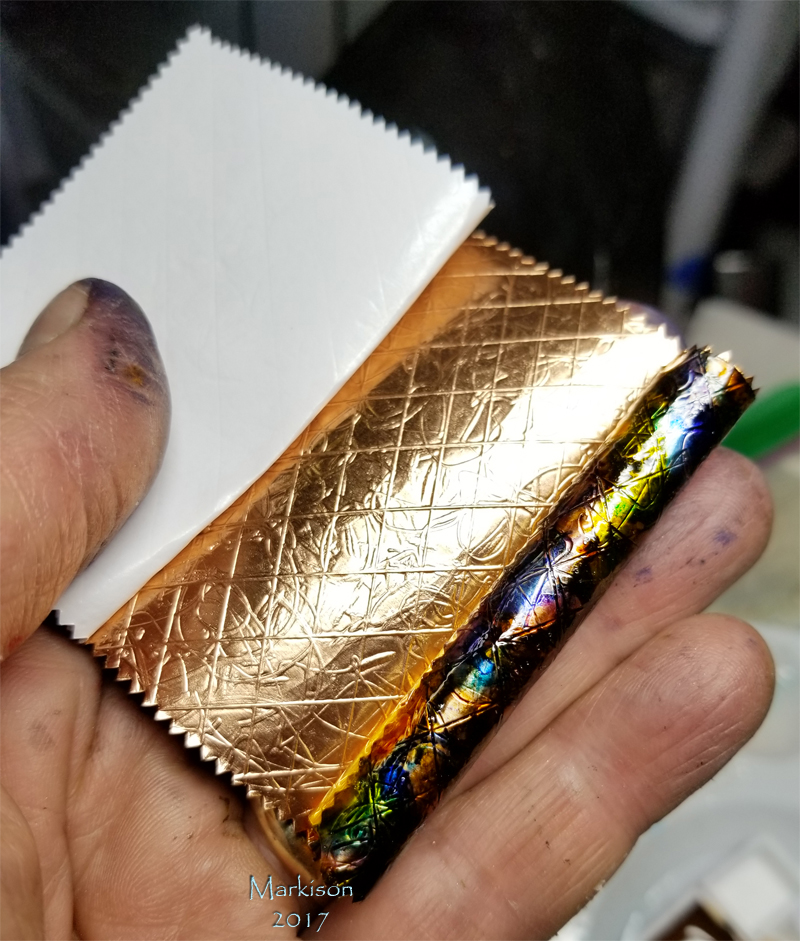

I cut the foil with (tiny-toothed) pinking shears - and don't mind the (well concealed and even decorative) edges:
attachment.php

They are so stunning, thanks for sharing. I am interested in how you adhere the foil to the tube without flattening the tooled detail. I have tried the aluminium foil in the past but have rubbed out the detail when sticking it on the tube. Any clues would be appreciated.
Eric...
Thanks, Mal and Pete!
"Curses! Foiled again." - nice!
RE: Eric's "I have tried the aluminium foil in the past but have rubbed out the detail when sticking it on the tube. Any clues would be appreciated.
Eric... "
No problems losing detail - BUT I wrap slowly without force because this copper tape has great adhesion without pressing hard.
Try it - you'll like it.
- Bob
