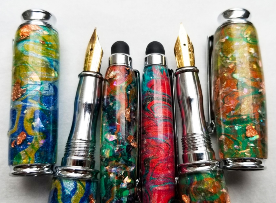

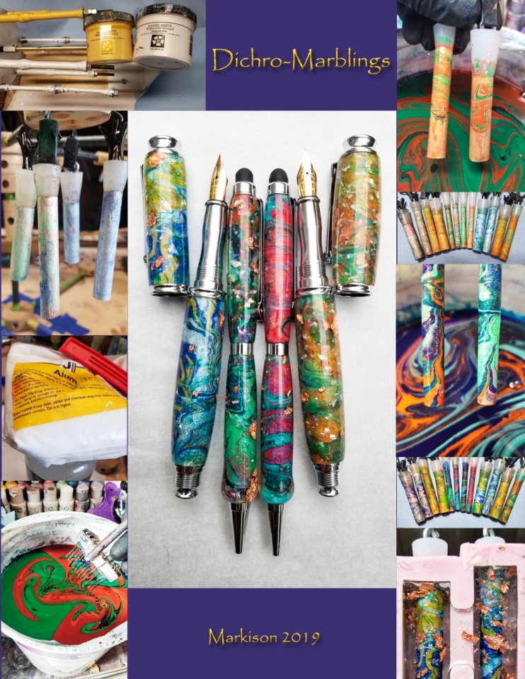

Meet the Dichro-Marblings; steps:
Coat the brass tubes with 2 coats of Daniel Smith watercolor ground, dry 1 day between coats.
Color-tone the tubes with handmade watercolor paints - see earlier post here:
http://www.penturners.org/forum/f13/handmade-watercolor-pens-150722/
Dip the stoppered/toned tubes in Alum (2tbs in a quart of water), dry x 4 hours.
Thicken tepid water with methyl cellulose - 1 tbs methyl cellulose + 1 tbs ammonia + 1 tsp white distilled vinegar - mix gently with a wire whisk - let it rest for and hour to "debubble".
Gently drop various colors of Golden High Flow acrylic paints onto the surface, stir carefully with home made rakes (T-pins,through soft wood, dowel handle).
Wiggle the tube down through the floating painting, wiggle it back out, then gently rinse in fresh H2O; dry x 8+ hours.
Repeat the marbling through a fresh painting, rinse, dry overnight.
Tube-in cast with Douglas and Sturgess PR mixed with bits of dichroic film and copper flake, 50psi.
Cure x 1 week.
Turn and finish as usual.

They are living happily ever after so far (disclaimer: results may vary, and circumstances are subject to change without prior notice).

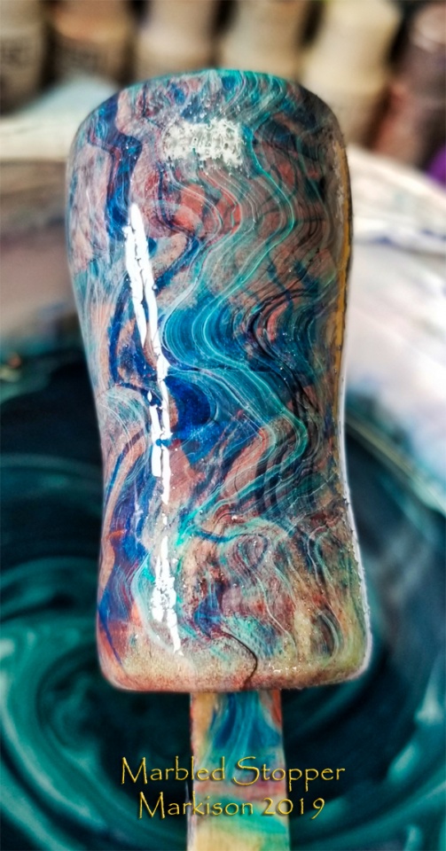

The method works well on sanded wood - just be sure to use alum before dipping - here's the first (triply marbled maple) of a run of marbled stoppers for some artist friends - will probably protect with Alumi UV resin:

What does the alum do exactly?

What does the alum do exactly? (Phil/Firewhatfire)...
Alum = Potassium aluminum sulfate, which is an essential mordant that binds colors to paper or wood or fabric or other (usually fibrous, or in the case of my marbled pens watercolor ground pre-treated) surface - without alum, the colors will wash off.
