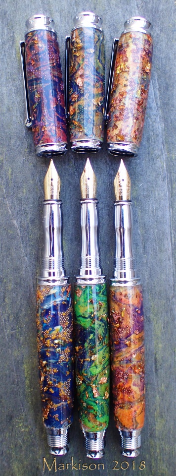

A textile designer friend asked for a pen update.
I showed her the Marblings.
Explained in an earlier post:
http://www.penturners.org/forum/f13/metal-marbling-via-watercolor-ground-150141/
I showed her the BeadieBabies.
Also explained in an earlier post:
http://www.penturners.org/forum/f13/beadiebabies-unstrung-heroes-151798/
I asked her if she'd like marbled or beaded: "Yes"
I asked her she'd like tiny or very small beads: "Yes"
I asked her if she'd like 1,2, or 3: "Yes"
(I am not one to argue - especially when adventure is in the offing)

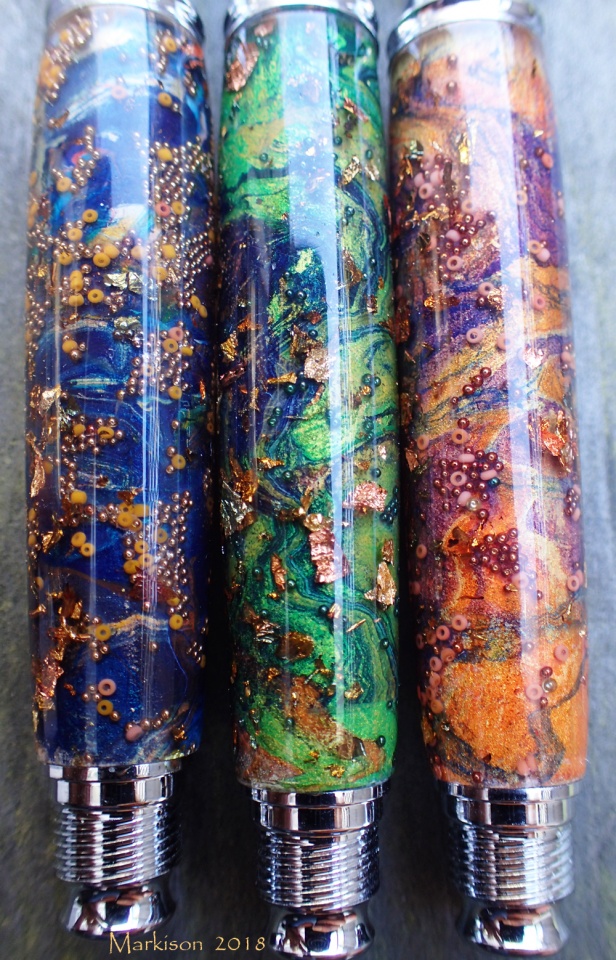

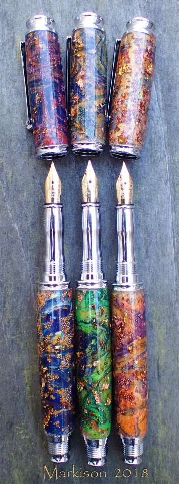

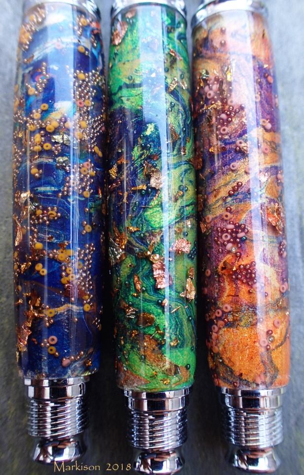

Meet the BeadedMarblings Trio:
attachment.php
attachment.php
Happy Sunday to all - Bob
Impressive Bob. I can see it all. Others may not understand that comment, however, from previous posts, I believe you will. The combination of depth, content and balance is ideal, in my opinion. These have hit a sweet spot.
So, my favorite is 1, 2 or 3... YES!
Well done. :smile: (I do love the little beads).
OK, so I do love Blue, so the left is might fine!

More Great Eye Candy Pens, Bob.
Isn't it surprising how much difficulty some people have, in making a simple selection,
I am like Mark, I'll chose the same!
I am sitting on the edge of my seat, in anticipation of what "Alchemy" you are developing, Can't wait, my Friend.
Brian.

Toni - These are not poly clay blanks - I sanded the brass tubes with 150 grit; then acetone washed them; then coated them with Daniel Smith water color ground (2 coats, each dried x 3 days); coated them with alum; dried the alum-coated tubes x 12 hours; then twice marbled the silicone-stoppered tubes by wiggling them down vertically through paintings floated on methylcellulose-thickened water (3 days between marblings); dried the tubes x 3 days; then adhered the beads under high magnification using Judikins Diamond Glaze; dried x 4 days; final-coated the tubes with a thin layer of Judikins Diamond Glaze; dried x 4 days; then tube-in cast them with Douglas and Sturgess PR mixed with metal flakes at 50 psi; then lathe-turned and finished them as usual. Fun, but a bit time and labor-intensive.
I've not yet marbled alum-coated poly clay - but no reason not to try it - hmmm...glad for your question!
Warm regards, Bob
