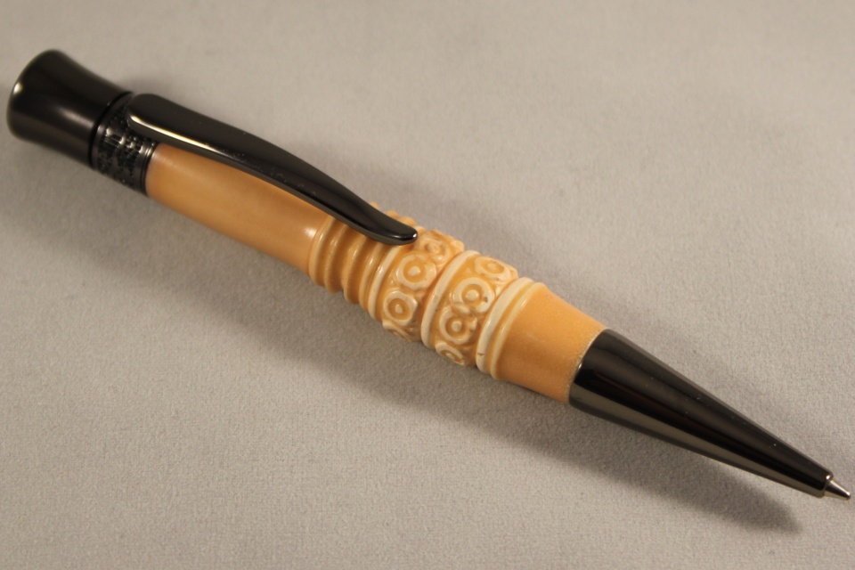

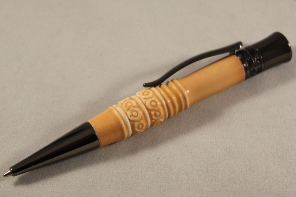

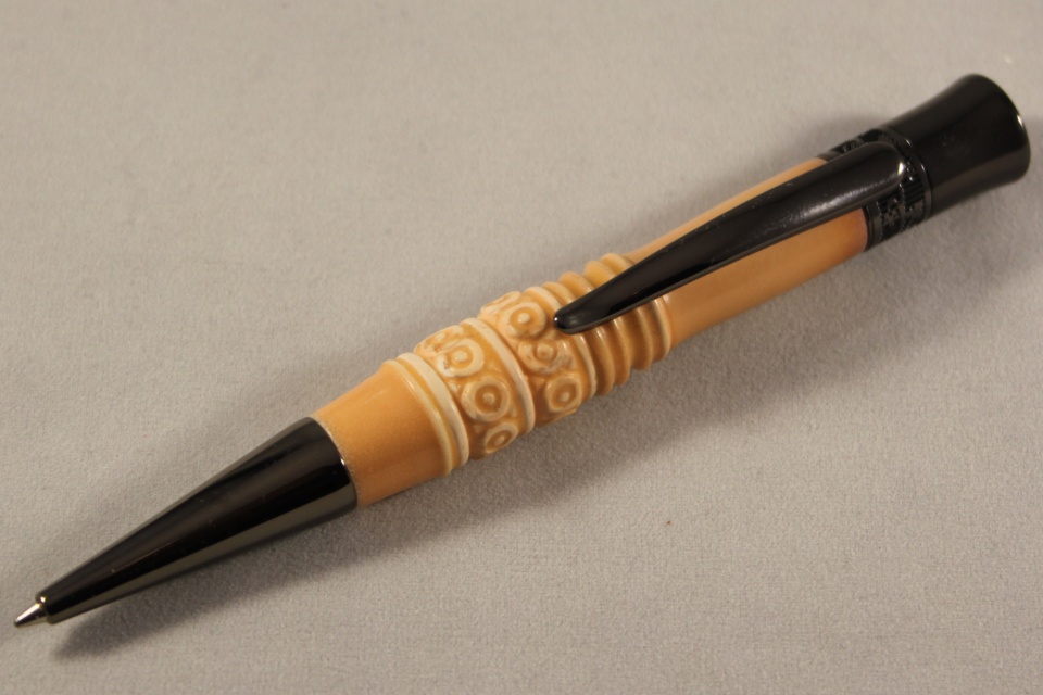

Gun Metal Epsilon and Meerschaum from an old Cigarette Holder.
Worst part was drilling it out to 8.5mm.
Hope you like. C and c welcome.

That is pretty special Andy. What is the material? Looks like clay or porcelain or similar. I'm intrigued as to how you centered and held it for drilling. :eek:
How's Ratingen? I've been there several times for work ( ABB Calor Emag )
Thanks Steve, it really is Meerschaum.
https://en.wikipedia.org/wiki/Meerschaum_pipe

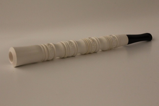

This is a wierd type of stone that dry its like plaster of paris, wet it feels like block of soap.
I drilled it freehand from the original 3mm up to 8,5 for the brass tube. After the glue hardened I turned it down to the correct diameter.
It was then hardened by soaking it in pure bees wax, this also gives it a nice patina.
Here`s a pic of what it started out like.
