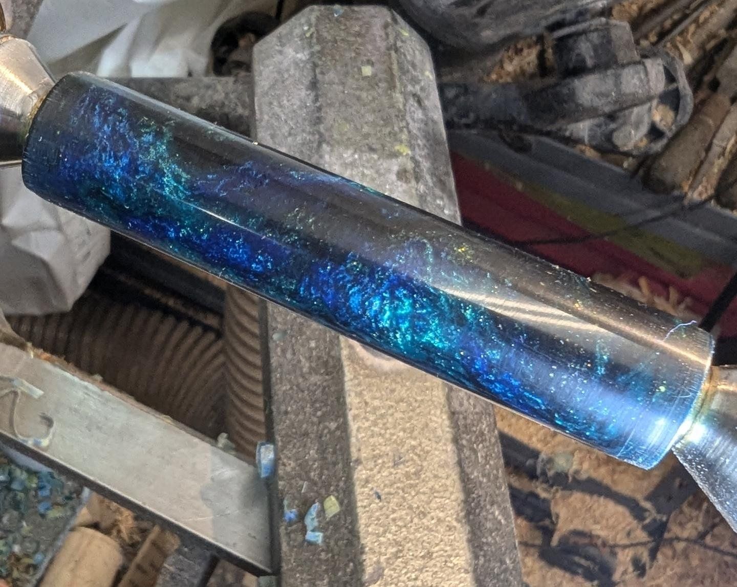

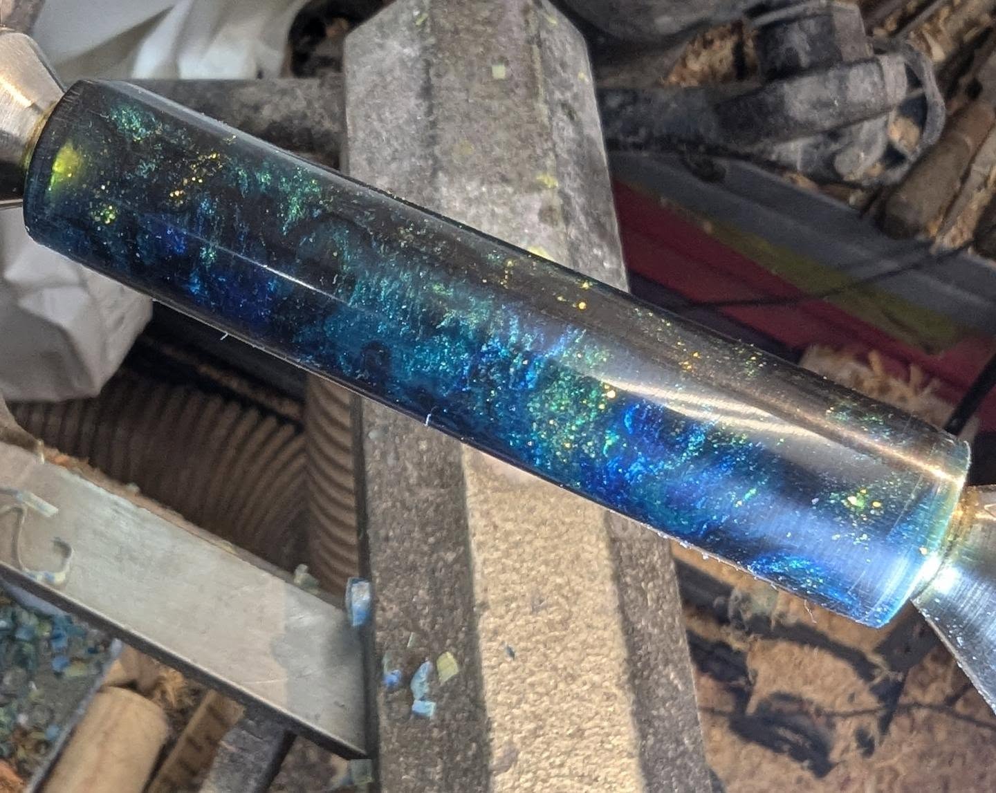

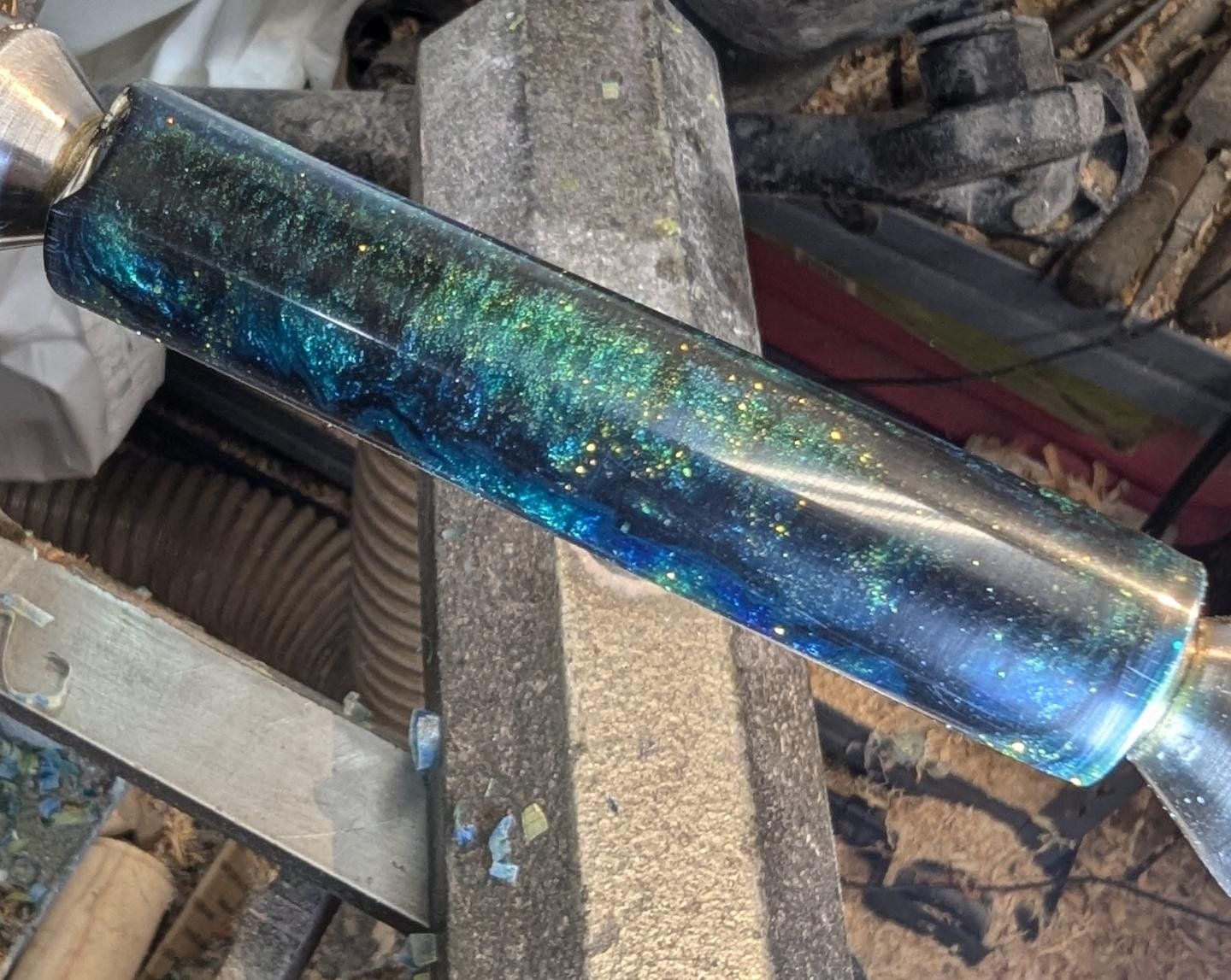

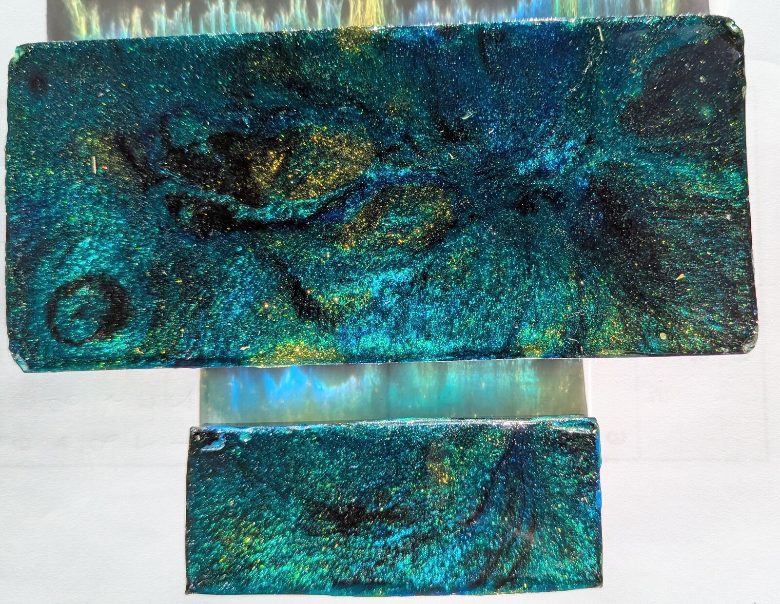

Yesterday I made my first pour using McKenzie Penworks Thermoset resin (my second pour ever - I used epoxy resin the first time.)
4 colors using Smooth-On "So Strong" dyes (as recommended by Tim McK), with Eye Candy mica added. Pressure pot at 55psi for 4.5 hours.
I'm very happy with this result so far - of course the proof will be when I turn it into pens.
Very nice, I like the colors. Can't wait to see the turned as well.
