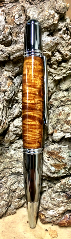

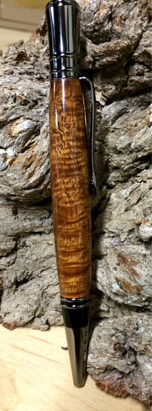

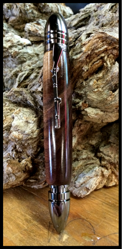

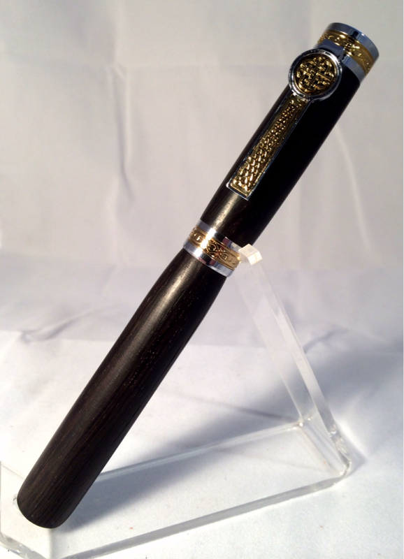

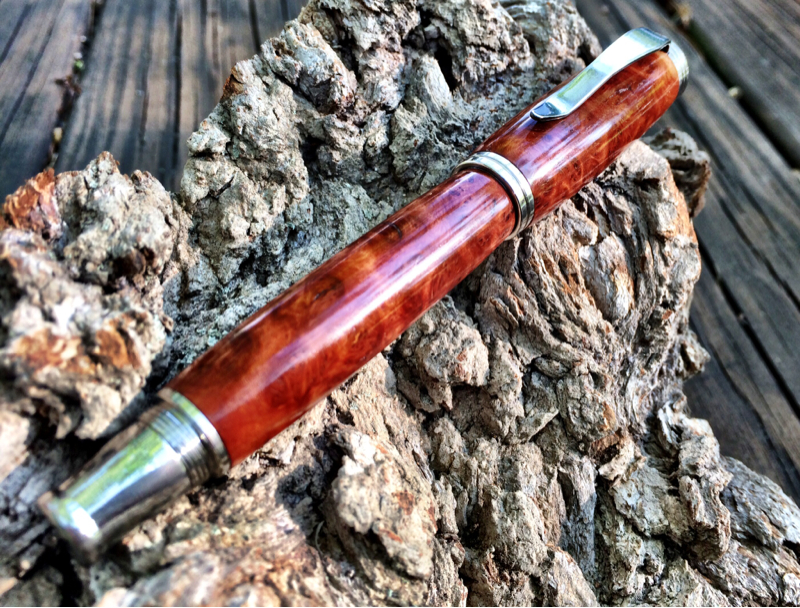

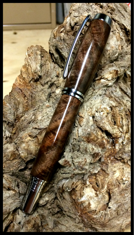

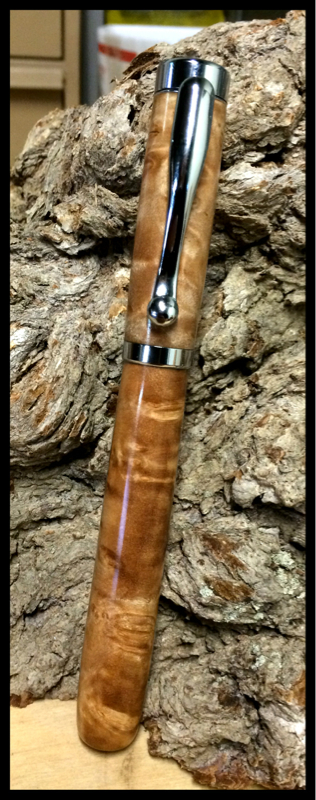

I'd like to have a thread to continue to discuss methods and best practices with Pens Plus from Doctors Woodshop
I've been pretty happy with the result that I've been getting, and I want to continue to maximize it Oh and the time savings is huge
So, for those who have been using pens plus, questions like...
1. Do you feel like you are getting a nice, fairly high gloss? (Assuming you want to)
2. Have you narrowed down your method to one that works well for you consistently?
3. Have you found that different types of wood require different approaches, coats?
4. Have you used pens plus on any different materials / tried anything unusual that you've found effective?
5. Have you gotta any indication from pens you've been using or given sold with pens plus that are not wearing well
(Please, no comments making overarching statements like, "friction polishes don't hold up" If you've specifically found that pens plus specifically doesn't hold up, PLEASE do share that!)
Thanks for contributing My hope is that we can have some good ongoing discussion on this particular finish

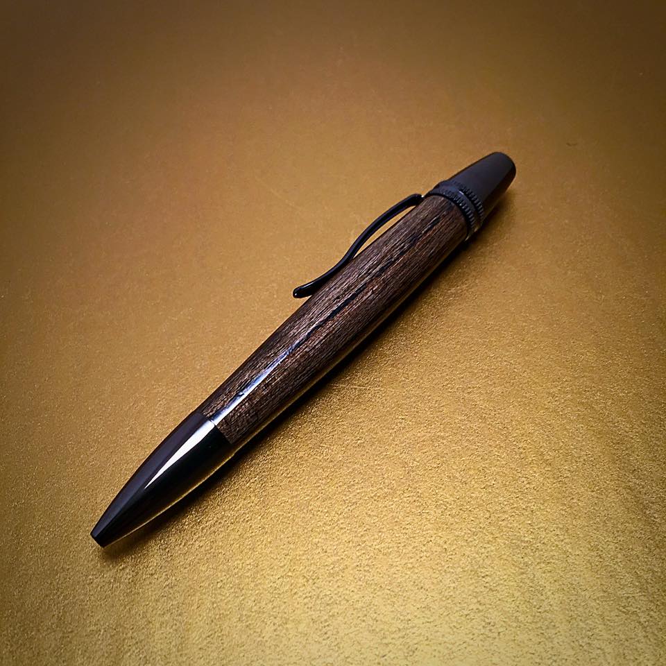

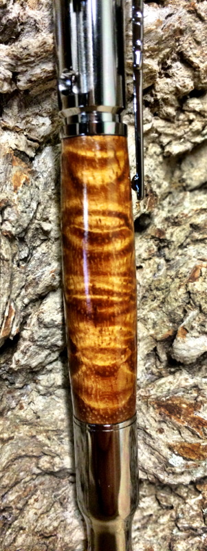

At this point I'm calling pens plus my go to wood finish.
So easy and such a nice finish.

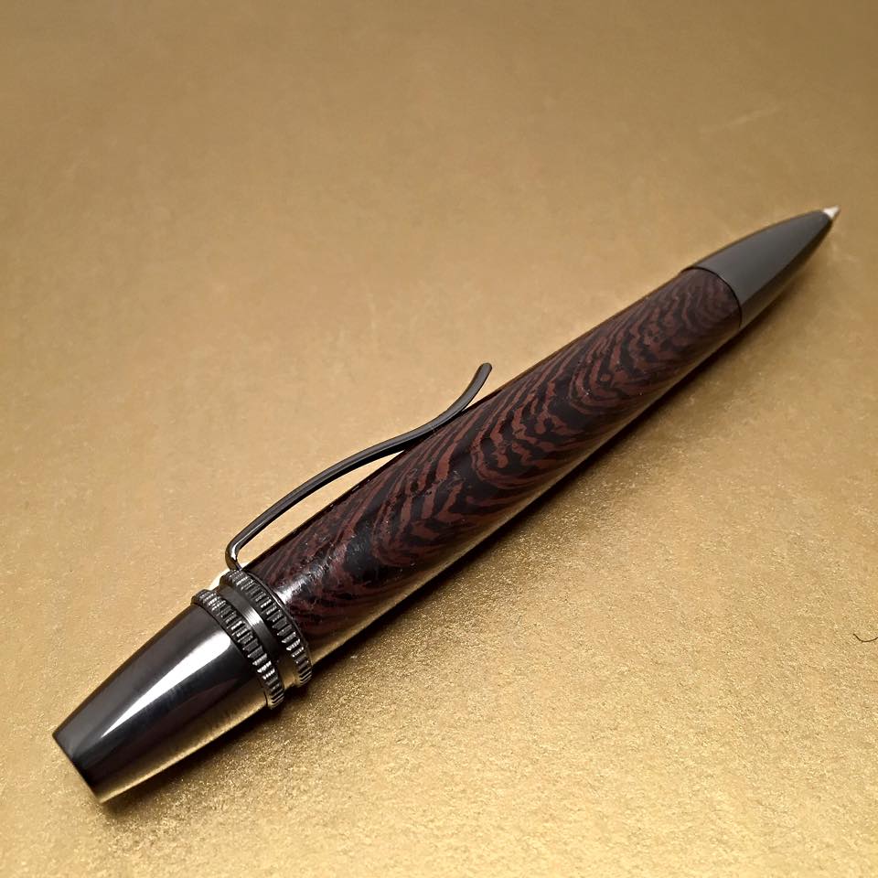

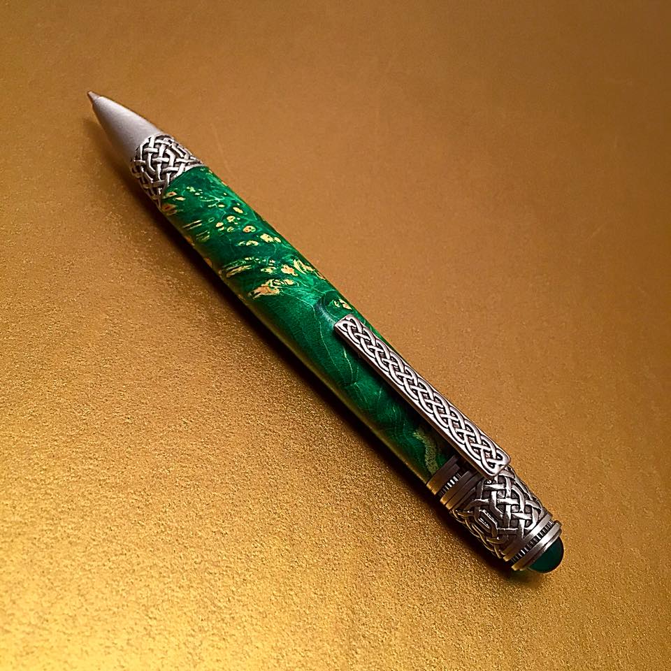

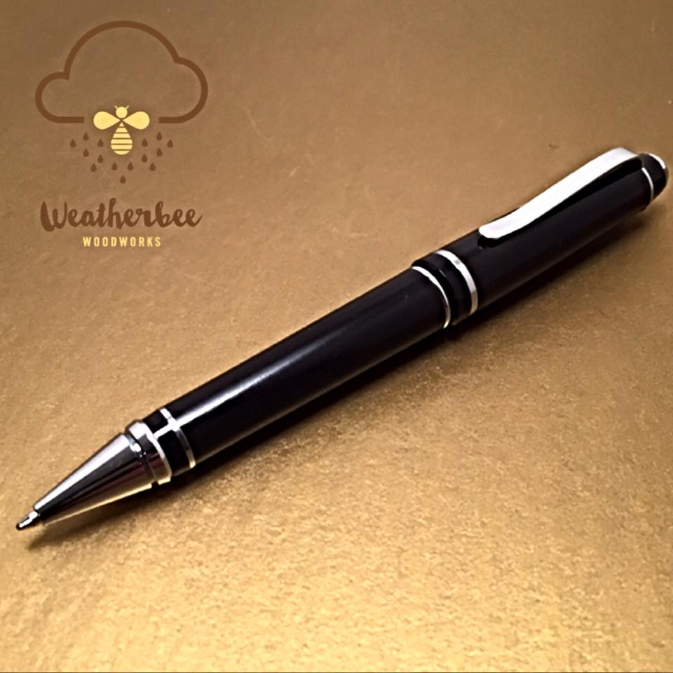

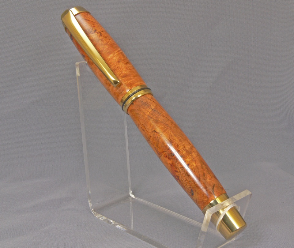

hey guys,
I've been using the pens plus and i also love it! i used dans tip on using it while you are going through your sanding grits up to 600 and its fantastic. after the 600 i start applying it with just a paper towel and the lathe cranked to about 3900 rpm and friction it in with heat. wait 45 seconds and add another one. i do about 6 coats as well and it works great. I've gotten away from CA finish mostly because it looks pretty cheap and plastic like when its done. I do however use CA with the pens plus when i want a more natural look and feel. once I've sanded to 600 i then do 5 coats of thin CA, lightly sand to even it out and then add 10 thin coats after that. i then take 600 grit wet sanding sand paper from klingspor and wetsand lightly. after that i will take some 0000 steel wool and give it a light touch and its dulls down the CA finish. it still has a great shine and luster but it doesn't feel fake and plastic. just a nice shine achieved. i believe this will be good to ensure the longevity of the finish and also the oil acts a second level of stabilization underneath the ca finish. i stopped using medium CA bc of it being cloudy, chipping at the ends and overall breaking away from the bushings is a lot tougher with the medium. if i use thin ca then a couple taps on the lathe bed and its freed. then some sanding of the ends of the barrels lightly with 600 grit and its good to go!
all those below are done with strictly pens plus and the black ash polaris is a combo of pens plus and thin ca

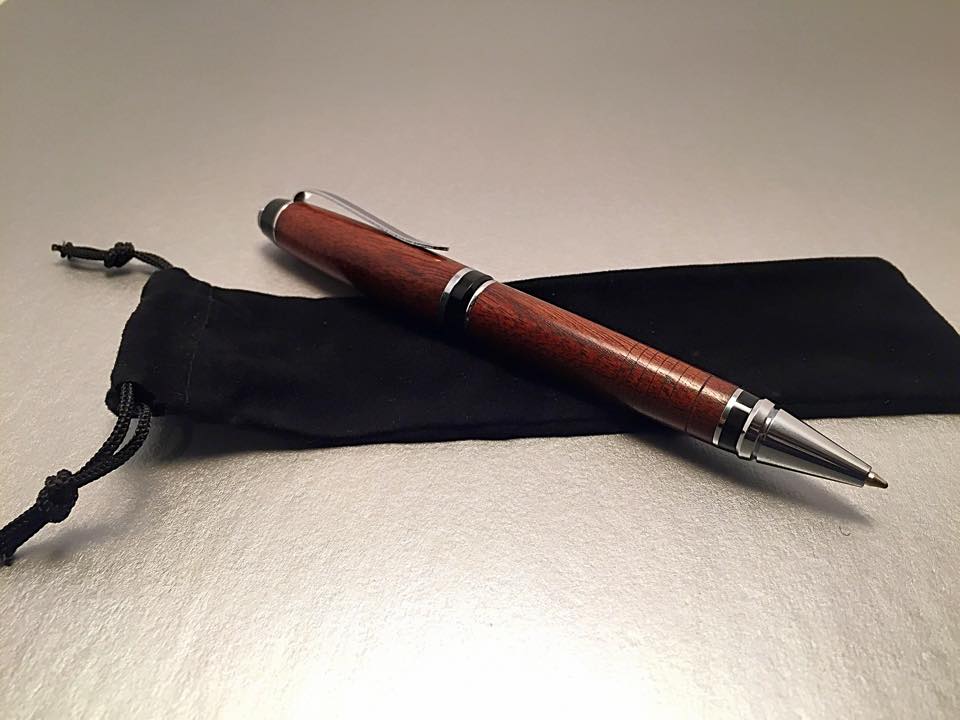

Thanks Dan for starting this thread. It comes at a good time for me because I've developed a severe reaction to CA and I've been looking for a replacement finish.
The picture is of the first pen I finished with PP. The finish is actually better than the picture shows because I'm a lousy photographer. I put it on using the same method I used for a ca/blo finish rubbing lengthwise quickly until I felt the heat start to build up. I put on six coats like several have suggested, but like you said after two or three it doesn't seem to change much.
I'm happy with the results. It's got plenty of shine and is very clear and bright with good depth. Frankly I'm surprised a friction polish looks this good.
I'll probably still use lacquer for my high end pens, but at this point I don't see why PP wouldn't be a great alternative to CA for everything else.
