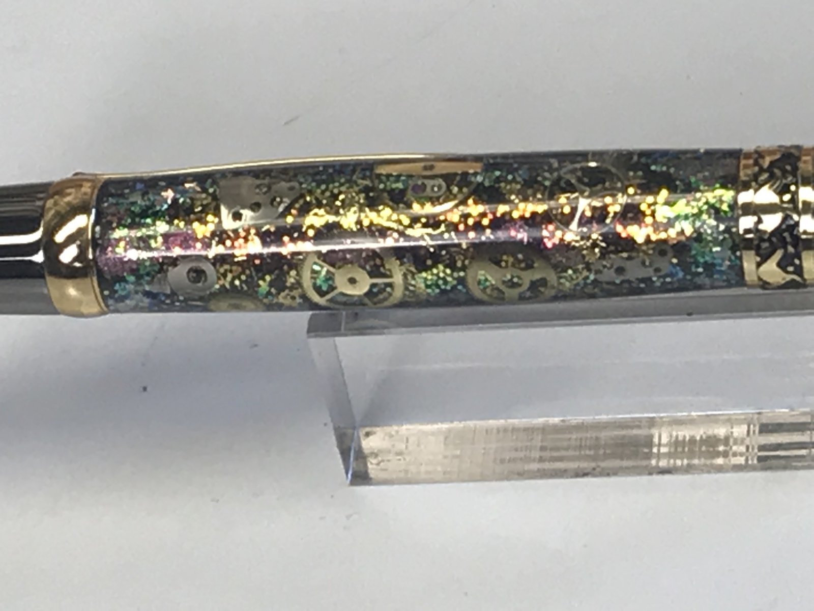

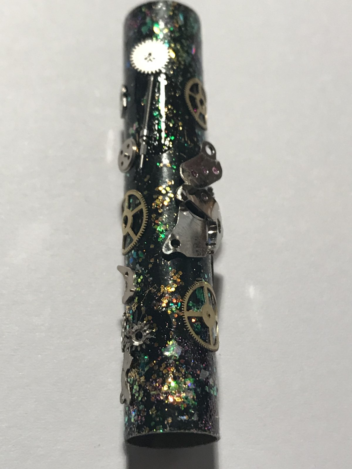

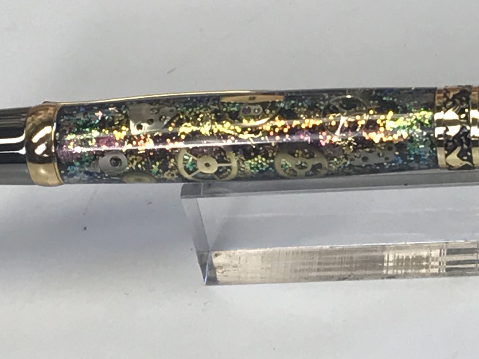

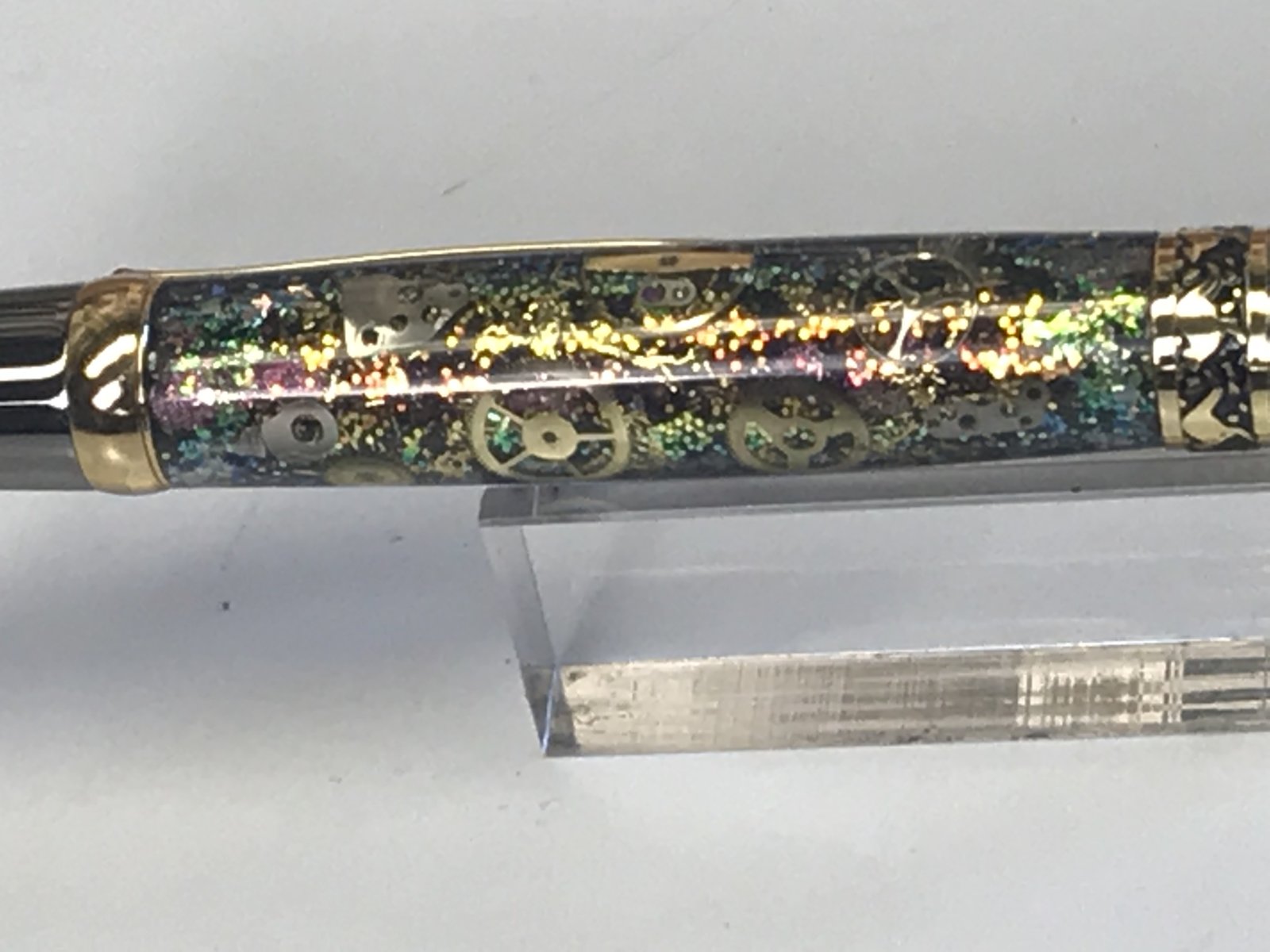

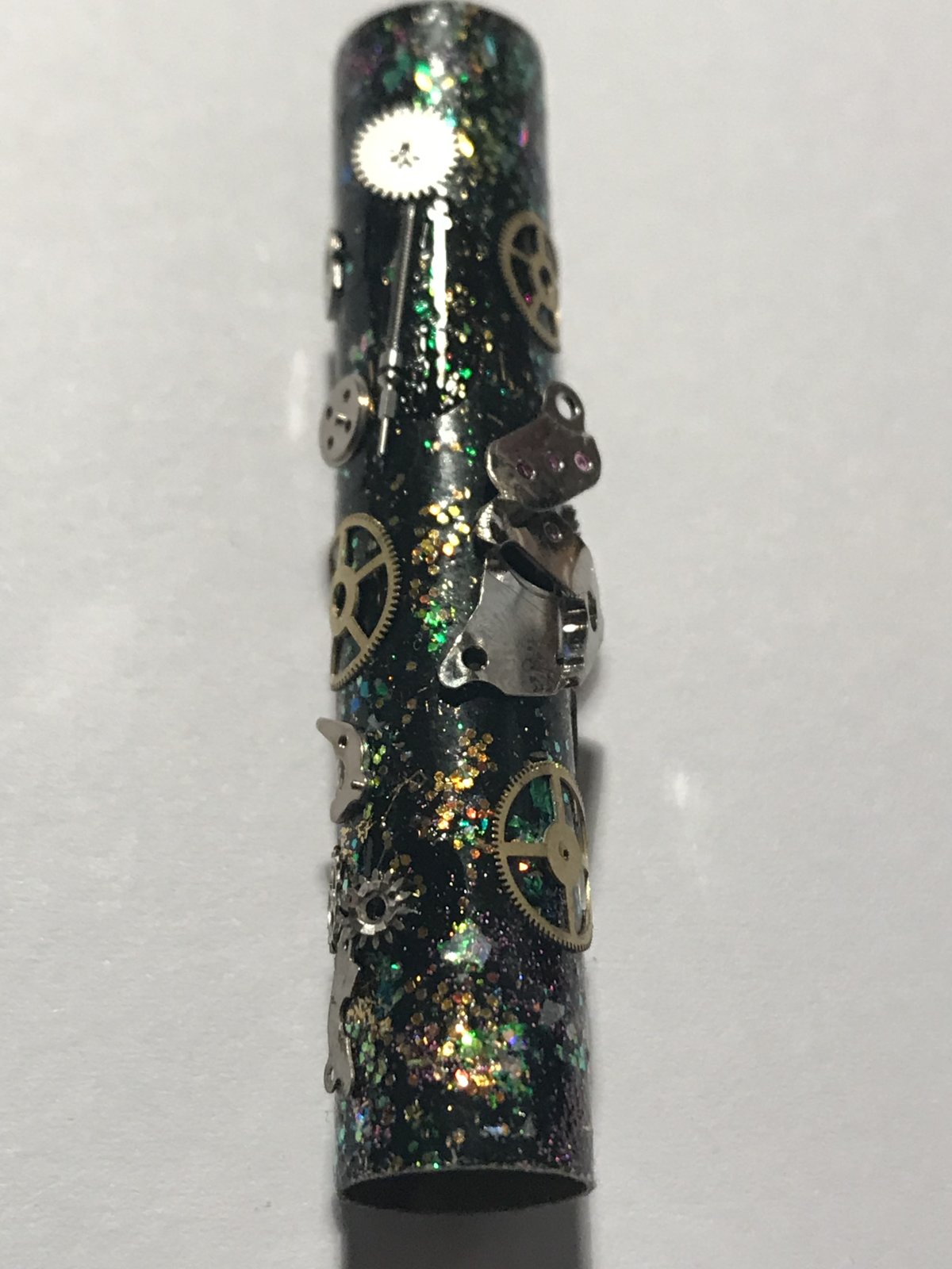

do Steampunk blanks but I buy old watches on eBay or going to a watcher maker / repair who will be happy to give you parts for a pen
