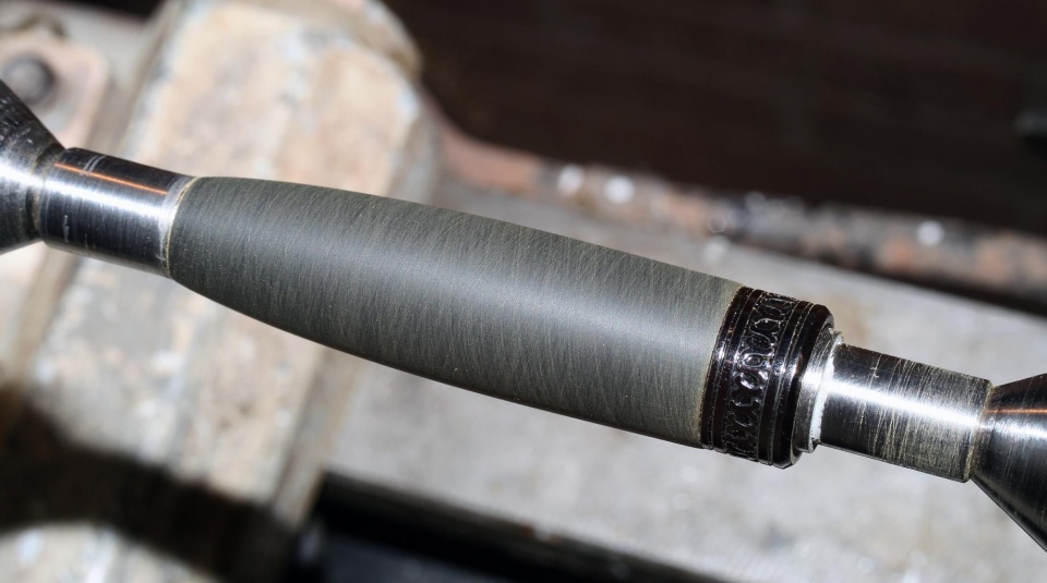

Tenons, lets see here.
attachment.php
The bushings will have TWO sizes. the large bushings and the smaller inside bushing. I may as well be speaking greek but this should describe it nicely.
This is the small bushing.

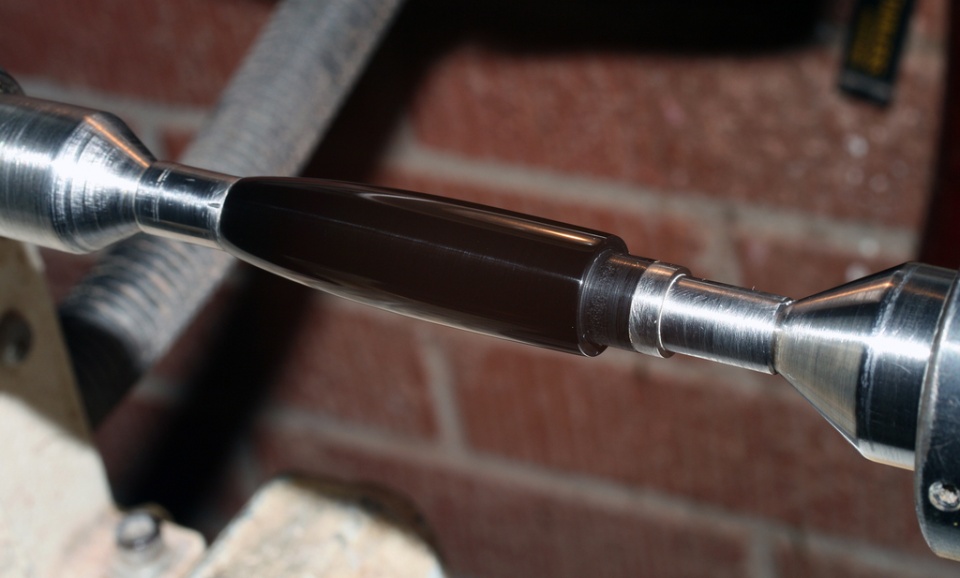

attachment.php
The large bushing will let you cut the outside radius then you just cut the step down to the small bushing.
I always suggest using the band to test fit and adjust as needed.

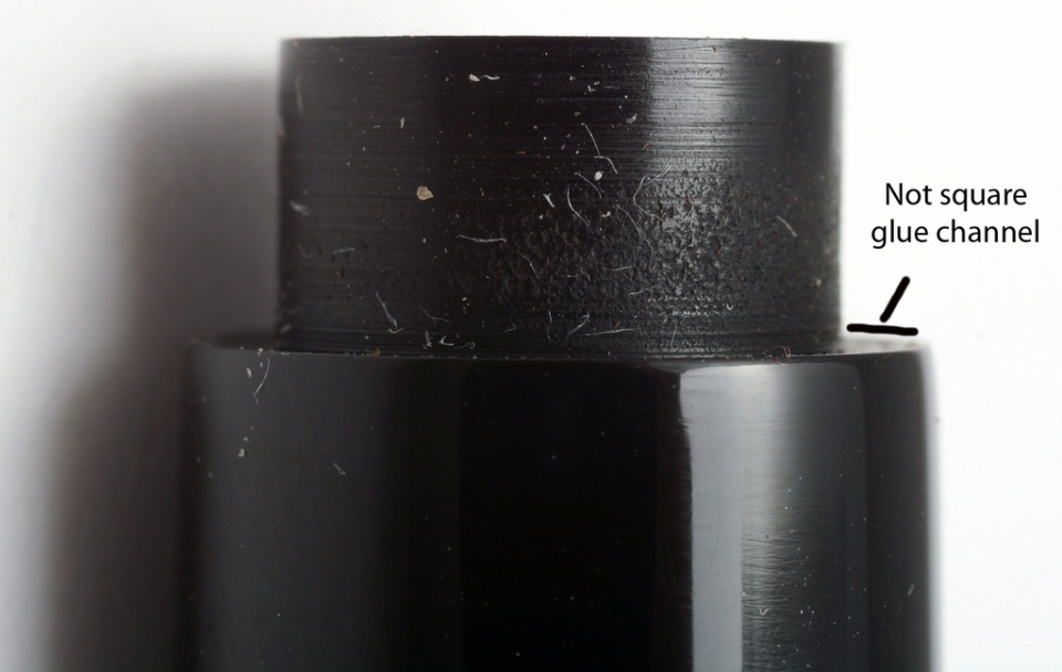

attachment.php

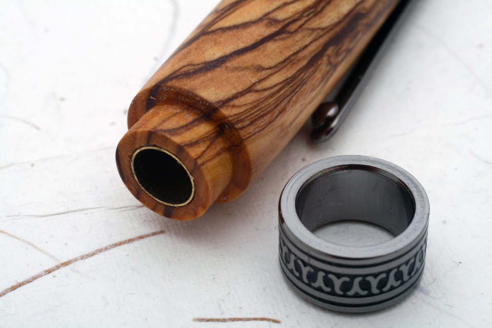

Oh and it need not be perfectly square either because of this.
attachment.php
