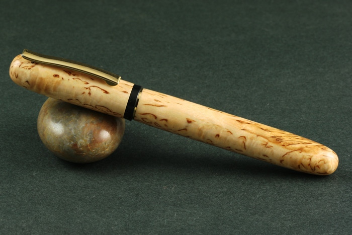

I used a minimal of hardware to enhance the elegance. Amazing wood. I'm proud of this one. I really took my time and gave attention to detail.
Martin

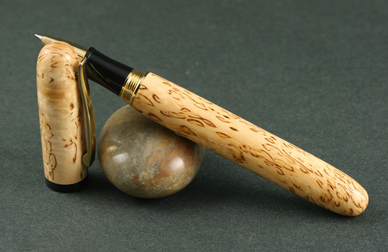

As far as the hidden clip goes - It seems to improve with each on I do. I have had some real disasters including CA glue coming out the insert hole and getting glue all over the clip/pen and gluing my fingers to the pen itself. But... with each disaster comes learning, so just dive on in! I use a Dremmel to make the small hole and to shave and shape the clip.

so much love went into this pen. Great lines and overall look, if I could change one thing it would be to remove the clip...respectfully. The line are so dynamic with the grain and tone...

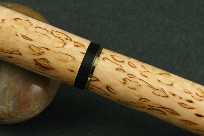

wood-of-1kind said:
Really great work here. The only thing that I would alter is substituting the CB with a constrasting 'wooden' band or other alternate material.
I so agree. I really want to get rid of the plastic parts all together. Would love that black band to be Ebony. Still hunting solutions. I know I can build around it to hide it, but I don't want to increase the diameter of the pen. Do you know of any resources?
Martin

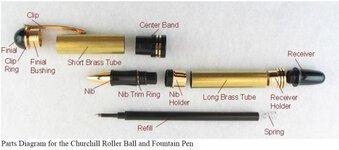

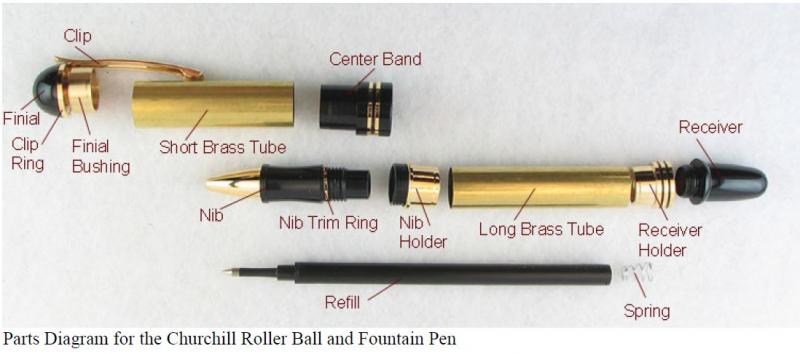

Center Band Alternative
I've included a photo of the Churchill parts. I use the tubes. The clip. The nib and nib trim ring.
I alter the center band by removing the black and gold rings and gently turning off some of the black plastic so it will press easily. I also replace the nib holder with a solid gold metal nib holder. (the plastic/gold metal nib holders are defective and will eventually snap) Berea Hardwoods is the only place I've found that sells this kit with the solid nib holders.
Q - Does anyone know of an alternative to the center band without increasing the diameter of the pen? I need a metal threaded center band to fit the nib holder that is "bandless". If I could find such a thing it would really open up the possibilities! Anyone want to make some on their metal lathe??
Martin

wood-of-1kind
Jul 10, 2005
4,116
Toronto, ON, Canada
Martin
I wish that I had a lead in regards to altering the CB. I completely forgot about the coupler design being part of the CB. Was thinking of the one piece design like the cigar style pens. Now you have me thinking...

What technique did you use for the hidden clip?
I have found using Russ F's technique the area above the clip gets very weak and sometimes creates a slight hairline fracture...

I started with Russ's tutorial in the library. 2009 Articles "Invisible Clip for the Jr. Emperor."
I have tweaked it from there. I haven't had any problems with fractures up to this point.
I make my hole (small slot) with a Dremmel. This has helped tremendously. I can also make fine adjustments in shaving the clip down using the Dremmel. Once I get the clip in place, I pack the inside area where the clip comes in with find wood shavings and add a couple/few drops of CA glue - *holding the cap at an angle so that the glue will not come out of the slot I have cut**
If I can, I'll make a video tutorial and post it on Youtube.

Just superb!!! When I first saw it, I thought it was a pen by Amos ( AKA WoodenInk ) Excellently done:biggrin:
