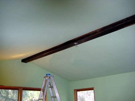

Replacing the original box beam with black walnut:

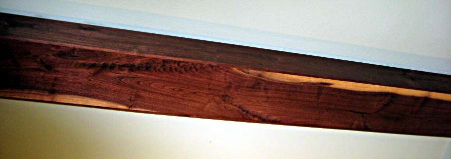

And a close-up of the box beam:

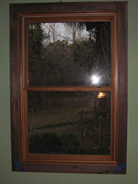

This is a shot of the new window trim being dry fit to the window:

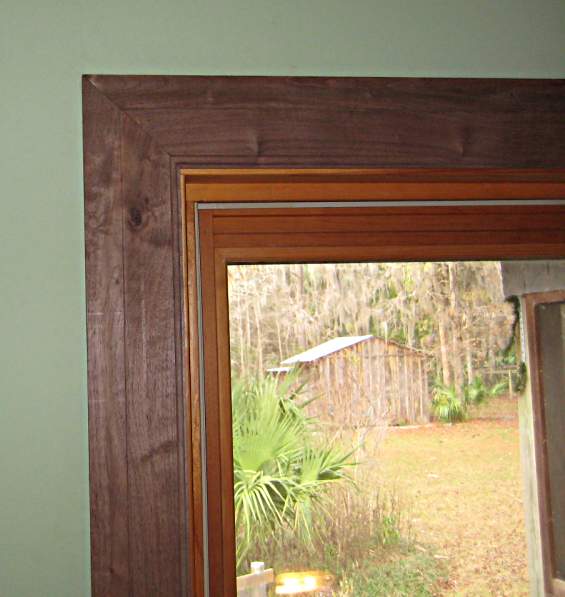

Close-up of the new window trim. This is raw black walnut prior to my putting any finish on it:

Thanks for the nice words. Yes, I milled the modlings myself. The inner edge is a small Roman Ogee profile and the outer edge is a Roman Ogee vertical raised panel bit. My finishing schedule is dewaxed Shellac followed by BLO. I expect the top two or three final coats will be Original Waterlox.
After all, it's air-dried walnut -- I wouldn't want to color it with stain. :wink:
As to the pre-existing pine windows, I'll likely touch 'em up with a few coats of dewaxed Amber shellac as Judy likes them together and the floors are 5-1/2" wide T&G longleaf and heart pine.

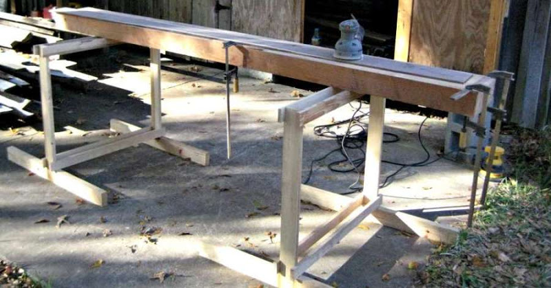

I don't have pics of that but If this doesn't explain it, let me know and I'll take some.
The bottom crossmembers of the horses are just high enough that the feet slide underneath them. Therefore, two takes up just a little more space than one, and three takes up just a little more space than two, and so on.
My shop to floor height is 11' high, so I hang 'em from the rafters when not in use.
