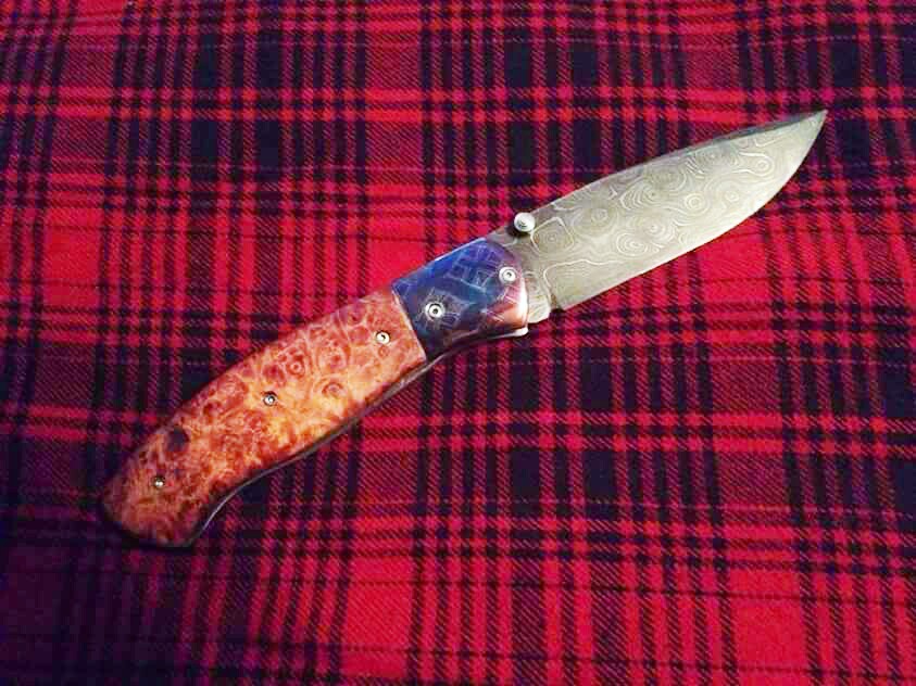

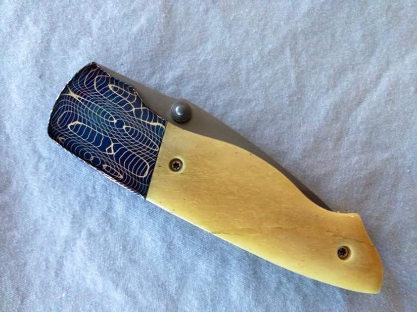

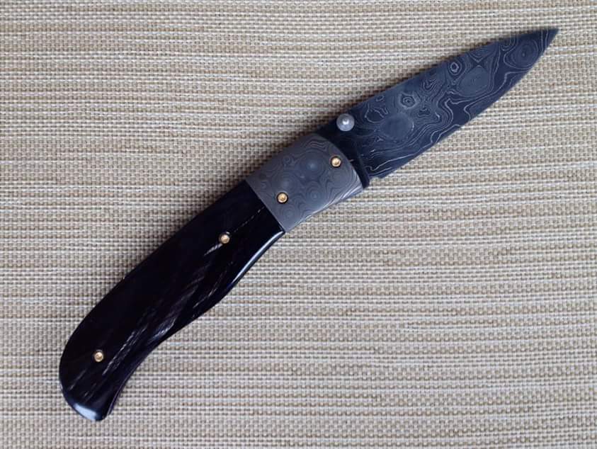

Steve the SS damascus I got is made of 304 and AEBL. The 304 work hardens under load (drilling) and the AEBL is an air hardening steel it hardens so fast. Gotta keep it cool.
Sorry I was so blunt but didn't want you tearing up more bits. Usually carbide is good for hard material but won't take the impacts from the upset ID and tends to chatter badly with scale.
I will wish you luck if you do the same for me. If you need advice on acid etching damascus send me a note. I use it for knives i make. Very cool stuff.
In the first and last pic the damascus bolsters were heat colored instead of etching. They can do amazing patterns in the flat bars.
