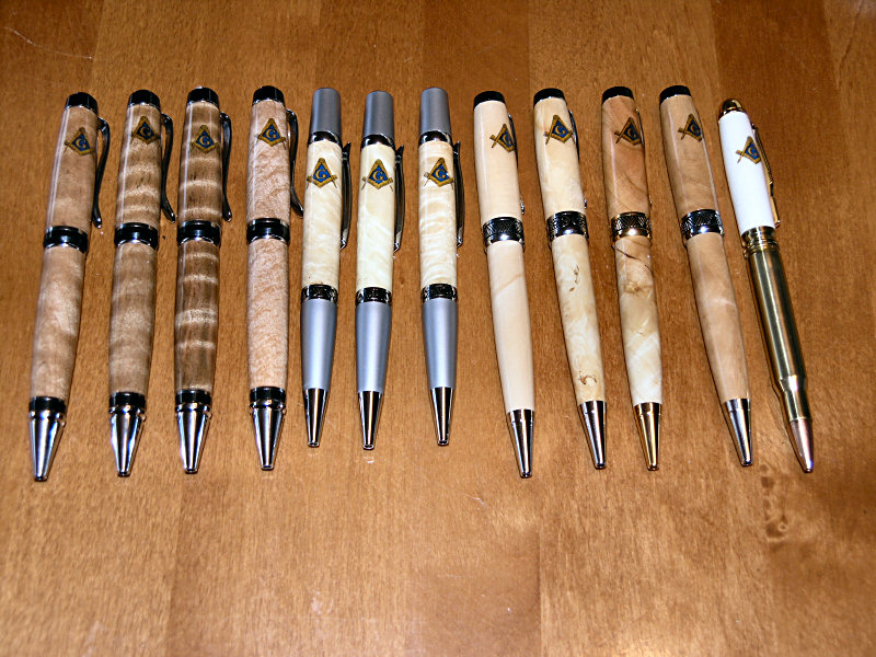

The wife's cousin called a couple weeks ago and wondered if I could make him some pens with a masonic symbol on it. Since I don't normally sell my pens and he is one her relatives that I actually like he got them at my cost. Woods used are curly maple, box elder burl, cherry and white ash. The cartridge pen has a piece of the moose antler he gave me a few years ago. It's for his father in law. Some are gifts for members of his lodge and others are for members of a lodge in the Caribbean they are visiting next month. The Masonic symbol was done using lasertran ink jet decal paper.

Go for it. I use the lasertran because that's the only ones I found locally. They dry with a white background but a coat of oil based poly turns it clear. On wood a coating of real turpentine essentially melts it into the wood then I just build it up with layers of CA until it's thick enough that I can get a smooth surface.

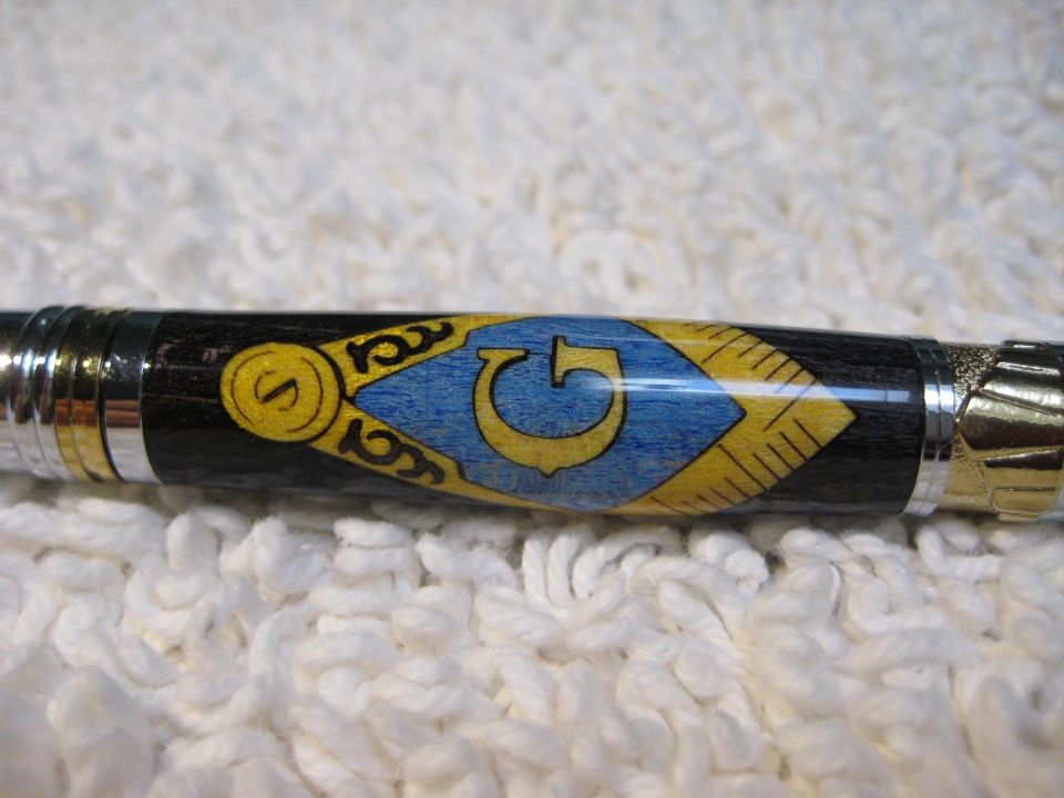

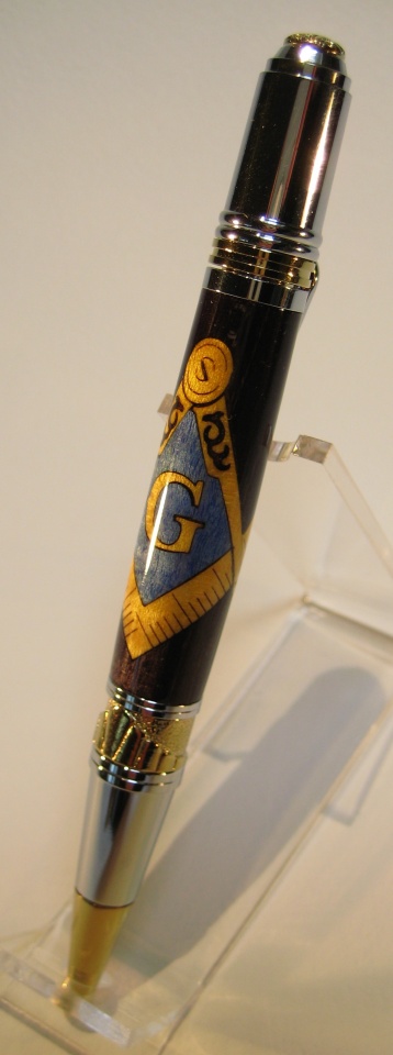

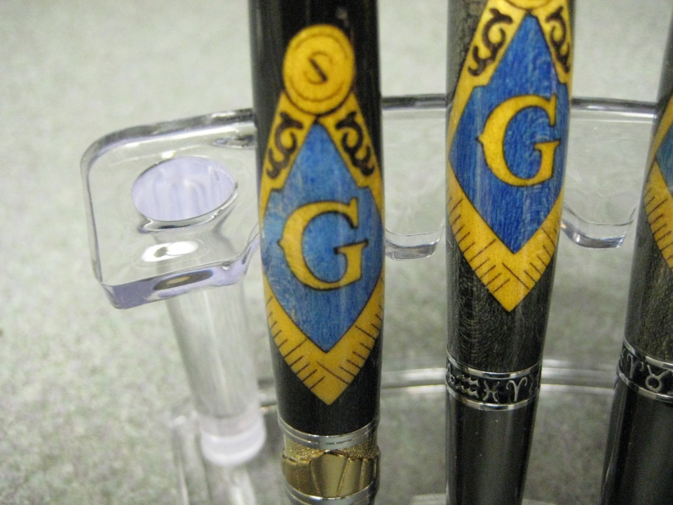

The Pens look great Rick. Your Cousin in law is going to be thrilled with them. I have been looking into doing decals. I finished a few laser inlays a week ago. First time working with them.
