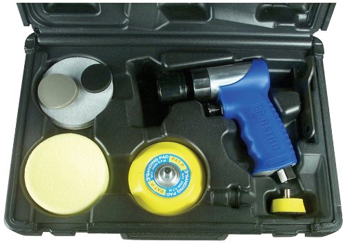

Let me back this up. I have about 6 random orbital palm sanders all various brands. Not what I am looking for. I want some thing smaller for detail work and yes left on the lathe sometimes stopped and sometimes spinning. Not that that matters when picking a tool. The small detail air sander/polisher that Pete posted looks interesting.

I did a quick look and looks like I have better options with air.
https://images-na.ssl-images-amazon.com/images/I/51jZadkeoZL.jpg
I was hoping you would jump in Ken. I will give it a look. I have the compressor set-up no problem there. Like I said I never really looked into a tool for sanding and polishing like this on a lathe but have a few projects in mind that would be beneficial for something like this. That is a nice size for pads too. Just thinking ahead. Always can use more toys.:biggrin:
