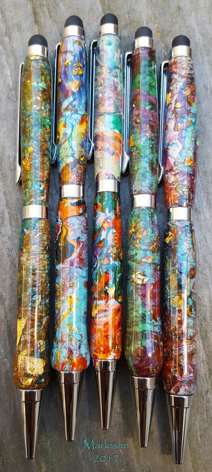

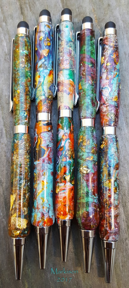

My little marbling adventure continues - including some marbling over various acrylic terrains and textures - will post about various techniques after some more experiments (fun ahead). This litter was born today (and I share Brian's/Ozturner's concerns about overpopulation):

Congratulations on the Delivery, of the Quintets Bob.
So glad you there to Assist,
Where would they be Without You?
They Definitely have the Family Resemblance.
I can't wait for your Next Episode.
To get all the Fine Details.
Great Work, my Friend.
Brian.

Bob, yet another batch of siblings....the family is growing!
Your ability to concentrate your colors into such a small pattern for pen blanks is unique! I have seen marbleizing demos with floating swirled paints but the effects were nothing like yours. Very Well Done!

Those are the best yet, Bob !!!!! . I am anxious to learn about your technique.

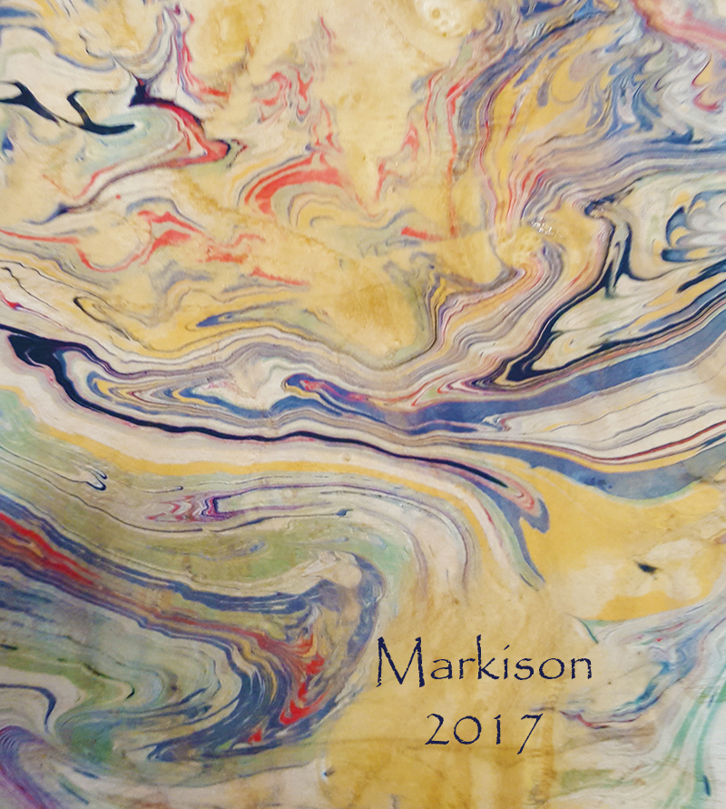

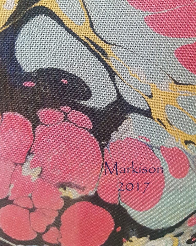

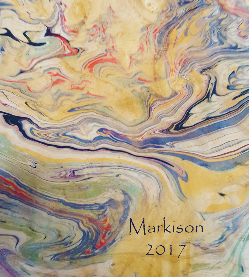

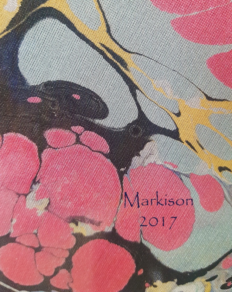

Mal - I'm still experimenting with various inks, dyes, paints, color wetting agents (to regulate float and spread), and mordants (to optimize adherence on porous surfaces) - will keep you posted - here are some tests:
attachment.php
Marbled ash burl veneer
attachment.php
Marbled habotai silk (close-up)
Warm regards and Happy Tuesday to all - Bob
(I learned a lot from a recent class with master marbler Pietro Accardi - still working on pen and general applications of this fun technique - will keep you posted)
