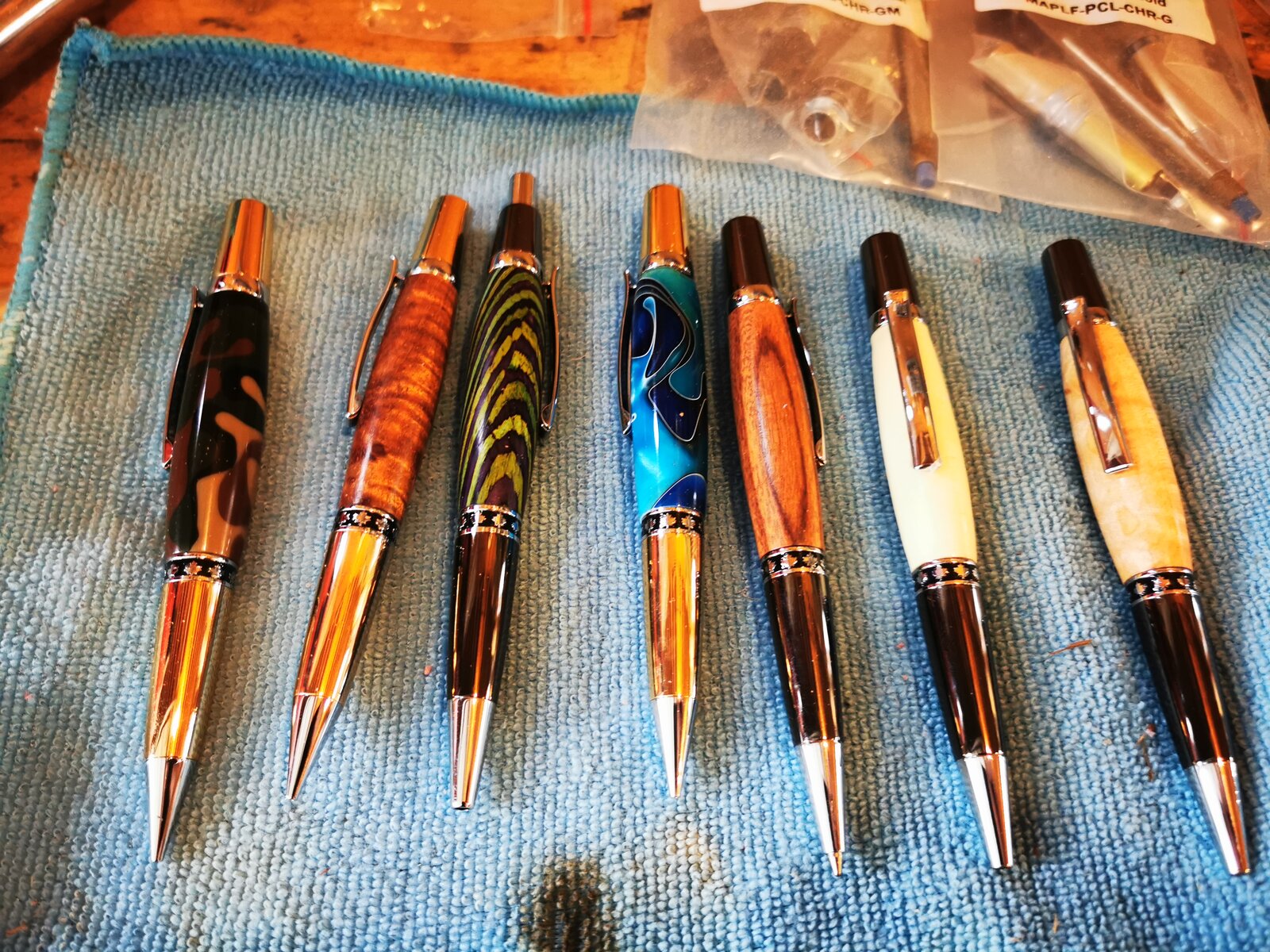

I picked up 7-8 of these pencil kits. They look great but the mechanisms seen like complete garbage. As it stands I'm not sure if I'm comfortable selling them.
Are all of the cheap pencil kits this way? The are a pain to replace the lead in. The lead seems to move when the pencil is lifted.
Any tips to making them work better or should I cut my loses and just use the blanks for pens?

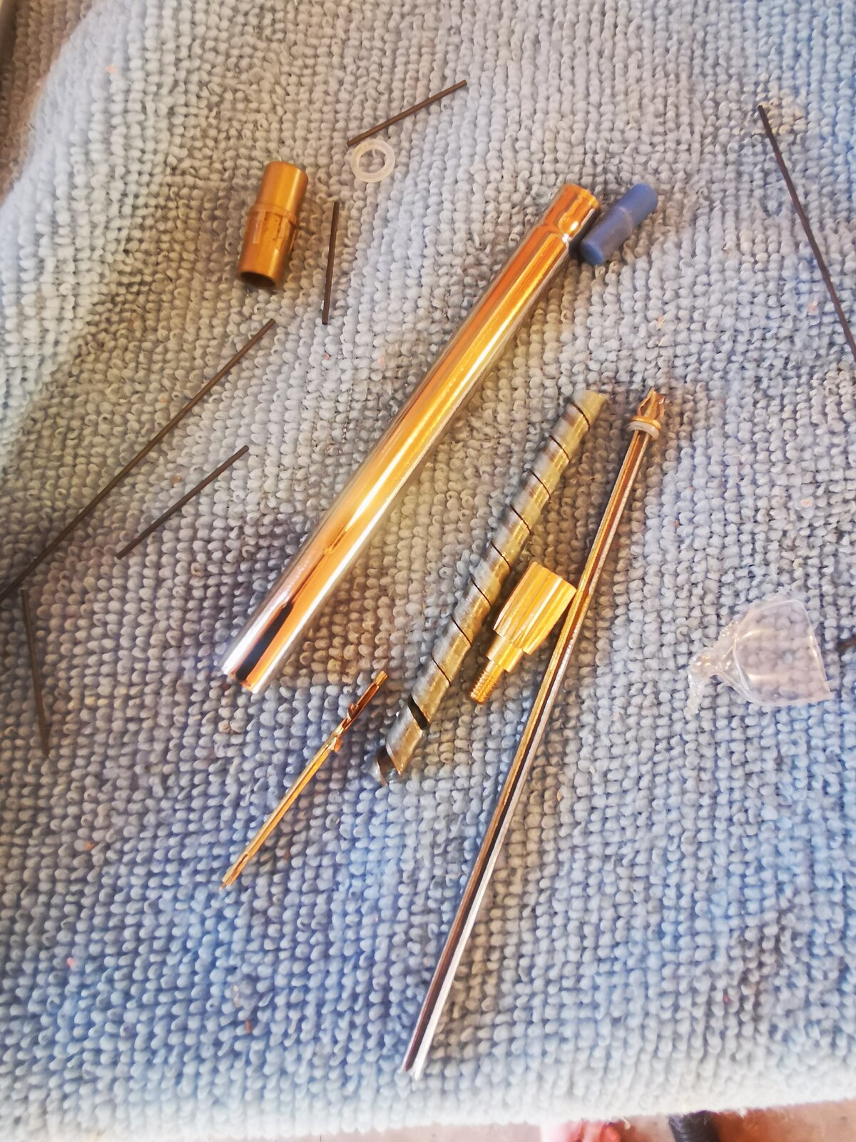

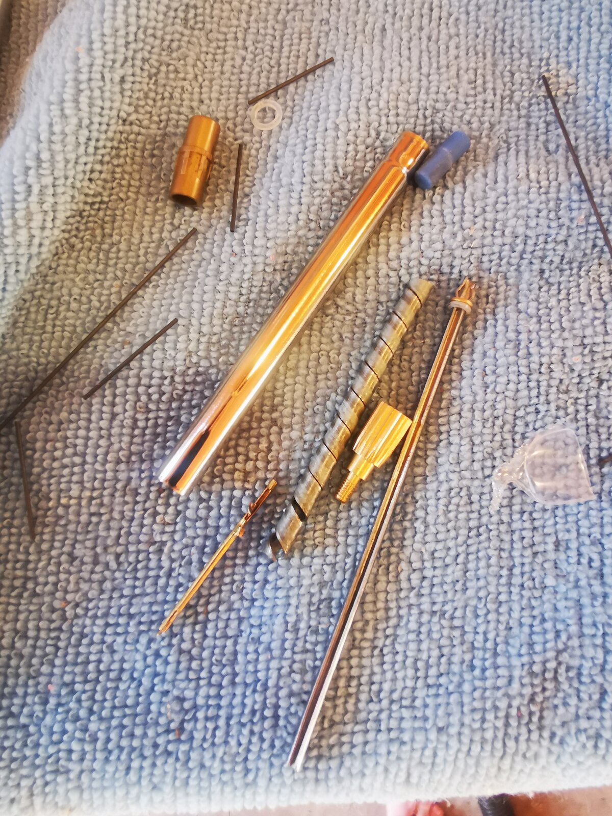

Sorry, I was frustrated and forgot to mention that these pencils use a twist mechanism. I ruined one so I tore it apart and i don't think there's anyway to make these ones work good. I see the site I got these from no longer sells the twist version. Just the click type with Schmidt inserts.

I didn't know that the Maple Leaf kit ever came with this style of pencil mech. If you got them from Wood-Write, ask Bill if he has the printed instructions for this mechanism.
These propel mechanisms, is one of the first types of mechanical pencil.
These mechs work well, Its just a different style.
When a lead is worn out, the last little piece is removed, and a new piece is pushed back in its place. The leads inside, under the eraser, are there for storage.
