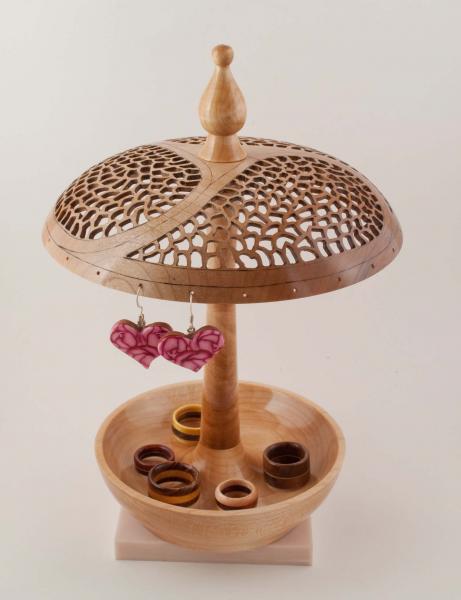

Maple Jewelry Stand with some wooden jewelry I made last year. The earring hanger has a pierced eternity wheel, and was made as a public demo at The Woodworking Show. The central post is around 6" (15cm) tall. Finished with Bush Oil and Polyurethane.

I think it's awesome! I'm with Super Dave... I've seen this technique before. I assume you are using some rotary tool. What kind of bit do you use to achieve that?

Beautiful, what did you use to pierce the wood with.

I did indeed use a rotary tool, a dental drill. I normally use an NSK Presto. I used a 699L burr.
This piece appears in Woodturning Magazine Issue #253 on page 9. This is the UK publication.
