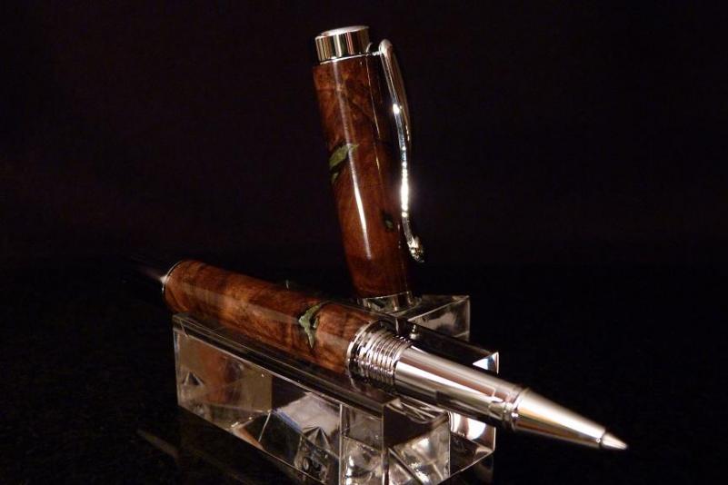

What you've encountered is a "void". Many burls have it, some more than others. At times, I actually seek out the voids so I can fill them with CA and PearlEX powder to add some color and accentuate the voids. What I do is (depending on the size to fill), add a drop or two of Meduim CA, then add a small amount of the PearlEX and spread into the void. Sometimes I need to do this more than once. Then remove excess material either by turning again or sanding. There are many different techniques to doing this and folks use different fillers as well as different glues.
Here's an example of a pen I turned for a client during Christmas. It's Claro Walnut Burl with the voids filled with green PearlEX. It's 100% smooth across the voids.
Oh and if you don't particularly want to add any color, you can still fill them to get that smooth finish. Just use instant coffee or cinnamon instead of the pigments and it will just look like a natural spot in the wood. I used paprika once as well, and it was so dark even it looked natural.

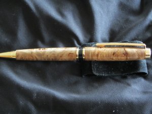

I've determined that the best thing about delaying posting the picture of the results is that in essence I felt the satisfaction of apparently completing this on Wednesday but as Chris pointed out, I actually didn't do it until I posted the picture. I get the joy of accomplishment twice. :-)
So ... here it is. Don't laugh at my photo. :-P Ok you can laugh at it. On the top of the pen, around mid clip is one of the more prominent voids. below that is natural color and below that was another void. The top void was made up of multiple segments.
On the bottom, the dark half moon near the center band was a void and down past halfway along the top edge were voids. Everything else was natural. There were some more on the other side.
That was the result. Maple Burl on a Woodcraft Hart double twist. Sounds like a type of dive in platform diving.

Turned out fantastic JJ!! love the grain and the filled voids just look like part of the burl. Great job and the more you do this, the more you'll experiment. :good:
