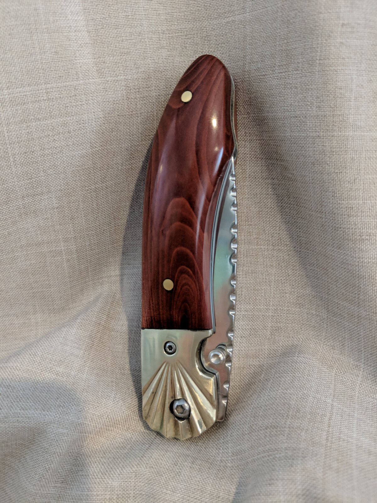

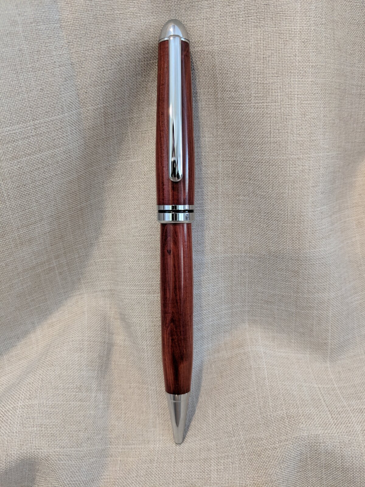

Here's a knife and pen I did with Manzanita that I got from my brother in law. Unfortunately, both the knife and pen were destroyed during the Carr fire in Redding California where the Manzanita came from. My source for the wood was also destroyed as my brother in laws home and property were completely destroyed by fire.
I found the wood to be easy to shape and turn on both the knife and pen. And as an added bonus, I had no idea it would turn out as nice as it did. The wood was air dried for about a year before I used it. Good luck and I hope you have the same experience as I.

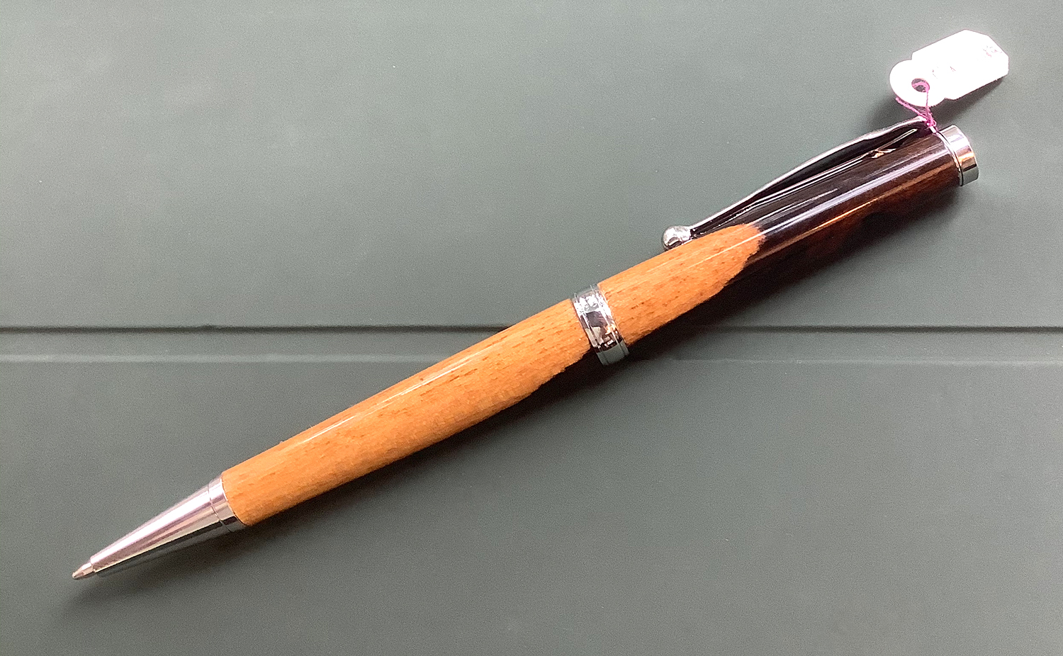

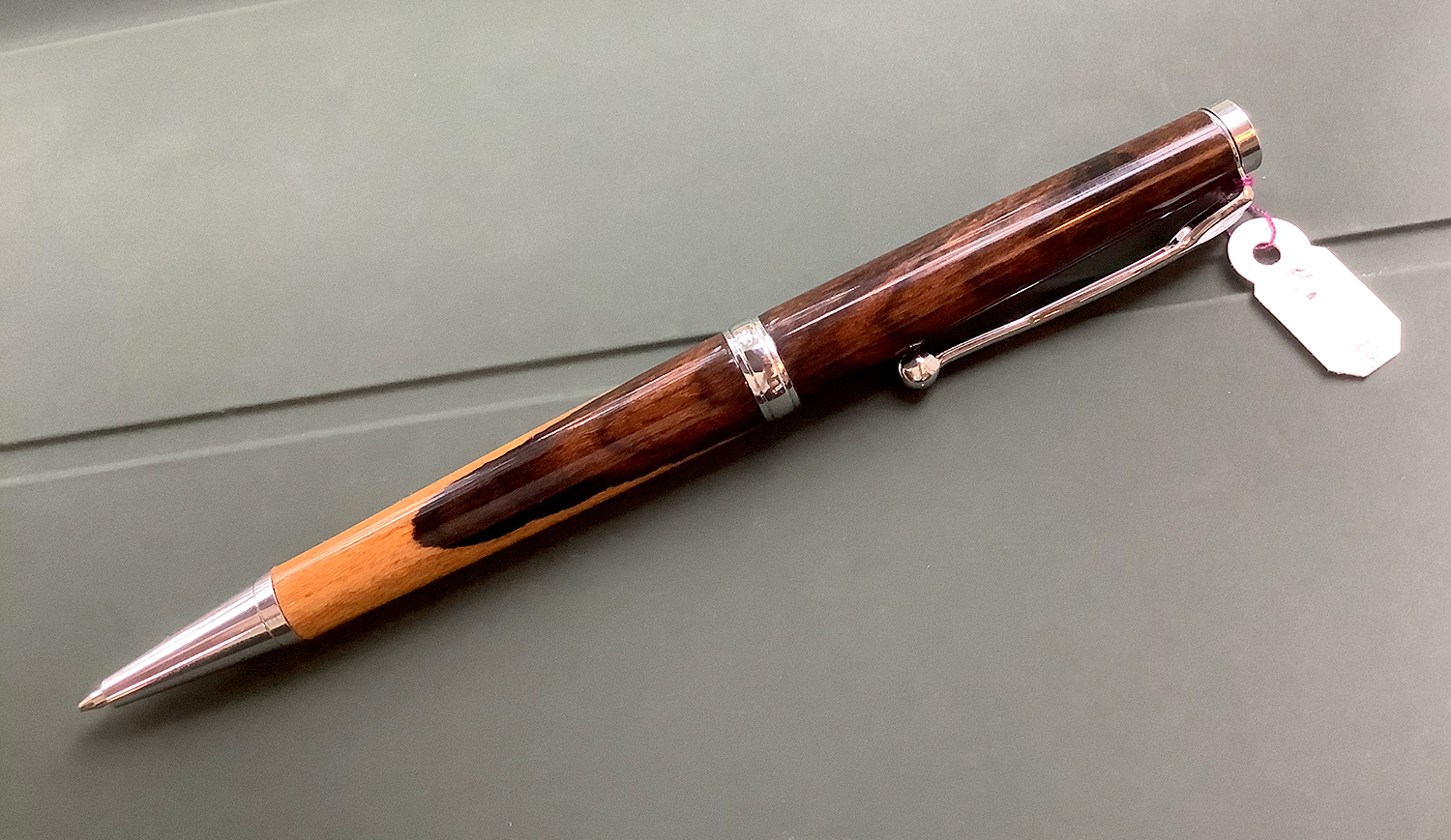

Here's a manzanita pen I made recently. The wood was dry/seasoned when I got it. It turned and took the CA finish well. It reminded me of oak. The lighter wood turned and sanded differently than the dark, if you have a piece like that.
