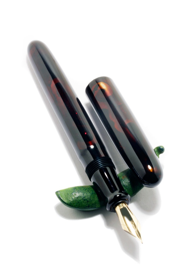

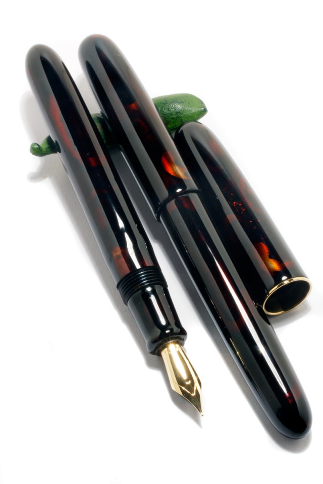

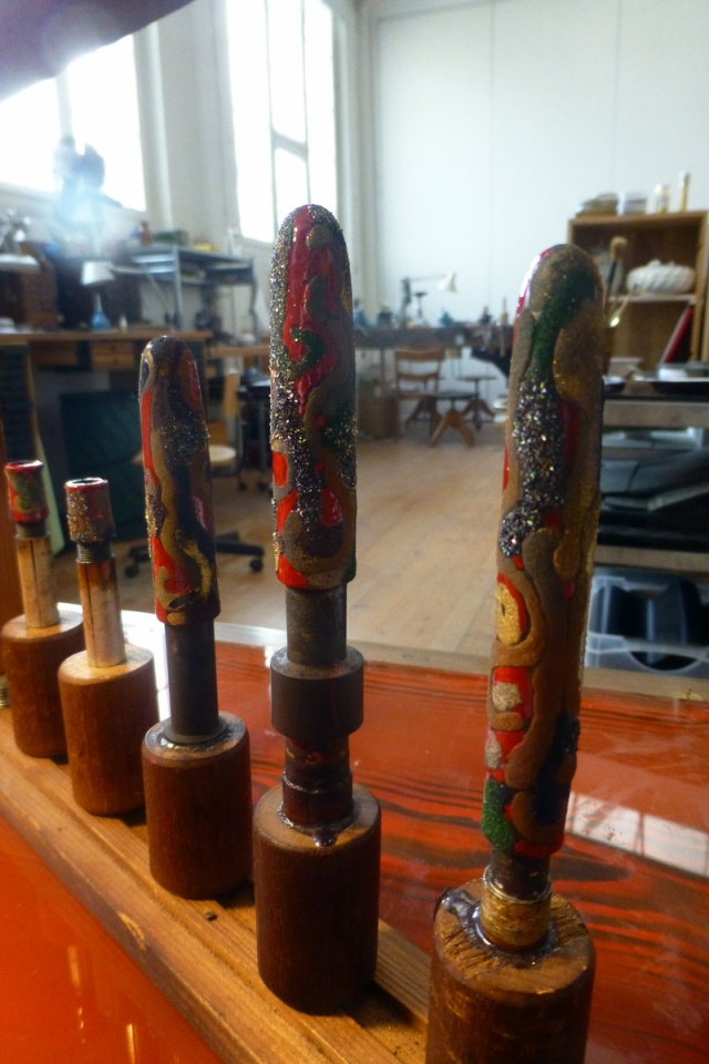

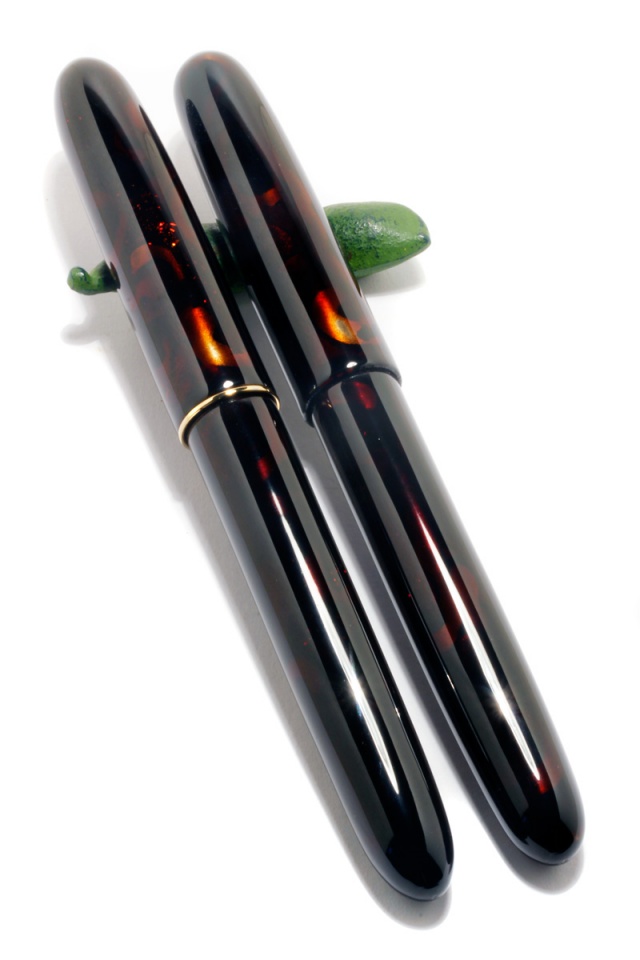

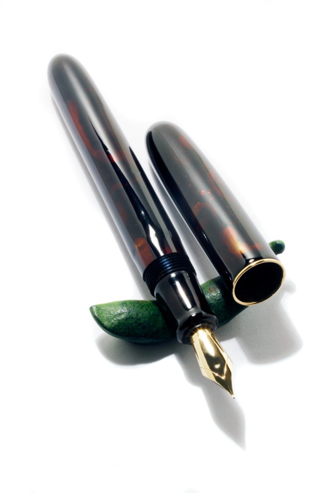

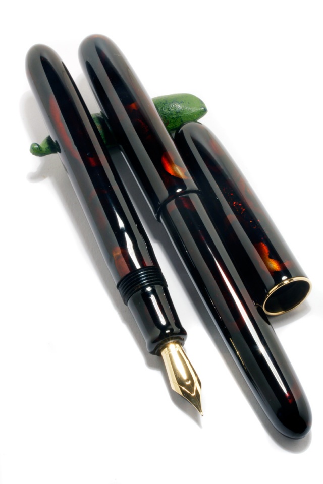

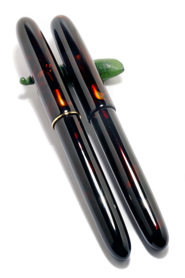

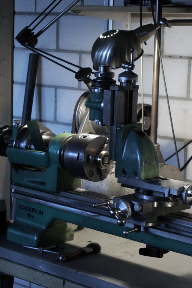

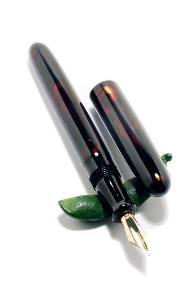

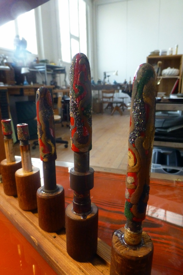

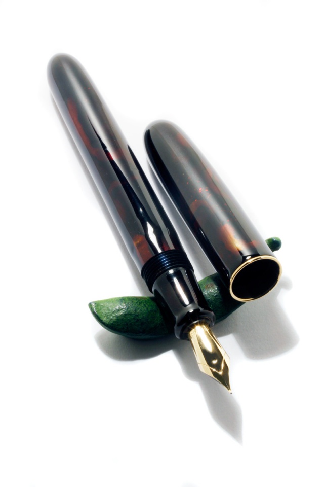

A month ago I started working on this lacquer. Some remember an earlier post showing the pens after applying metal powders in pattern on the pen parts This is what turns out after 30 layers of transparent urushi. The lacquer I call "tame-oshidashi-nuri". With the time the various pattern, material and colors will appear more and more because thetransparent lacquer will get more transparent.
Best regards,
Martin

Martin,
About 30 days for the process? Do you usually allow for 1 day per layer of lacquer? I know that you work on many pens at simultaneously but the process takes considerable time, and it is well worth the effort.
Beautiful finish. Thank you for posting these and thanks for that last picture. It clarifies your process. 本当に、どうもありがとうございます。
Absolutely Splendid work as usual Martin!
I too like the last pic showing the pen parts before lacquer. The texture is wild!

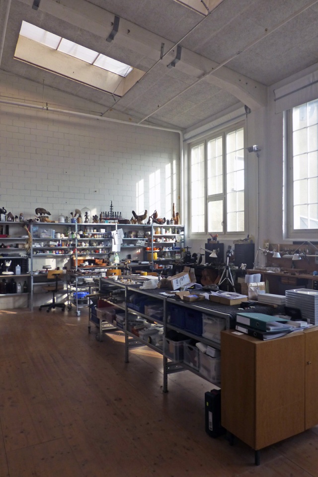

Also, wonderful shop space with the natural light.
Somehow you manage to outdo prior efforts which I felt were the very pinnacle of what could be done. The word penultimate comes to mind (which allows for 'pun intended' :biggrin:), in that you manage to push your artful work a step further with your latest effort, making the previous design the penultimate one. I think I understand how you accomplish this, in that you posses unbounded artistic talent, and are unwilling to let that ability become stagnant. So 'BRAVO!!' on this latest! :smile: :smile:

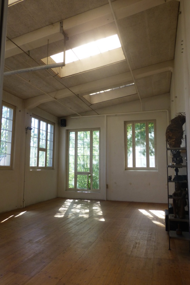

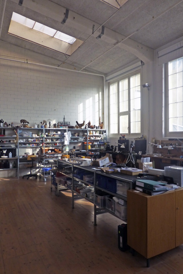

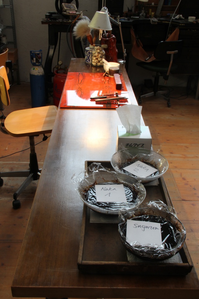

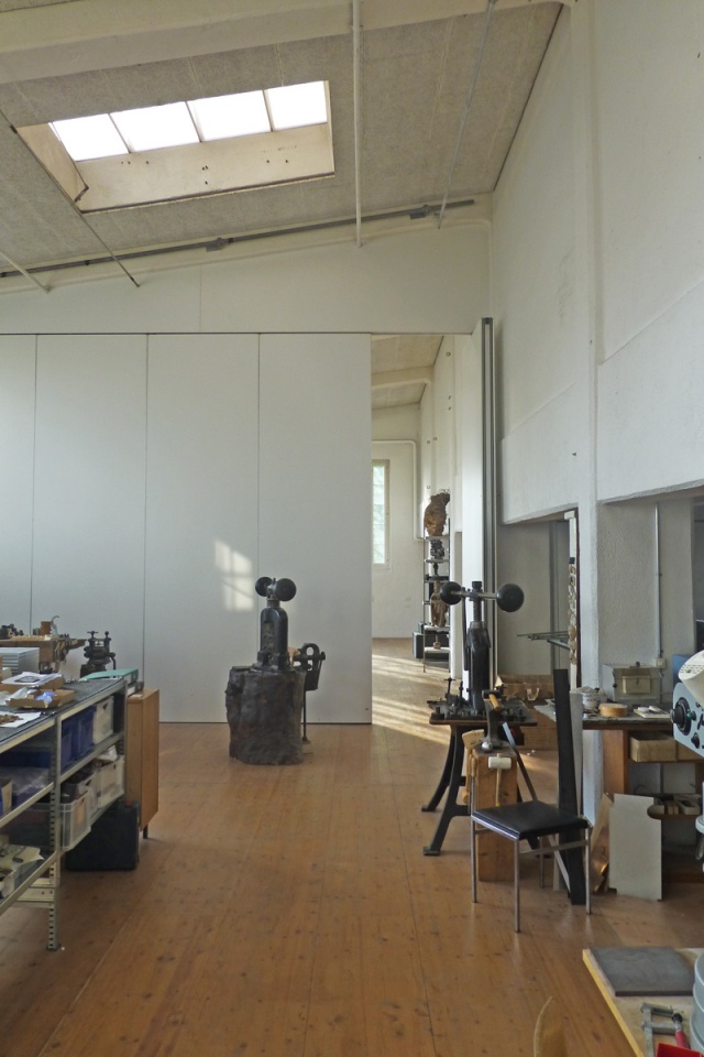

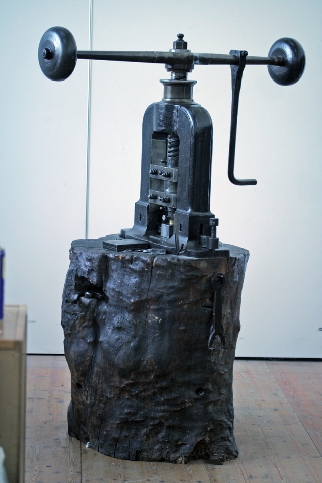

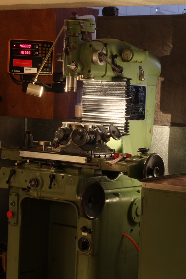

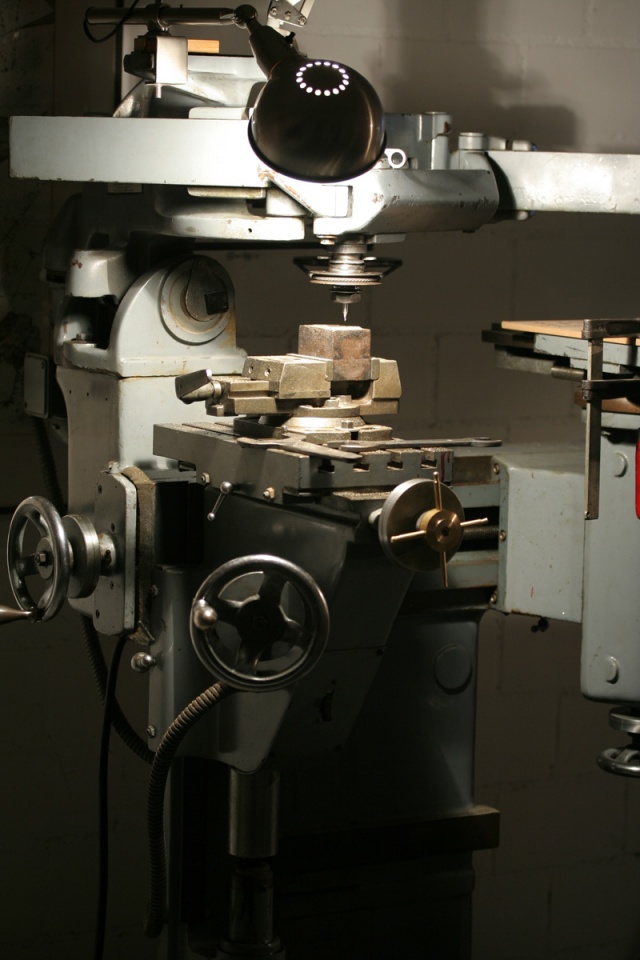

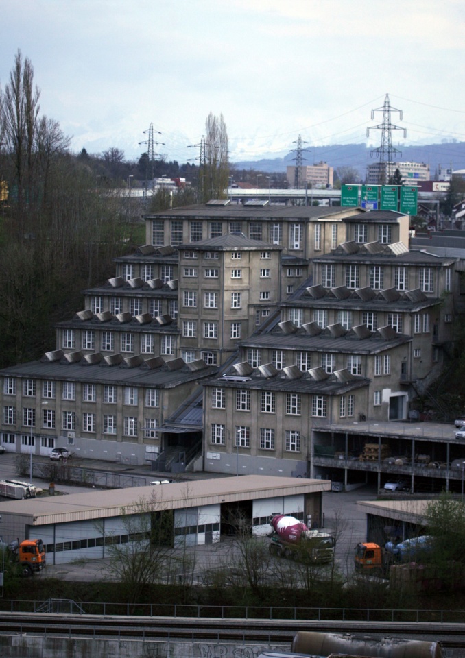

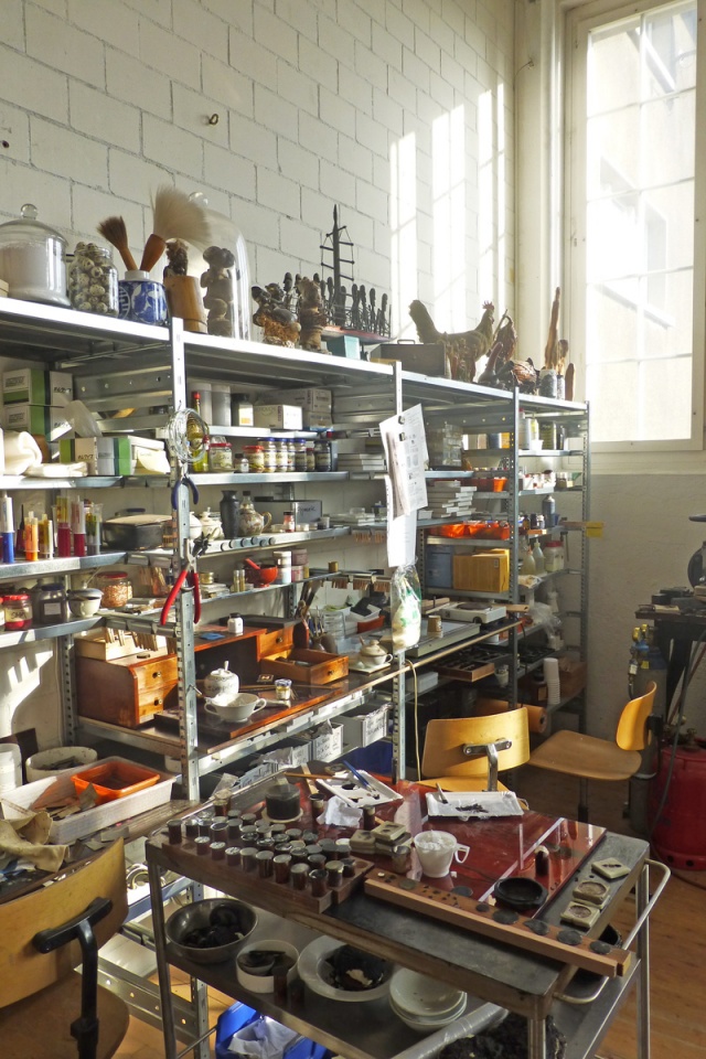

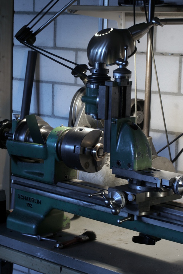

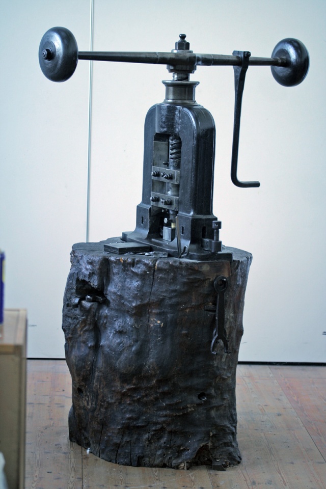

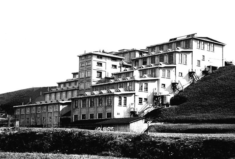

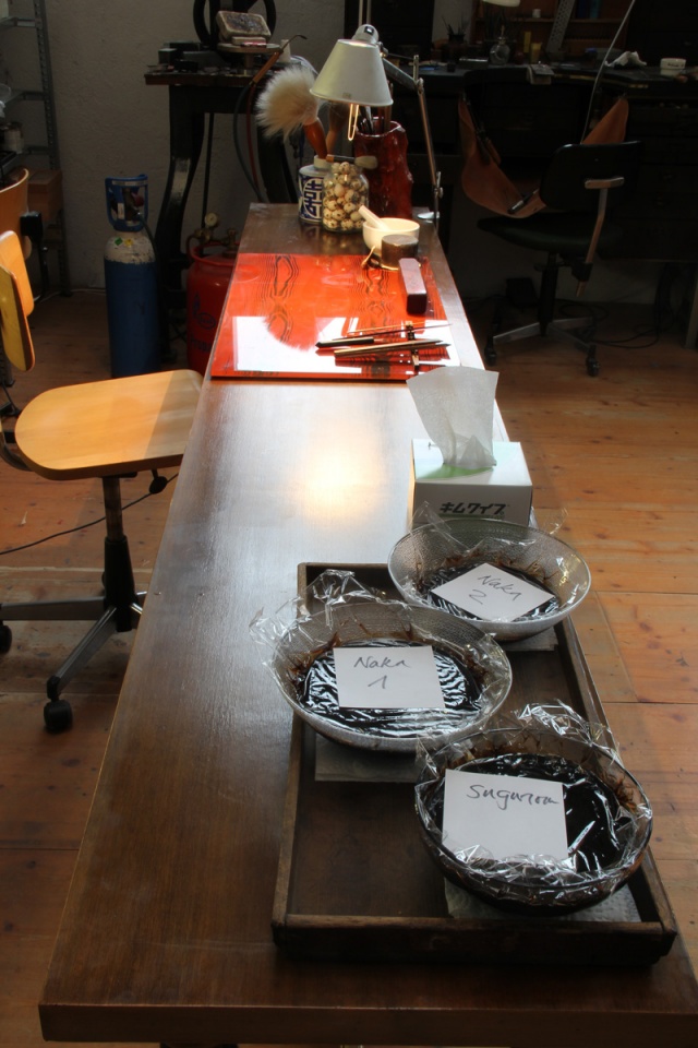

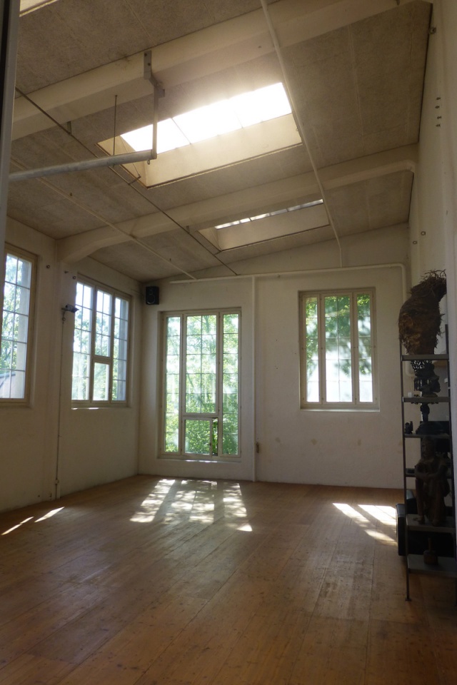

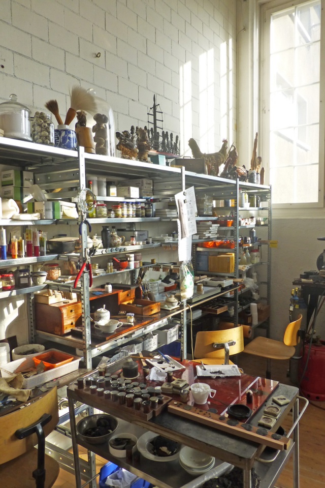

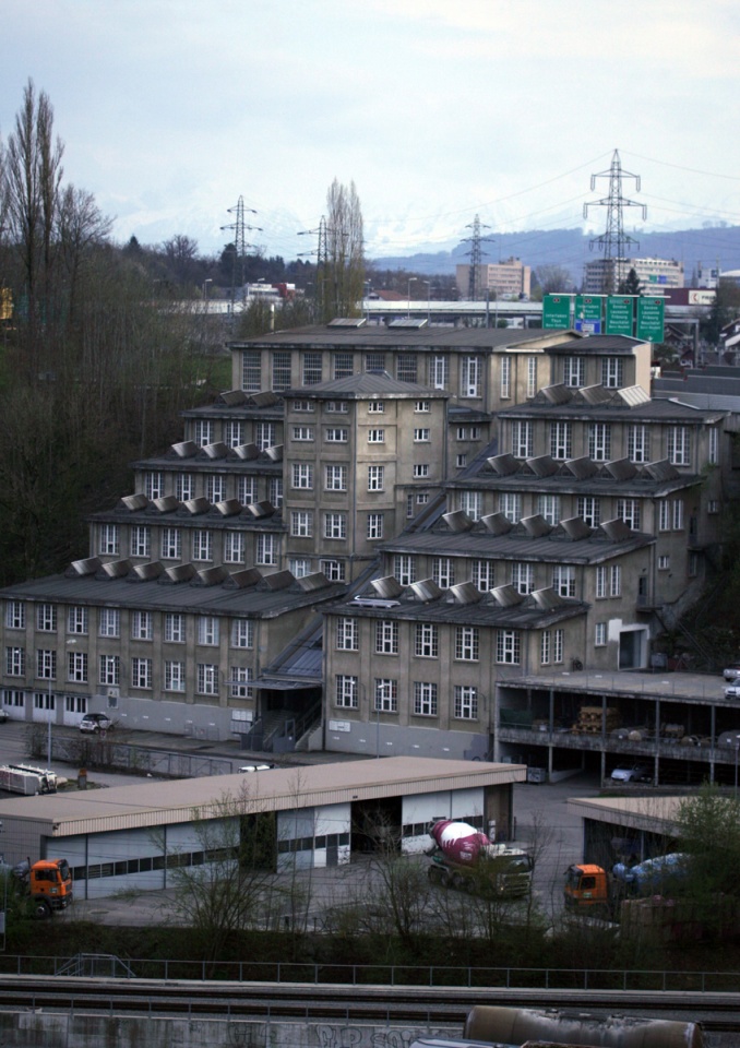

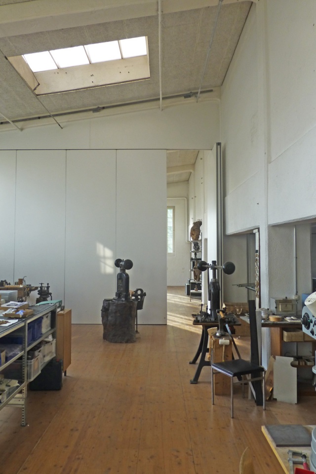

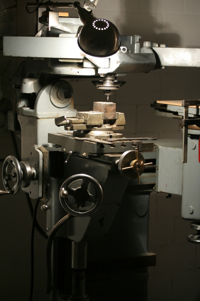

To flattering. here some pictures of my lovely atelier. I am very sure, that making nice things can only be made in a nice place.
I had the chance to set up my ateler in an old black powder factory from the turn of the century. It is a very inspiring place

Attractive, Inspiring, and Impressive !!!! ... that would have been the turn of the 20th Century !!!!
Martin, thanks for the add'l photos of the inspiring work place...it does seem conducive to creating beautiful results. That has proven true by the outcome, as seen in your work. Aloha!
