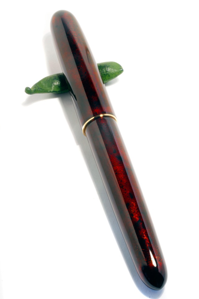

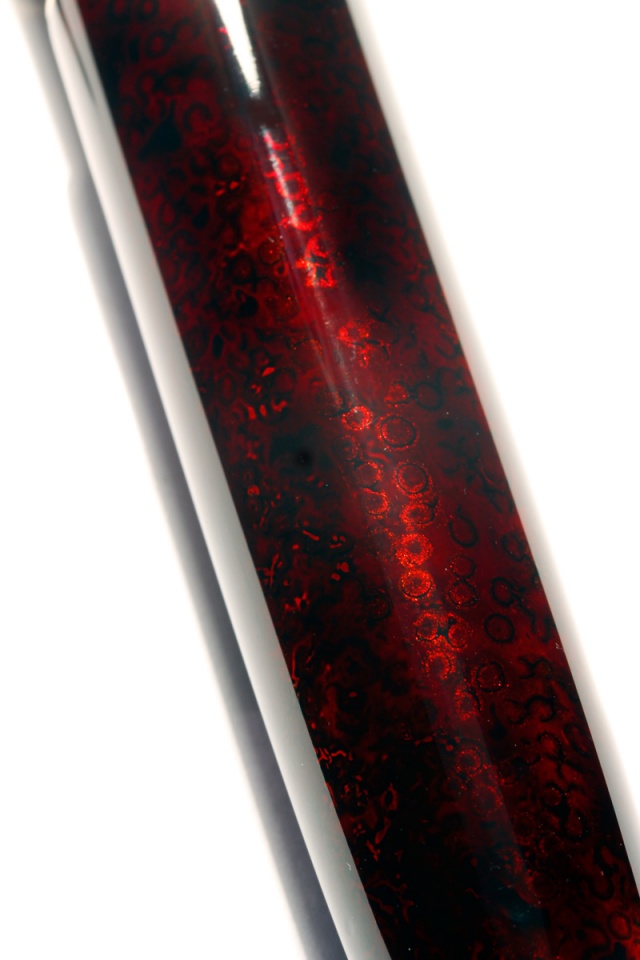

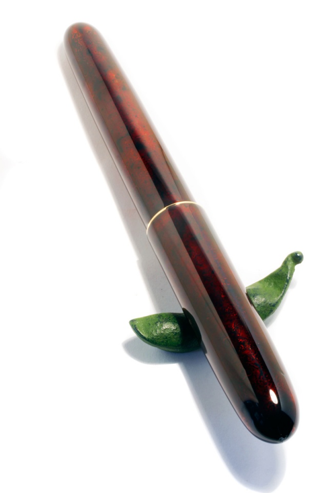

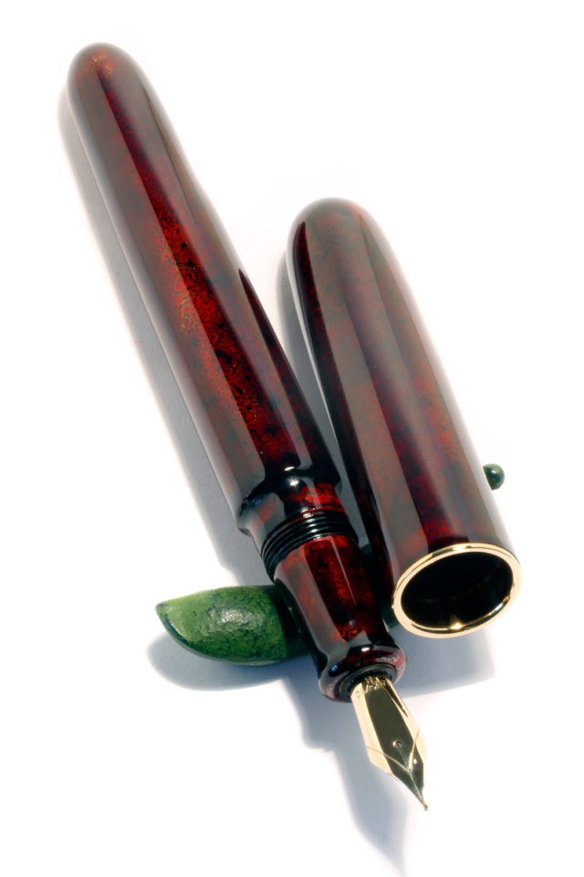

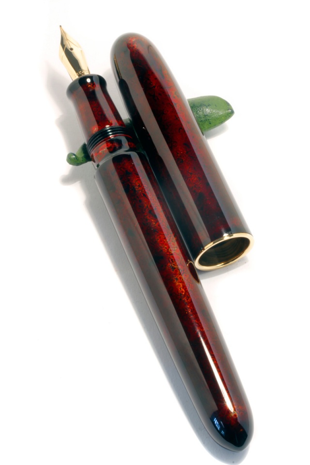

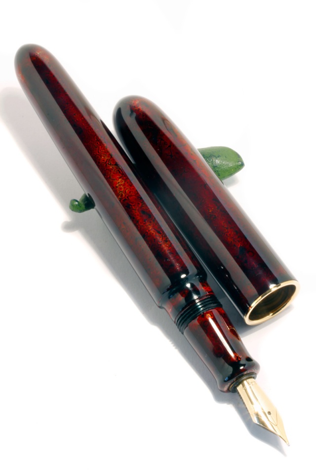

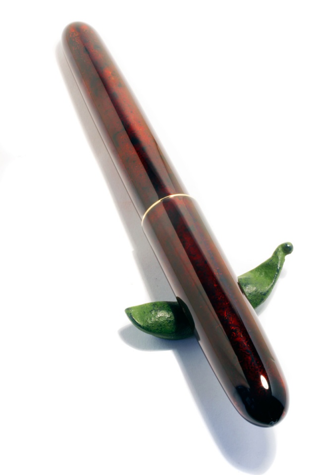

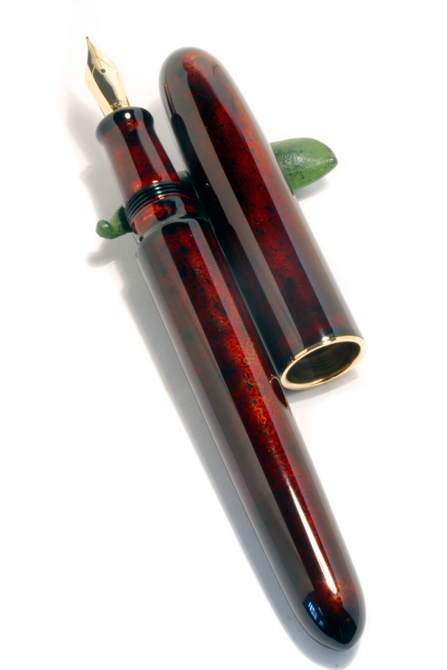

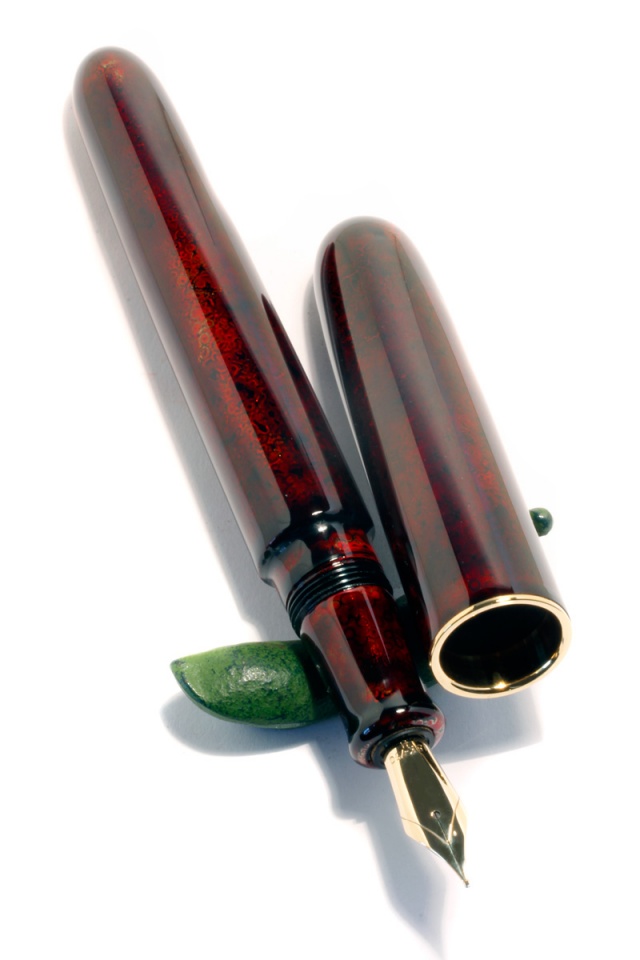

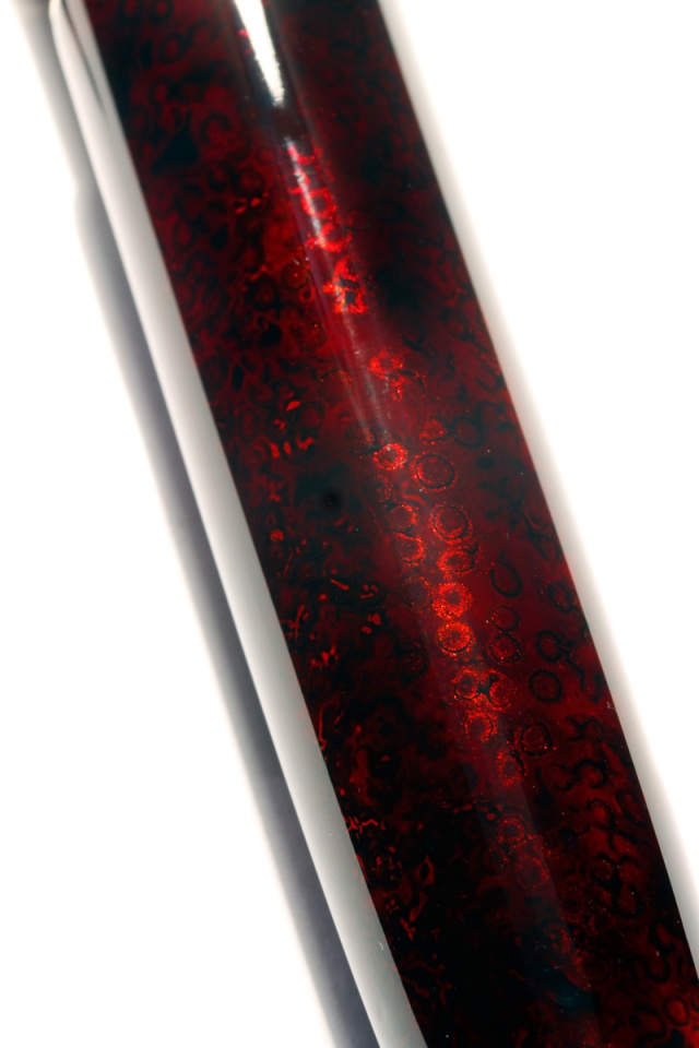

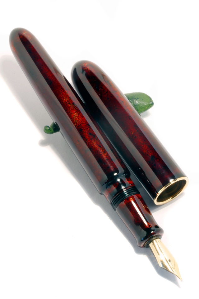

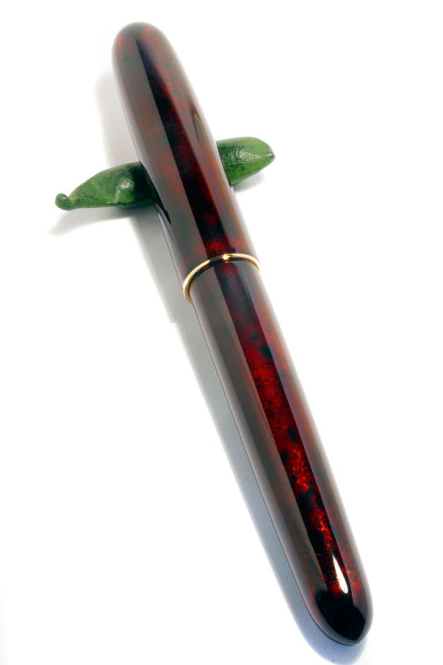

AKA-TAME-NANAKO-NURI
Aka = red, tame = transparent final coat, nanako = fish eggs, nuri = lacquer
Rapeseed is sprinkled on wet lacquer and removed after the lacquer has dried. Then, small circular protrusions appear. Colored lacquer is layered on top of this and then polished to make a textured ring spot pattern. With the years the transparent "tame" coat will become more transparent and release more of the nanako pattern

I would love to have a step by step process of how that effect was achieved. I think it is very impressive looking, & on the right "pen" it would definitely increase its value & appeal to the most discriminate of collectors.
"IF LIFE HANDS YOU LEMONS....MAKE MOJITOS!!!"
Thank you Ric,

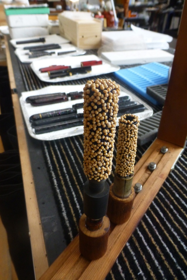

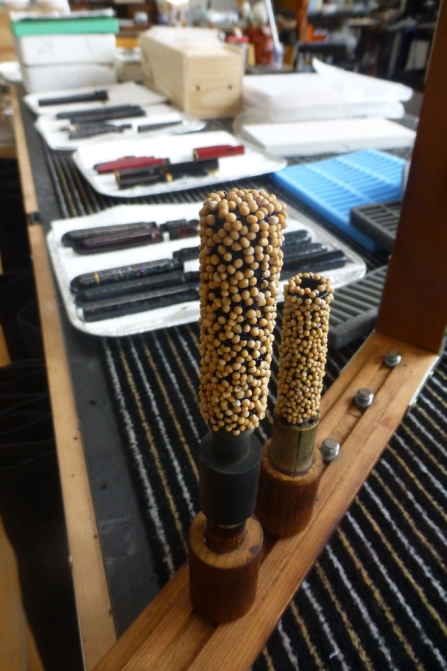

The only picture I can show is of a pen I made not with rapeseed but mustard seeds (little bit larger seeds). After the lacquer has hardened the pen is boiled in water until the seeds got soft and could be brushed off. Then several layers of lacquer follow. Finally the surface is ground flat to release the pattern. Then some coats of transparent lacquer are applied and polished.
