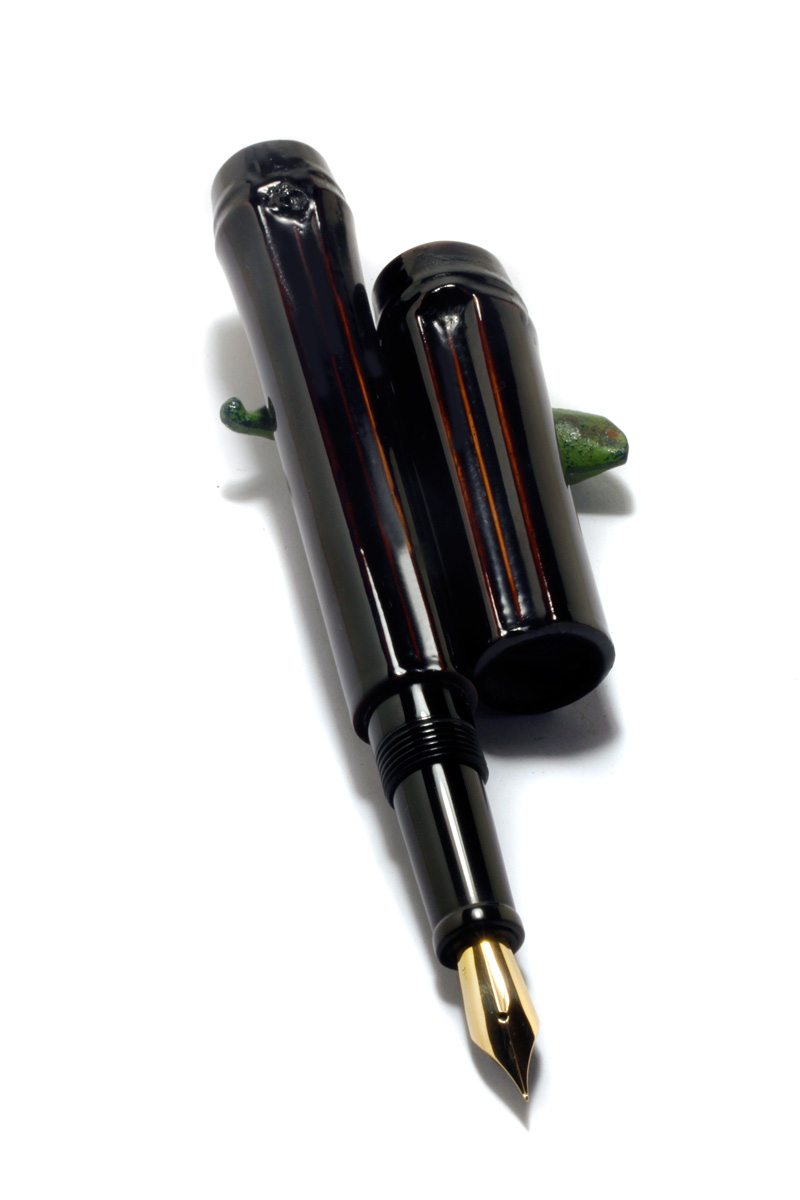

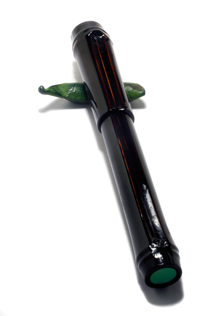

A Pen made from a piece of natural Bamboo, lacquered with transpaarent "Sukurome Urushi" Lacquer.

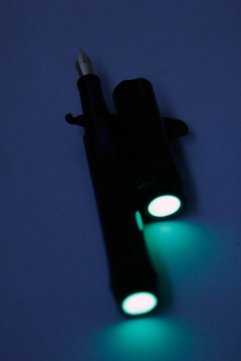

The nodes at the ends filled with glowing material. The maaterial made from Oyster Shell Powder and Acrylic.
