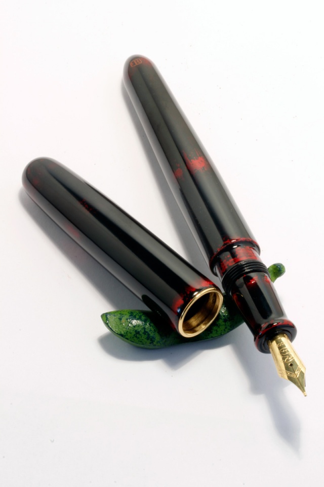

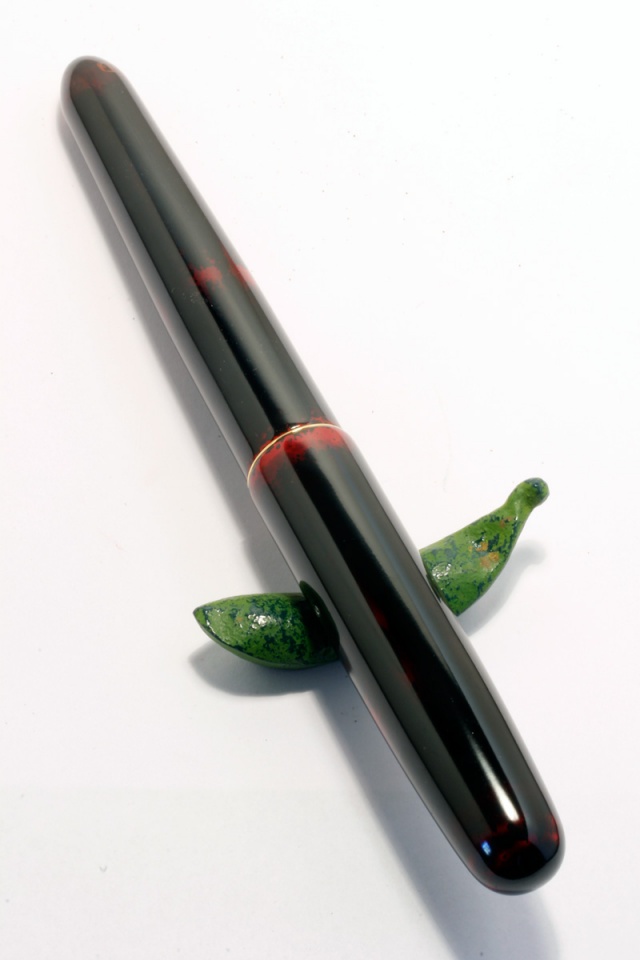

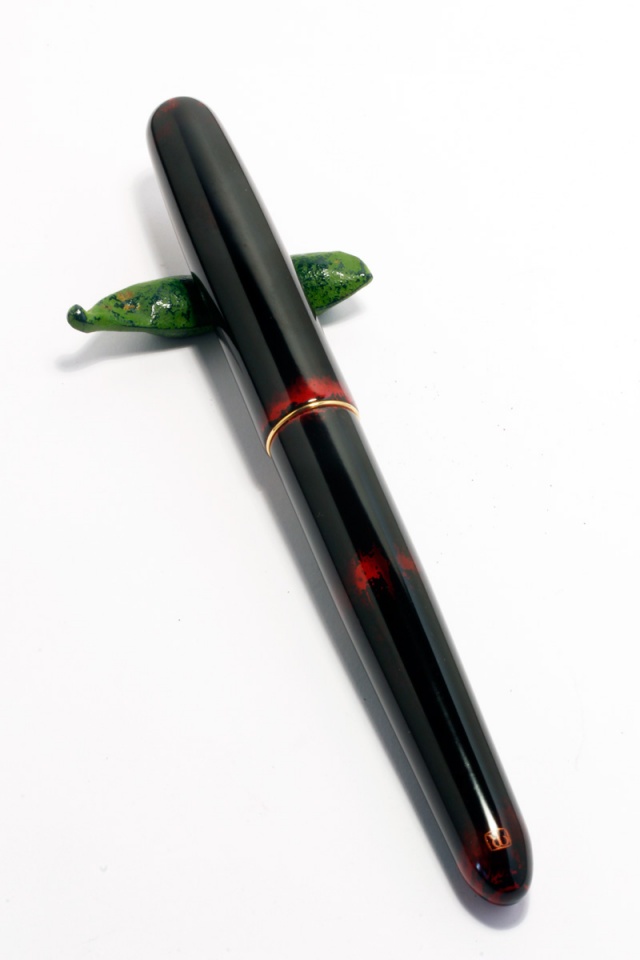

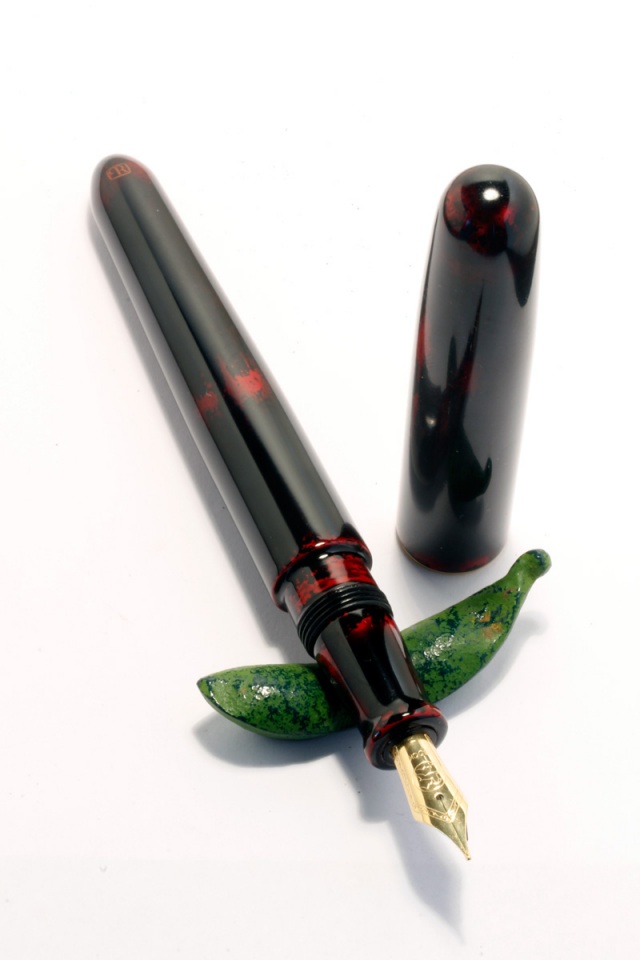

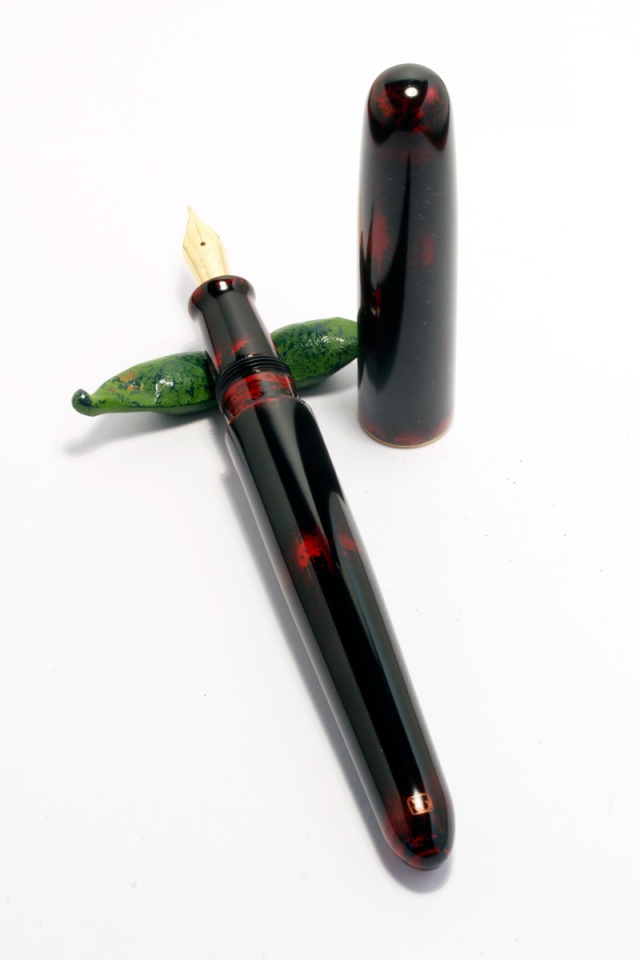

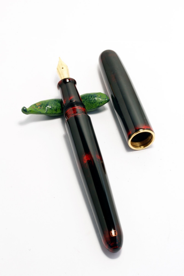

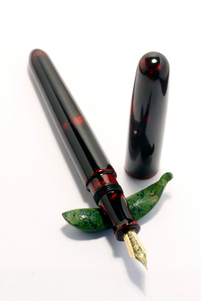

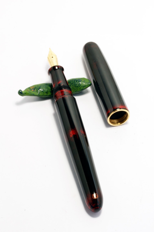

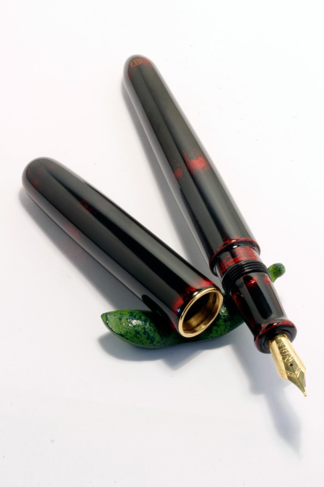

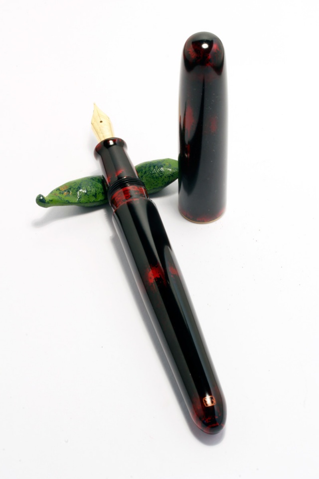

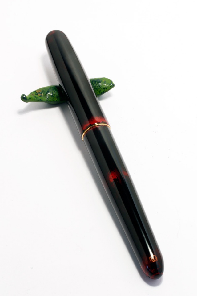

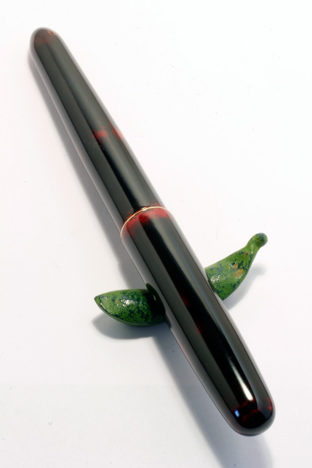

Hi,
I would like to introduce to you one of the fountain pens I recently finished.
It is an ebonite pen with 18 kt gold nib by Jowo. The pen is finished with an urushi lacquer technique called "Roiro-Shiage-Tame-Negoro-Nuri".
Thank you,
Martin

I am very impressed with your work shown here. The overall style is very nice, and very well complemented by the unique finish. I have no plans to attempt this finish, but see much in the way of inspiration with the design and quality of your work. Thank you for showing.

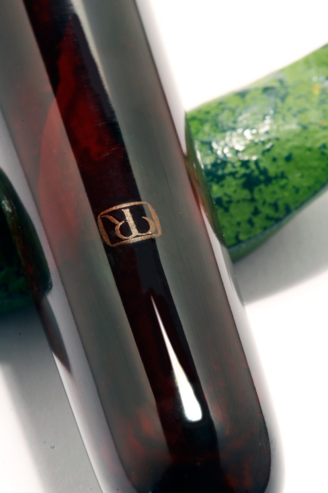

manupropria
Nov 2, 2014
520
Bern, Switzerland
Hello,
Thank you.

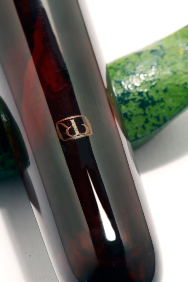

As a basic information: Urushi is a natural lacquer and needs to cure/harden/dry over a period of 24 hours in the "furô", a room with constant temperature of +/- 25°C and relative humidity of 65 to 85%.
The logo was pad printed with urushi lacquer and sprinkled with copper powder (maki-e) on the urushi surface after grinding but before "uwazuri".
Uwazuri is the term for final preparation for mirror polish. Sevaral times trasparent high quality urushi is rubbed into the surface and wiped off completely, then hardened in the "furô" for 24 hours. This is repeated 6 to 7 times. Then the urushi surface is polished with a special polishing powder called "migako" and rapeseed oil. After cleaning again transparent urushi is rubbed on and wiped off. After hardening the surface get a final polish by migako and the finger tips.
