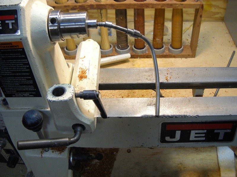

Have ya ever seen a mandrel like this?

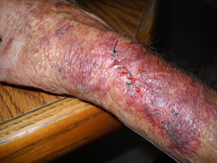

Have ya ever seen an arm like this?

Holy ouch batman!!
Looking at the chunks out of your lathe bed, I'm amazed the arm isn't worse off!
How on earth did you do that? Please teach us so that no-one else EVER does that!
Thank the Lord you are ok. This is crazy. I can't imagine the series of event that set this in motion? I pray for your speedy recovery.
Had the blank and bushing on the mandrel and the last spacer bushing wouldn't go on because of a spot of glue. I turned the lathe on to hit it with sand paper as i've done many times but not with a blank on the mandrel. The next thing I knew the mandrel was woopin up on me. Bet I won't do that again. Feel like a real dumb ###. Thanks for the well wishes.

In my case, the tailstock wasn't locked down tight, so it moved
back a tiny bit as the lathe was spinning. That backed the live
center out of the end of the mandrel, which left it free to whip
around at will. (another reminder not to use mandrels that don't roll
perfectly flat on the table)

It had not occurred to me that a mandral would do this, without the tailstock live center in place. It does make sense now that I think of it; the inertia of the blank at high rpm.

1. I never use a full length Mandrel only turn half a pen at a time.
2. I house the end of the mandrel 3/8 of an inch in the live centre using a brass slip fit.
3, The head stock end of the mandrel with a threaded insert is locked into the other end of the head stock.

that looks like it hurt bad. glad it wasn't worse. Makes me glad I started turning between centers and don't use mandrels any more except 1 as a pin chuck occasionally. 1 less way I can hurt myself.

the extra weight of the blank created enough centrifugal force to bend that mandrel and whoop your arm. sure hope you are okay, or at least will be okay. good lesson for the rest of us as said.

Thank you all for your support. I change the bandage every day. looks like it's healing nicely. The laceration doesn't hurt as much as the brusing all around it. Thanks again ya'll.

Also from looking at the front edge of your lathe it looks like
its been hit a few times with pretty good force.
