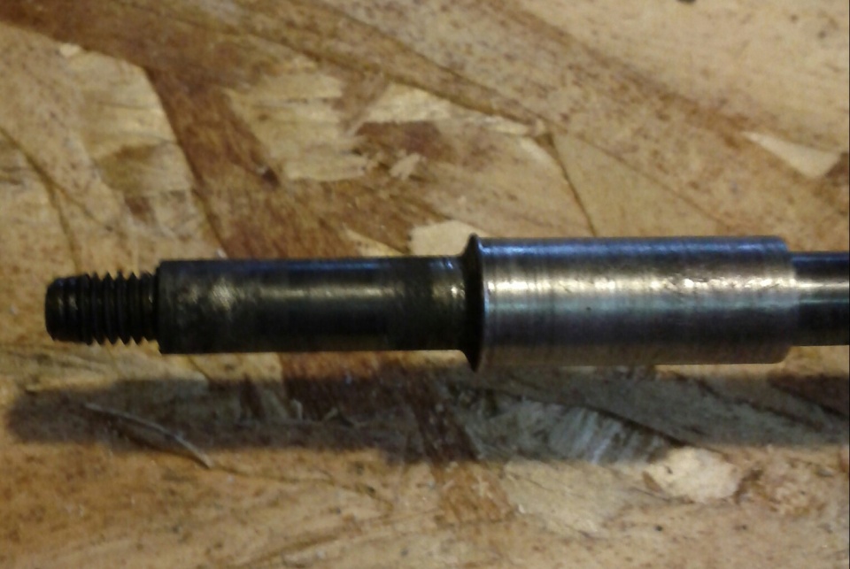

First and foremost I want to say "Thank you!" to this group and it's members. I'm new here but have been lurking for quite some time.
I'm a newbie making pens, I just recently got my lathe (Thanksgiving-ish) and decided to make some custom pens for family for Christmas... I am now hooked and I can't stop buying kits and blanks and... everything. lol
Anyway, my mandrel question is this.
I have a basic mandrel and a mandrel saver. Most of the single barrel kits require spacer bushings at the head-stock end of my lathe to get the barrels out over my ways so I can turn them far enough away from the head-stock.
Being a newb, I have a tendency to over-tighten my tailstock to stop my blanks from spinning, especially when I forget to turn my lathe speed back up after finishing my last pen....
In doing this, I've managed to jam a spacer bushing hard enough against the head-stock to actually crimp it ON to the mandrel. While hand-turning for with-grain sanding, the mandrel tends to come unthreaded from the MT portion and now that bushing will not allow the mandrel to thread.

Have you tried putting the bushing in a vise, drill a piece of wood part way through with a 7mm bit to make a protective cap for the end of the mandrel, and tapping the mandrel shaft out of the bushing with a light hammer or mallet?

Ouch. First on a mandrel setup the screw is used to determine torque, on the savers that would be the tailstock. It really does sound like you have some bad habits and keep that in mind as you work more and more with delicate things.
When you over tighten things the shaft of the mandrel tends to warp, also the squareness and shape of the bushings and mandrel are at stake so likely yes you may need a new mandrel
After you find a way to remove the stuck bushing you may want to use something different for the space. Maybe a pen blank cutoff drilled and turned round as a spacer instead of the bushing. Use a piece of pen blank long enough to get the space you need between the headstock and the blank being turned. There may be other solutions. I too would like to see a picture.
To keep the blank from spinning should not take lots of tail stock pressure. There is some reason this is happening. Are your blanks longer than the tubes? Are you using the proper bushings? You need to analyze your situation and figure out what is happening. Picture please.

A picture would really help - I'm struggling to understand how a bushing could get mechanically jammed onto a mandrel. Are you sure it's not just glued on with finish?
The worst case is that you will have to replace the mandrel and bushing. But a simpler solution could be to try to unwedge the bushing. If it's glued on with surplus finish, soaking it in acetone should loosen it enough to be removed - and save everything. But if it is really wedged mechanically, you might have to grip the bushing with pliers or a vice-grip, and then twist it off. That may save the mandrel, but it could also sacrifice the bushing.
I also am having a hard time envisoning how a bushing could get wedged on. But that aside, a new mandrel rod is only around $10. Never hurts to have a spare or two around. They do get bent and banged up eventually.
Allow me to break it down for you.
The bushing has a lip on it.
The mandrel shaft may not have been screwed down securely causing a pull to produce a lip by the threads.
The tension of the tailstock forces the bushing's lip to curl and the mandrel's lip to curl.
These two curls interact with each other causing a pressure fit and hard to remove.

Here's a pic.
I "think" I've attached a picture correctly.
The left end in the pic is what threads into the MT #2 that slides into my head-stock. I do not own a chuck, but I also don't own a short tool-rest so getting close to my work requires me to space the blanks out from the head-stock, thus the spacer bushings (I usually use 2-3).

Looks as if it has spun on the shaft and welded itself together...
Definite possibility. Or the crud to the left of the bushing could have helped it become one with the mandrel rod. I wonder if it isn't time for either a new rod or one of those adjustable mandrels.

Wow that does look like a problem! My suggestions:
  1. try Sharon's approach, but that sucker could be welded
  2. try some torch heat on the bushing while using Sharon's approach
  3. take the free one from Lance.:smile: Many of us have old mandrels that we have abandoned when moving to turning between centers

Well, I tried.
I believe that is what has happened. I got in the shop this past weekend and tried the vice/mallet approach. I couldn't move the thing. Not even a little bit. So, I took an old hand-chisel and cut about 1/16 of an inch off the bushing on the side closest to the threads to allow it to thread into the MT2 so I could do a pen for my wife.
