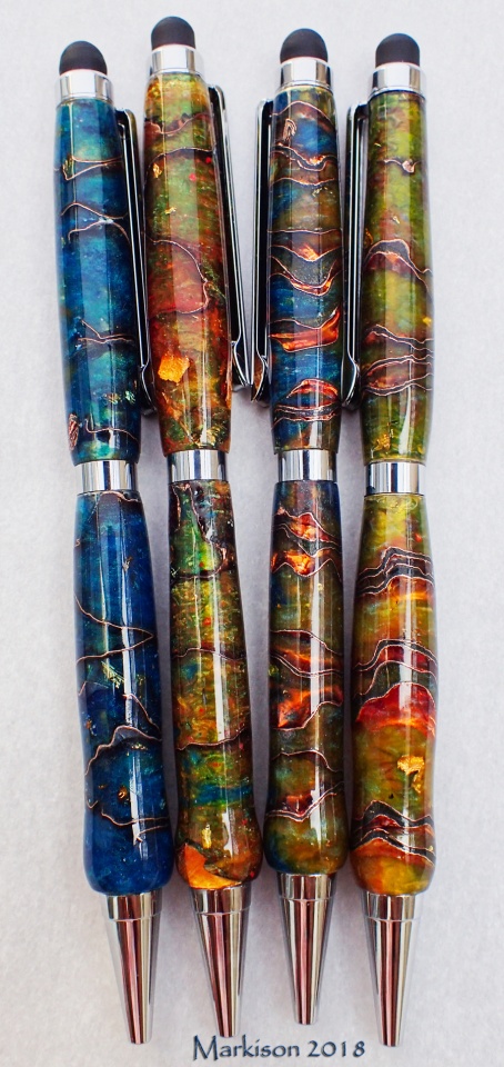

I was watching one of these fabulous little guys (Mandarinfish, Synchiropus splendidus, Australia/Western Pacific) at the CA Academy of Sciences:
attachment.php

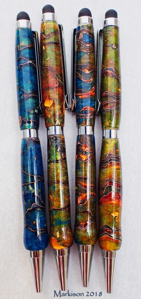

Tiny light bulb lit up - how about some penimitation (highest form of flattery)?
Steps:
Shibori-dyed some 8 momme Chinese habotai silk with Jacquard silk dyes; then steam fixed the silk in parchment packets.
Cut some acetone-washed copper foil strips; then painted them with Pebeo Vitrail paints, dried for a week.
Adhered the painted copper foil to the dyed silk to make malleable fibro-metallic composites.
Accordion-folded the copper-silk strips, then punched 7.1mm holes through them.
"Threaded" the strips onto sanded and surface-textured Vitrail-painted brass tubes; folded the serpentine strips in a random way.
Tube-in cast the blanks with Douglas and Sturgess PR at 50 psi.
Turned and finished them as usual:
attachment.php
Happy Sunday to all - Bob
PS: I took some pix along the way - glad to post if there's some interest in this little technique.

Another Incredible Technique Expounded, by The Master of Innovation, Bob of San Francisco.
I read your, what I am sure is an Abridged Process, several times and I am in Complete Confused Awe.
Disregarding, my Inadequacies in Matters Artistic, General and Specific, (that sounds like something that Gilbert and Sullivan, would have used), Bob you have presented yet another Incredible Unique Process for the Adornment of your Pens.
The Results are Absolutely Brilliant,
Continuing Congratulations, yet again My Friend.
Brian.

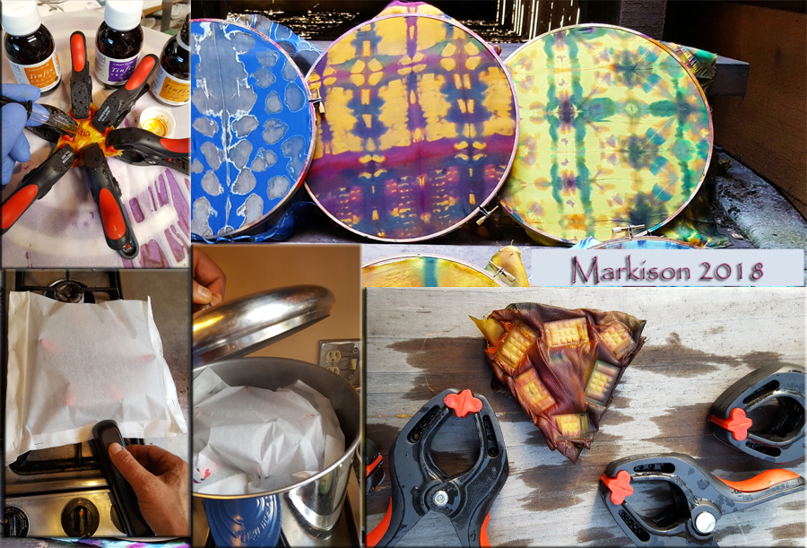

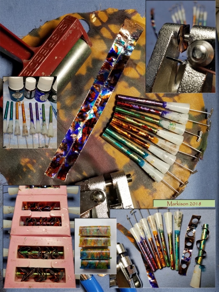

These pix illustrate the key steps:
attachment.php
attachment.php
No fish were harmed in the production of these pens.
Warm regards to all - more fun ahead (as always) - Bob

Absolutely stunning Bob. Your work continues to amaze and inspire me. Thank you for the process pictures.

Yet another absolutely beautiful set of pens Bob! I've said it before but this only makes me wonder even more: Is there no end to your creativity? Wonderful job on these ones, as usual.
