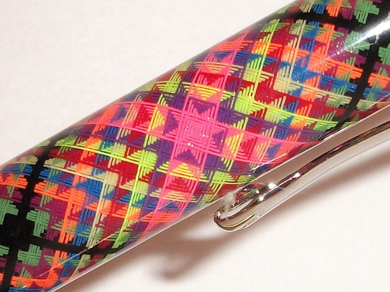

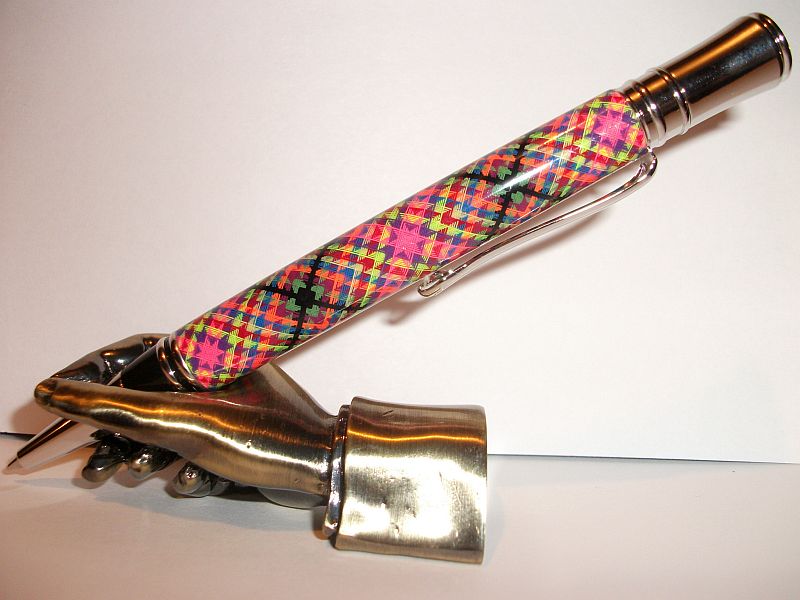

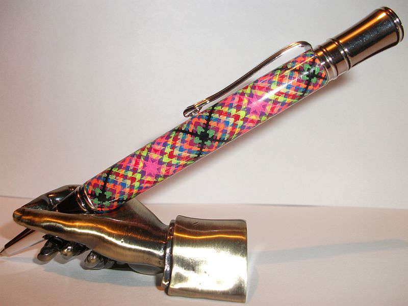

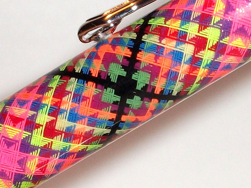

Hi everyone, This was my third try at this pattern over the years.My first try I was not using the proper type thread and had a mental breakdown when I applied the CA.The second went much better with the right supplies.It was an 8 color wrap. This time around I used 10 colors.Had to do a Mandala again because after some time away from doing a wrap I kept breaking threads halfway through three different patterns,I went back to what I knew.This time I didnot follow the predetermined layout and spaced it out on my own.

First off,thank you for the detailed feedback.I entered it in the segmenting contest because it was the only one the I could abide to all the rules with the kit I used.There is only thread and CA involved.The diameter of the wrap after all the thread is applied was about.400-.402 and the executive kit finished blank size is .410 so casting would have been wasteful of resin and that stuff is expensive.
I make the wrap about 5" long. The thread I used Is FUJI ULTRA POLY NOCP it requires no color preserver before coating but the colors are more matt than regular wrapping thread.Finishing technique was done with Thin Flex CA and Heptane accelerator,I use products from Rabid Models.to apply the CA I use blue painters folded over a few times smooth side out for an applicator.I pool a large puddle on the applicator and slather in on with the lathe running 750rpm,slowest it will go.Starting in the center and working it back and forth,If I dont keep it moving the CA will fling right off.After about a minute of spreading the CA it stabilizes enough that I can let the blank spin and give it a shot of accelerator back and forth once,Then I let that cure out for a couple hours with the lathe running.It's thick so it takes awhile.I repeated that process tilee the diameter was about .450-.460.The CA does not lay down super smooth and this gives me enough to cut it back down with the skew to about .425.
Sanding from there is pretty straight forward 400-2500 checking the dia as I go. once I get it down to .411 I buff it with a med buff and Dico plastic buffing compound.Assemble after that then give the entire pen a coat of ren wax and it was done.There was a tiny bit of cloth lint trapped by the clip which I didnot see till after I posted it( sorry about that).
