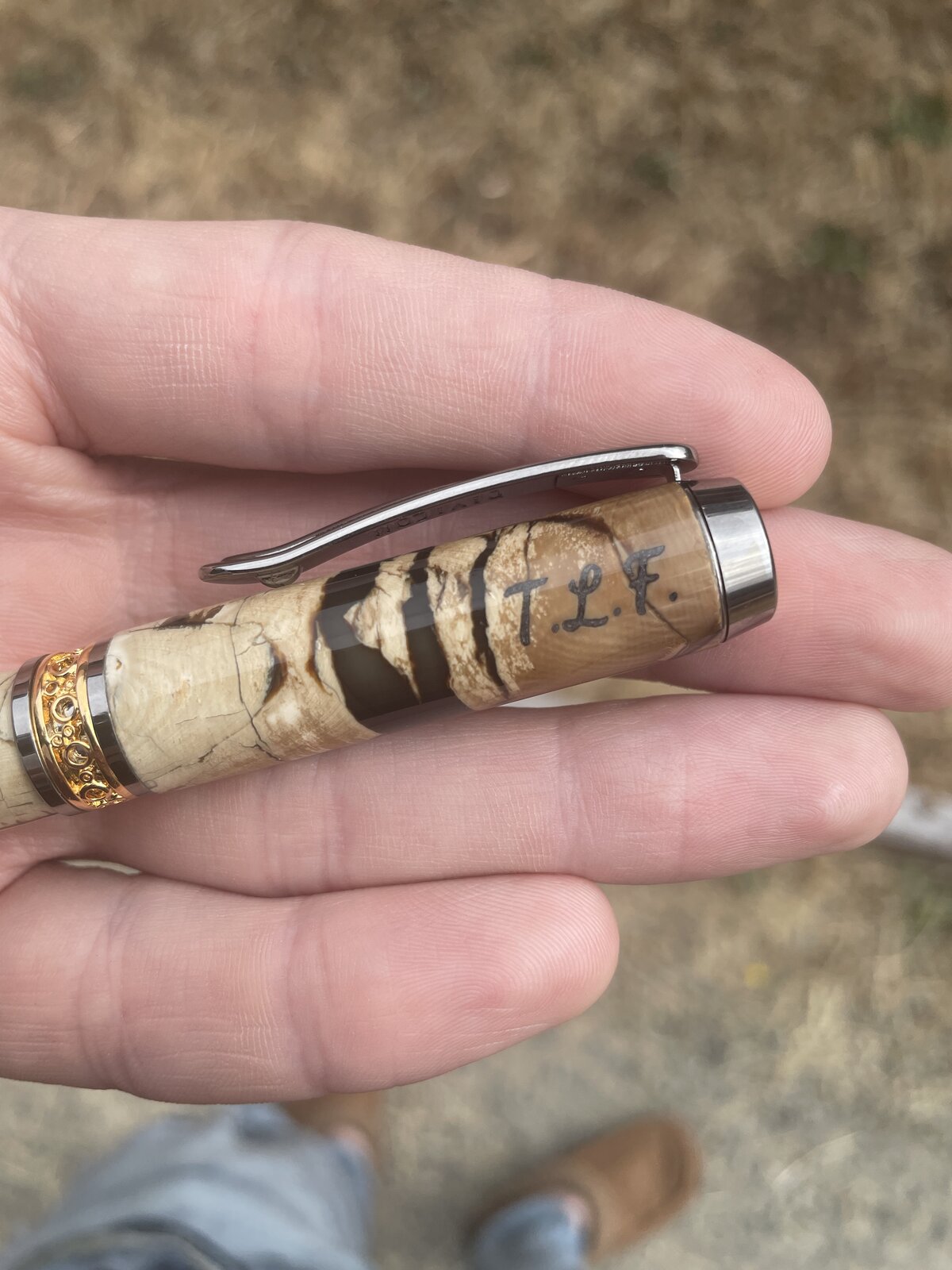

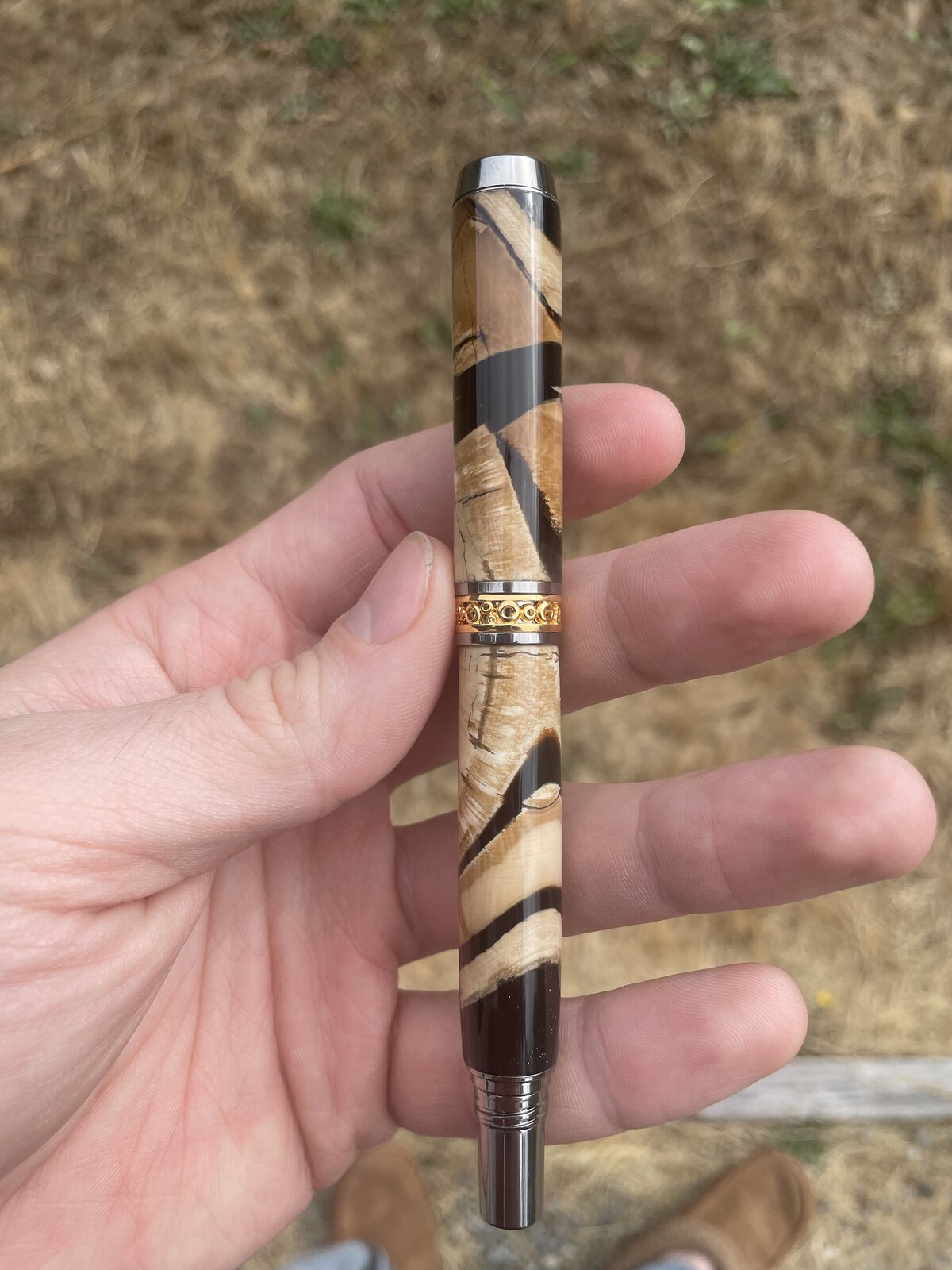

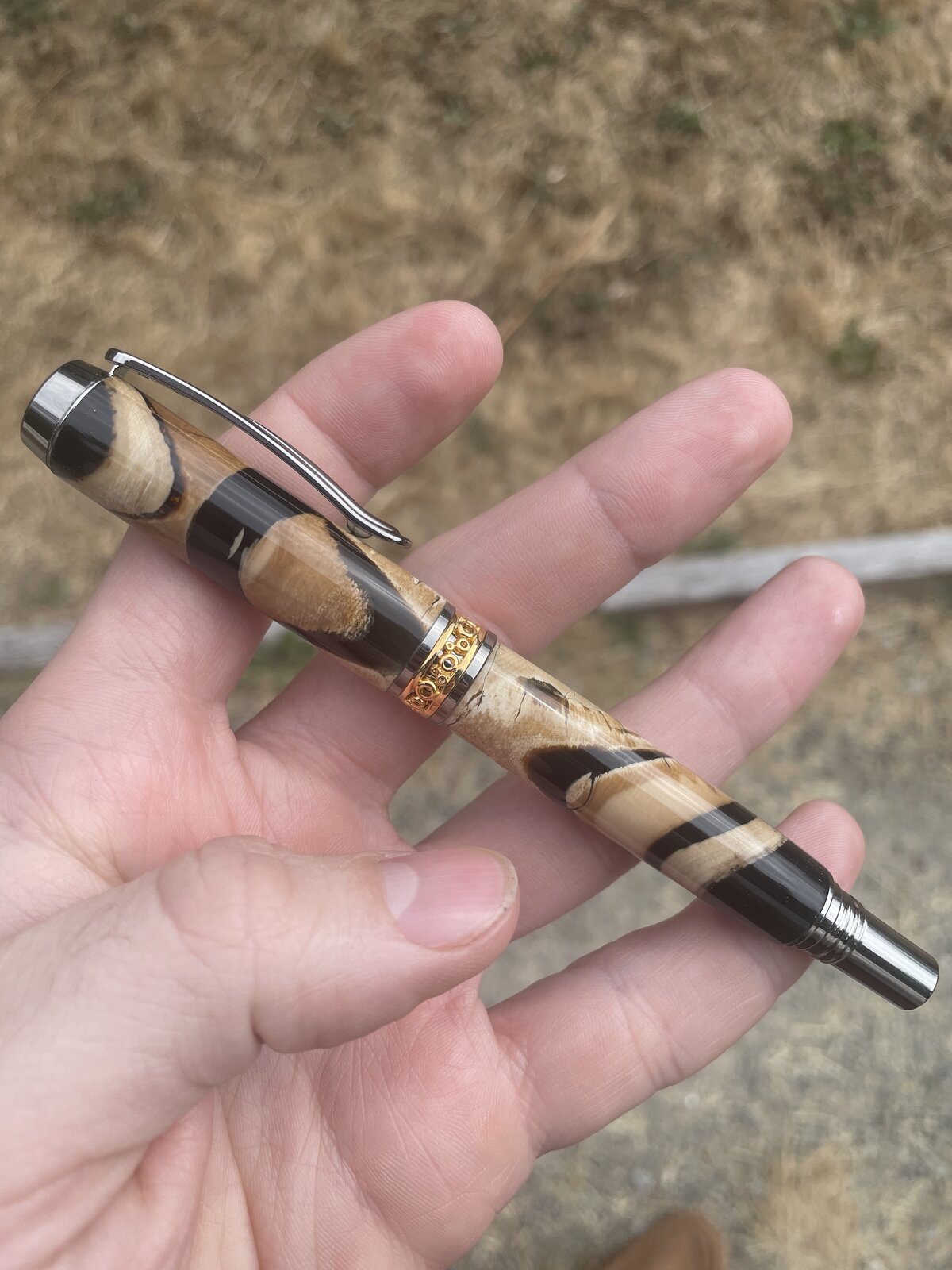

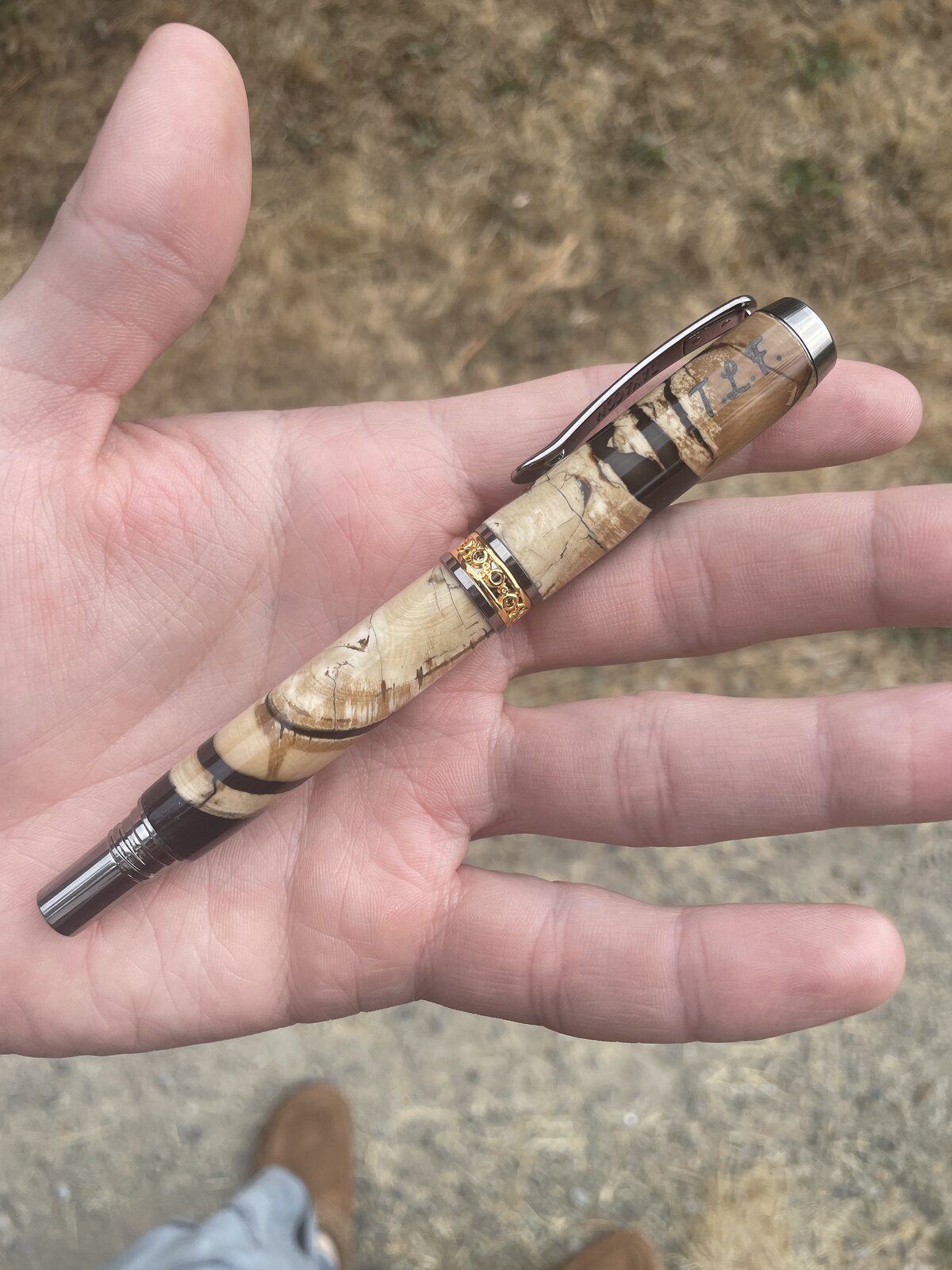

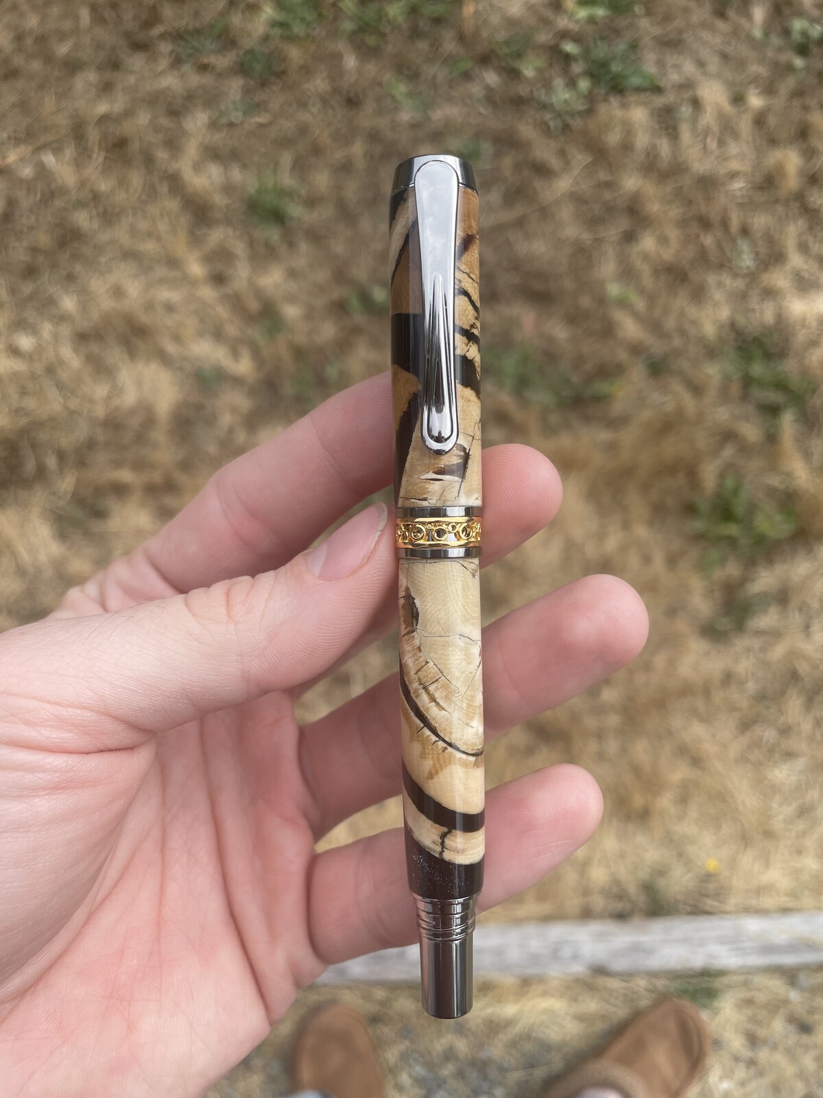

This is a rollerball I just finished for a good friend of mine. He helped me out in a big way and I wanted to make him something special as a thank you.
Its wooly mammoth tusk cast in black resin.

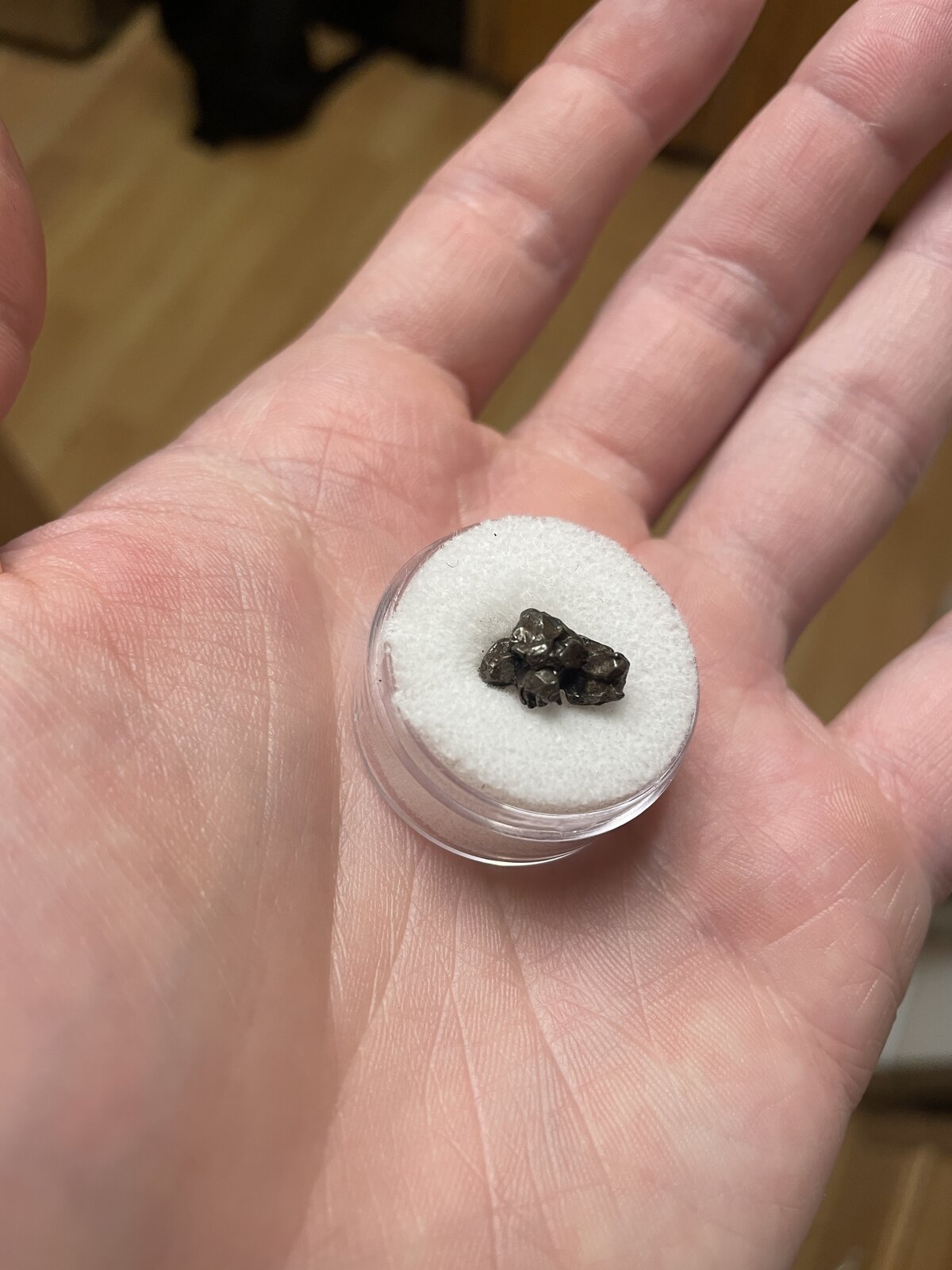

The engraving is filled with dust that I filed off of a (VERY hard) Gibeon meteorite. Filing enough powder to fill the engraved initials from this little 1/2 meteorite took at least an hour.
The kit is a Jr. Anthony.
