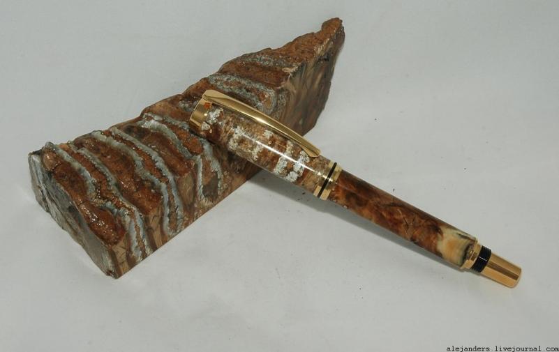

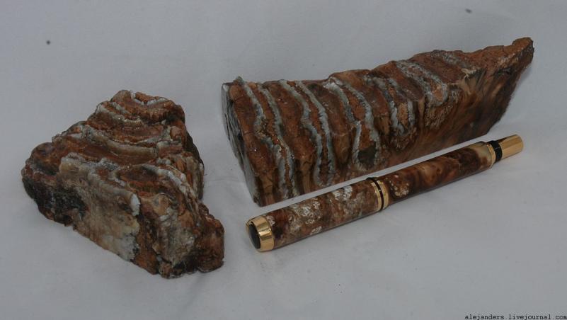

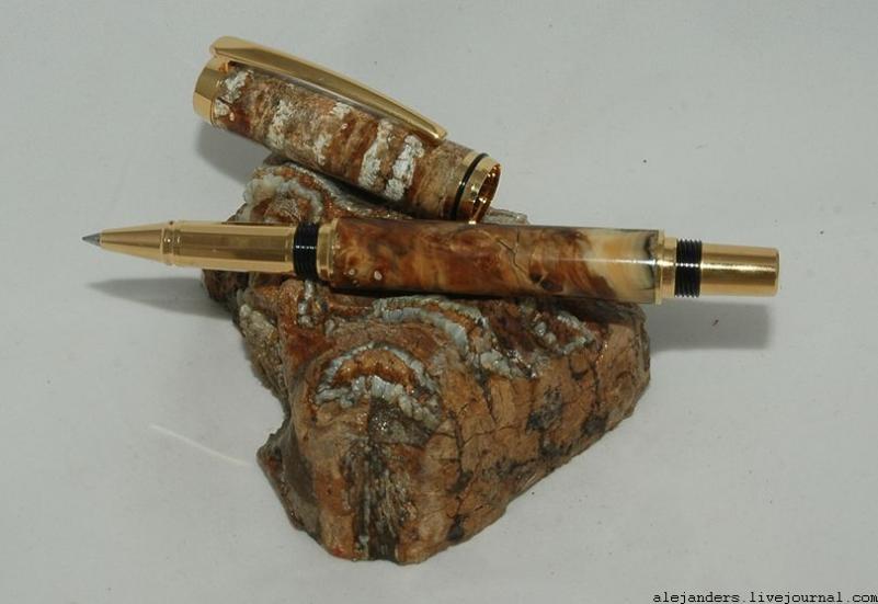

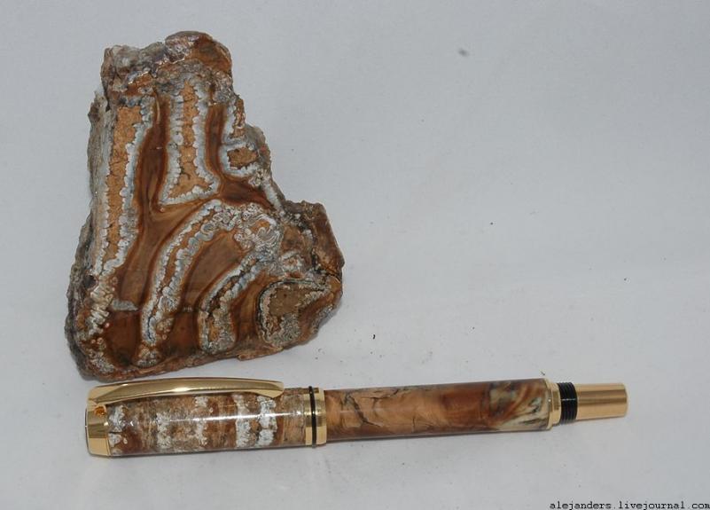

Friends, I want show somehting that you have never seen before.
It is a pen from mammoth tusk (molar).

maxman400, sorry I thought my pen is first here.
It seems that "my" tooth is in better condition, that is why enamel and dentine is much more contrast.
But regardless of that, tooth is VERY brittle and chips out very easily.
I spent three hours to make one blank. And it was read headache to drill it. Drill bit grows blunt very fast and overheaten it. Blank cracked few times and I secured it with rag soaked with CA.
And turning... Was real torture. But I love result. At last it is better then Montblanс. :)
No worries about that. LOL When I did mine I Glued wood strips on all four sides of the blank and after cutting it to tube size I capped the ends with wood also. I started drilling with a 1/4" bit and progressed 1/64" at a time until I reached my tube size. :smile:
mikespenturningz, tooth is much more hard and brittle then antler. HSS chisel dulls very fast, so you may use carbide chisel or sandpaper.

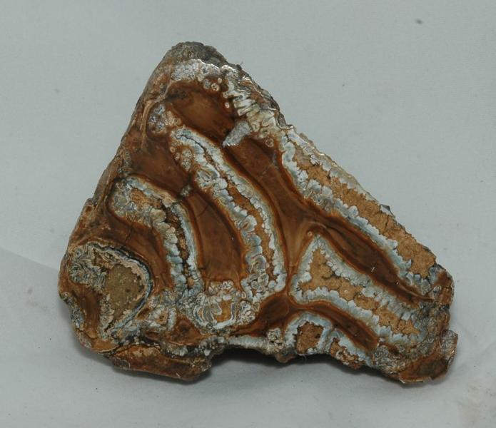

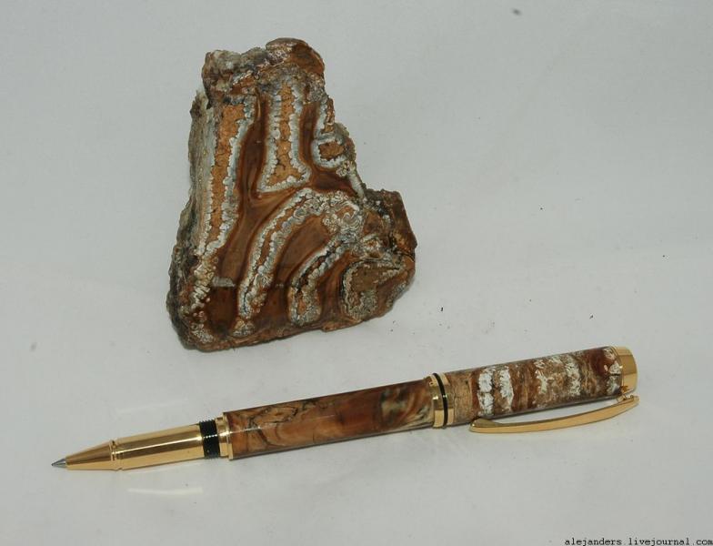

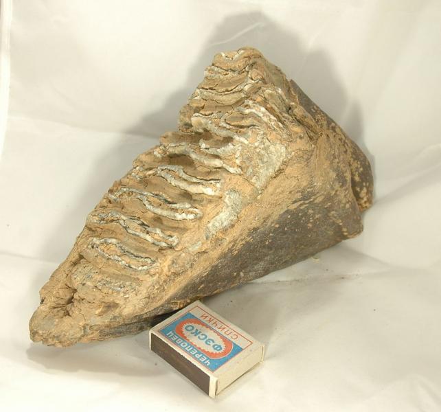

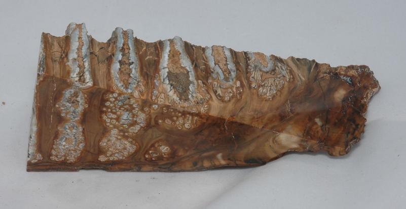

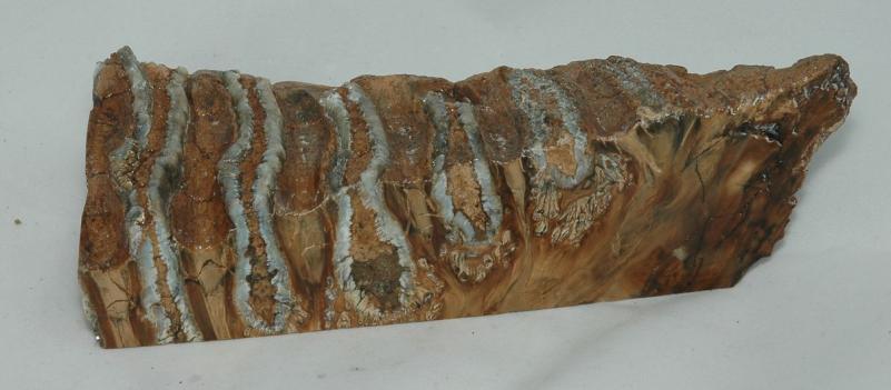

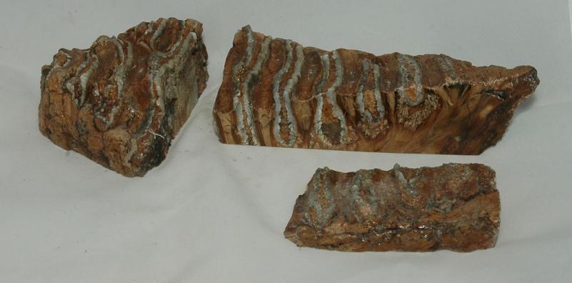

Mammoth tusk consist of dentine mainly with no enamel.
But one tooth (mammoth had 4 teeth totally) consists from enamel scales with dentine inside and between.
Look at photos bellow. It is unprocessed tooth and its upper layer pieces after polishing.
