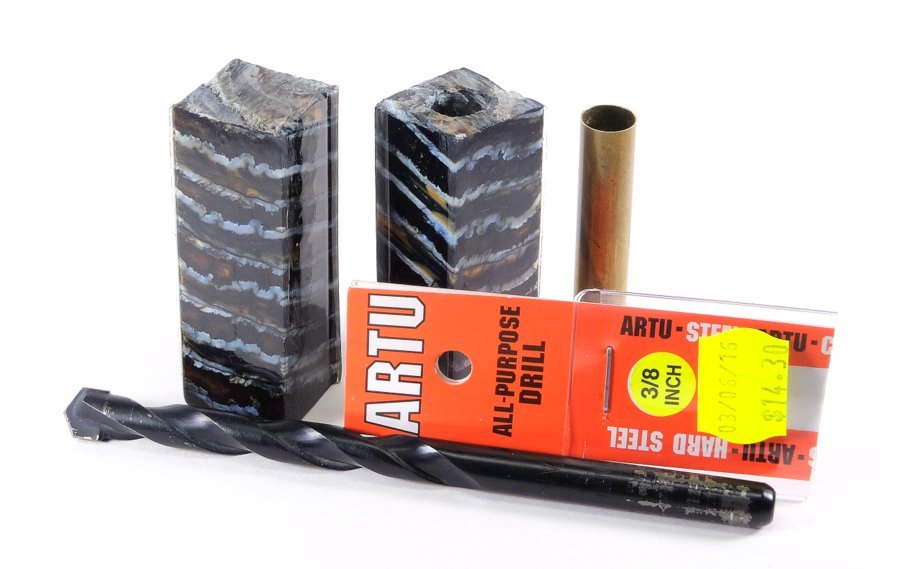

I just rang Scotty Bulpitt on his home phone number from Australia being 1 519 741 0616. Yes he has them priced from 80 dollars. The one I bought cost 80 dollars and Cobalt blue banded (beaut colour). 5X1X1.
From Canberra Australia I used 001115197410616. He is a great bloke.
Kind regards Peter Hay.
PenPal
Nov 29, 2006
2,708
Canberra, A.C.T., Australia.
This is the drill available in so many countries,cut the blank into two using a cheap 3 wheeler bandsaw with a metal cutting blade. Drilled size for this brass then used accurate metal drill to finish the hole. Turned using the Easy Cutter 4 way (one cutter) to turn the pen,every time I blunted the four faces I placed it face down on a diamond plate,few rubs ready to go. Took me hrs to turn.
