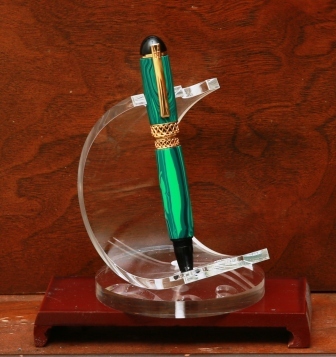

I also have trouble when drilling with large diameter bits, sometimes acrylics get too hot and actually warp in the pen blank press. I will try 7 mm pilot holes also. Go slow and be patient. And I have slowed the drill press down; but, may slow more. Here is an Apollo Infinity in malachite that my wife made.
