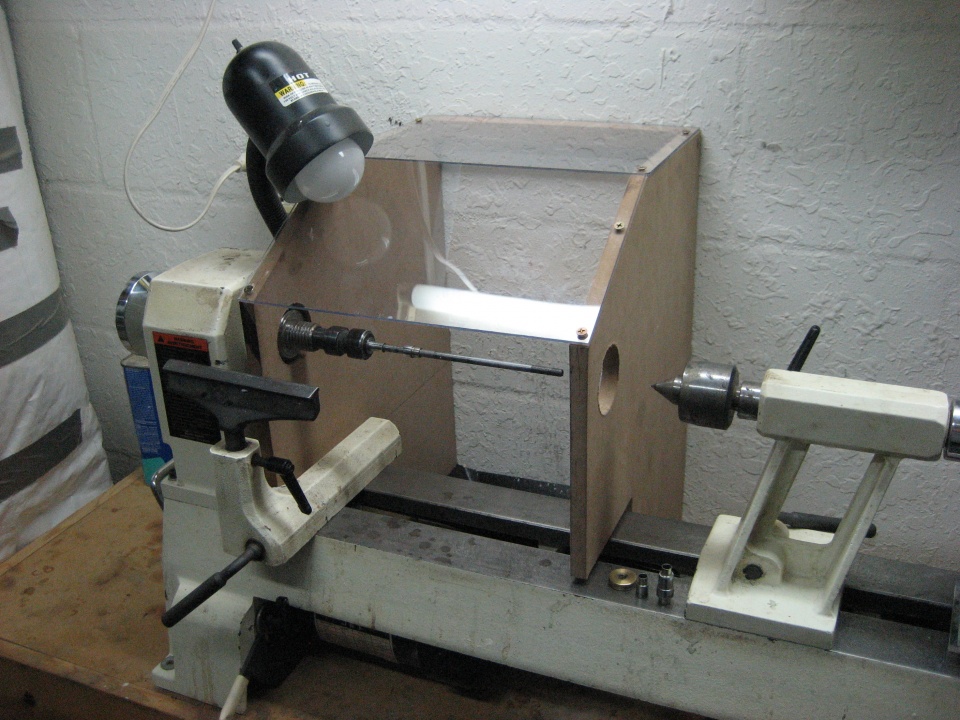

First, I'm aparently allergic to the dust and shavings of turnings. Not quite sure yet what I'm allergic to, but I was forced to add a pretty restrictive dust hood hooked up to a 2HP dust collector to remove the dust and wear long sleve shirts. The dust hood works great, but it does limit how close I can move the tail stock to the head stock. I could cut out the dust hood a bit to allow the tail stock to move closer, but I'm afraid that would reduce the effectiveness of the dust removal and I'd be back to itching like crazy again.

I think your best move is to fabricate a dust hood in light of turning between centers. I started a thread on dust collection awhile back and a couple people shared nice boxes they made that should suit your needs.
You're probably right about the extended bushings Dan. Most likely wouldn't be any better than a mandrel. I still would like to make my own normal sized hardened bushings. I still would like to know what metal to use.
This is the dust hood I made:
You're probably right about the extended bushings Dan. Most likely wouldn't be any better than a mandrel. I still would like to make my own normal sized hardened bushings. I still would like to know what metal to use. This is the dust hood I made:
Nice box. You could maybe make another with shorter plexiglass.
Probably easier said than done though
