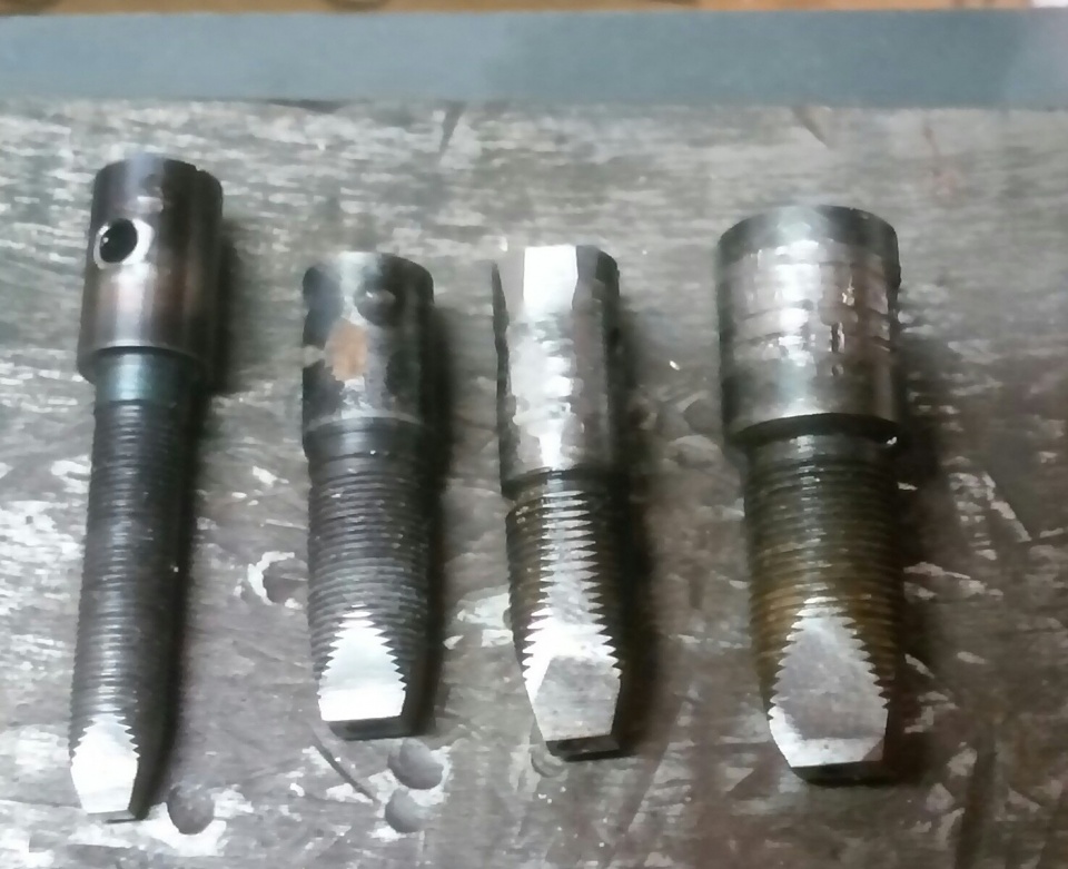

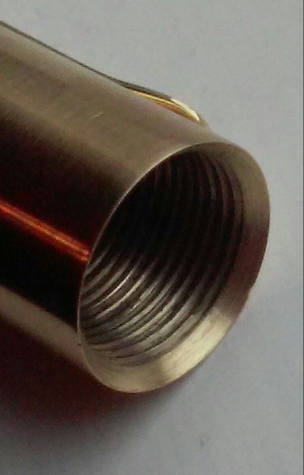

I needed a tap for a Bock 5 mm triple nib unit and didn't want to spend $40-$50. So I chucked up some 3/8" drill rod (W1) and turned it down to 0.253" and cut threads at a 0.6 metric pitch. Heated with a MAPP torch until it was no longer magnetic and quenched in water. I then ground a taper on the tip every 90 degrees. Works great in aluminum, brass, 304 SS, acrylic, and ebonite. Worked so well I made 8.5mm x 0.6, 9mm x 0.75, and 11mm x 0.75. Those worked for aluminum and brass but struggled in the 304 SS. Also much stronger than traditional taps with most of the cross-section milled away.

If you look close at the ground end you see partial threads progressively getting deeper. These actually cut the material forming chips. Because it doesn't have the deep grooves you normally see in a tap you have to be careful when tapping blind holes without room for the chips. An advantage is your aren't likely to break one with the greater cross section.

Sorry I left the wrong impression, the drill rod isn't magnetic. Tool steel will stick to a magnet when cool. When it has been heated high enough it will not stick to a magnet. The crystalline structure has changed. At or above this temperature if you quickly quench the steel it will harden. It's a poor boys way of heat treating tool steels. After quenching a file should skate across the rod without biting in. Do this after threading and before grinding the tip.
