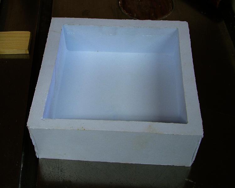

I checked the mold this afternoon and it looked pretty good. Took it out of the wood form without any problems at all. It appears that the silicone had firmed up completely within a 24-hour period. I found no uncured silicone remaining.
Have attached some pictures of the resulting mold and think it came out quite nice considering it was my first attempt at such a thing. I can see some areas that the silicone did not get down into but none of them will impact making a block PR casting. You can see the wrinkling from the poly-wrap I used to cover the mold form.
My next attempt will be to apply a shellac base to the forms so I don't have to use the poly-wrap. Will also pay closer attention to filling the voids in the mold so I don't have any pockets.
Otherwise, I am very happy with the results I got.

I didn't mix my RTV silicone with water but I think it will be the same, when filling the mould make sure to push down by hand the silicone, as for the wrinkles try to put the smooth part up and the fold saran against the mould, don't forget the smooth part is the bottom of your mould, to make the saran to stick easy on to the master ( wood or anything else ) you can spray with oil and the saran will be without wrinkles, I don't know the thickness of the out side wall but mine are 16mm or 0.630".
Again well done

Bleh. Nothing got the wrinkles out of my plastic wrap. I tried the hair drier, a real heat gun, stretching and pulling, nada.
Oh, well. The sillycone is curing. We'll see...
Part of the job is getting rid of as many of the wrinkles as you can .. BEFORE putting
the sillycone in the mold. Maybe wrapping each piece of wood in plastic before assembly?
That would allow you to shrink the wrap with heat and not pull at the mold? Dunno.

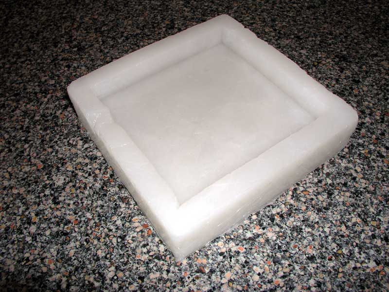

I just finished one without the plastic wrap and it came out better. Wax and buff the
wood that will touch the silicone and it comes out easily.
Of course, it wasn't caulking, but it should work the same if the
caulking is pliable enough.
